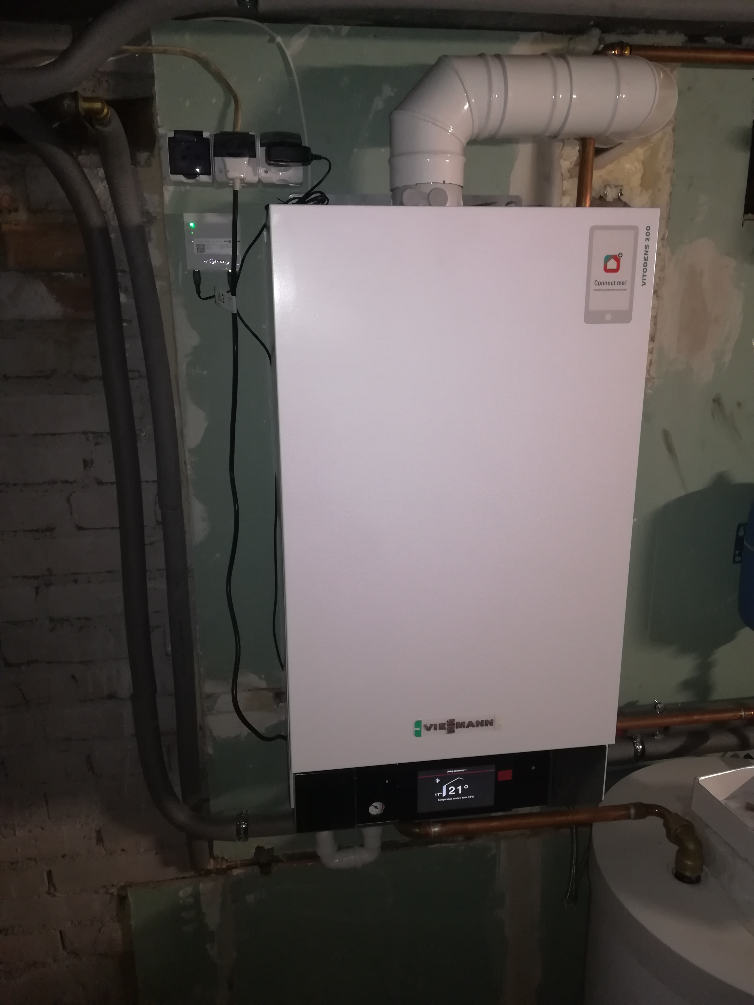

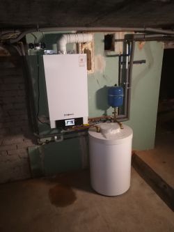

    Hello. I have since August VIESSMANN vitodens 200-in 19kw. I have a house of 120 m2. At the moment I'm happy. I came from the so-called Circadian furnace. PLN 90 for September. October 190 PLN. I remind you that the weather is in the range of 0.5 - 12 degrees C. So the stove heats the apartment every day. I have a weather system. There are radiators in the house, not a floor heating system. House from the 80s. Insulated. If you have questions, I am available ... ?
