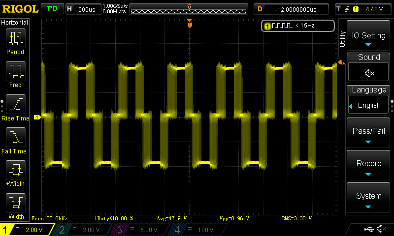

    After checking with an oscilloscope what is happening at the output of the amplifier in the absence of a signal, it was explained why there is low noise in the speakers. A waveform with a frequency of several hundred kHz is visible.
    Class D amplifier module test PAM8403 5V 2x3W - hit or kit?
    We feed the input of the amplifier with a sinusoidal signal 1kHz 100mVpp, the output is a modulated waveform of high frequency:
    Class D amplifier module test PAM8403 5V 2x3W - hit or kit? Class D amplifier module test PAM8403 5V 2x3W - hit or kit?
    Connecting a loudspeaker instead of a resistor changes the shape of the output waveform:
    The subject of audio is strange to me, but this is not how I imagined the operation of a high-efficiency amplifier. Does every class D amplifier produce such "chaff" at the output? Does PAM8403 work in class D?

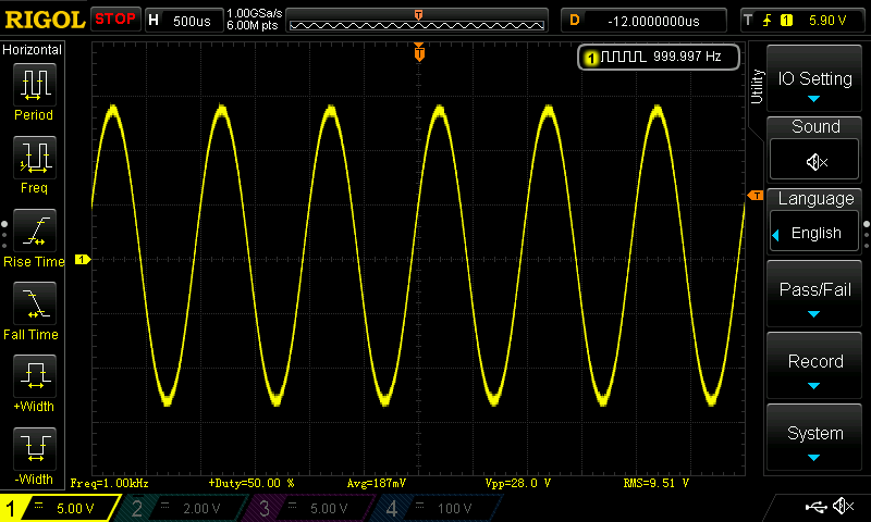

    The first attempt, the module with TDA8932, in the absence of an input signal, consumes 46mA invariably, regardless of whether the output is connected to a loudspeaker 8om or a resistor 8om or 4om. The inductances are visible on the PCB.
    Let's give the sine at the input and at the output we get the expected sine wave instead of the "chaff":
    The trial with TDA8932 brought me out of the shock of PAM8403 :)
    TDA8932 was powered by 15V, drawing 0.852A at an output voltage of 9.40V at a resistance of 8ohm (simulating a loudspeaker). 1kHz sine wave at the input.
    You can estimate the power supplied to the amplifier: ~ 12.78W, the output is ~ 11.05W i.e. efficiency ~ 86% .

    The big difference is that there is no output filter on the PAM board. At first glance, you can see that the TDA has chokes and filtering capacitors, and the PAM has the pins of the IC connected directly. Without filtration, it is rather difficult not to see and hear this light chaff ;) If the TDA filters were shaved off, it would probably not be crazy ;)

    I also have 2 of these modules. And after the first connection, I saw 100khz chaff on the oscilloscope ... I didn't have as much patience as you did to analyze it deeper.
    Generally, these modules are not designed for listening to music, given their ridiculous price and small size, they can be a great solution for devices such as:

    It seems to me that the speaker inductance plays the role of the filter. This would explain the noise at the output without a signal, and the increased current draw after replacing the loudspeaker with a resistor.
    This is an amplifier (in class D, but ... simply simple to the point of absurdity) of low power, for typically "portable" applications, and in such speaker sets the speakers themselves have the quality ... let's say "average". So there is no point in expecting some super-quality, perfect lack of noise (clock frequency) on the output, etc. This is supposed to work and additionally be cheap and economical in power consumption. And is...
    PS A similar "chaff" can also be observed in the speaker outputs of amplifiers from some cheaper (but not only ...) towers with D amplifiers. Maybe a bit lower amplitude (because the manufacturer adds some simple filters for the outputs), but still.
