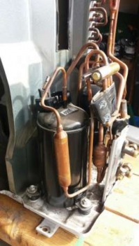

    What if I used a compressor from a normal air conditioner? for example:

  • #4 16629424
    SKM 1964
    Posts: 2191
    Help: 150
    Rate: 660
    You will get something out of this, the compressor is concrete. If he can and will, he can cool the room. But you have to play with it as you know what to do, how it should be. Worse as it will not work properly. Will you lose the used current, not to mention the cooling factor ?? :|

    Well, I bought this compressor for a ridiculous amount of 250 PLN with shipment ;) will come and put the whole thing together :) . And as for the factor just for the proverbial colleague who deals with air conditioning will give me a deal. I will add photos from all construction pozdr.

    Remember that you can not use accidental gas for a given compressor, you must check on the compressor for which gas you can use it.
  • #8 16630290
    Strumien swiadomosci swia
    Posts: 27581
    Help: 1405
    Rate: 6430
    None of this will come out because the compressor is not on r134 and randomly selected elements. If this is the case, we install the entire air-conditioning system from one car or a 230V mains conditioner. Anyway, now the air conditioners are so cheap that it is not worth the DIY to do. Secondly, how does the expansion valve, how do you connect aluminum with copper, do you have more than 0 concepts of factor conversion, system lubrication and temperatures? Now, a lot of people are assembling splits and for 3-4 ounces you can buy a functional air conditioner with a spiro tube for performance like it has to be, not this scrap of scrap.
