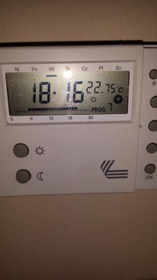

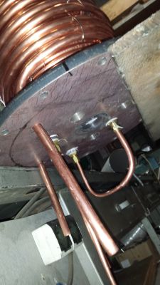

    I made two heat pumps from air conditioners; one for water heating - a copper pipe exchanger in a 300l stainless steel boiler; the climate is Hitachi 3.5kW RAC-35WEC / RAK-35PEC; the second is a heat pump for CO from a 70l car gas cylinder; the coil is a copper pipe; air conditioning Daikin ATXB60CV1B / ARXB60CV1B; remote control; indoor unit temperature sensor changed from 10k to 22k for the boiler; for CO from 10k to 15k; in place of the engines of the indoor units, generators on the 555 were plugged in; I have air-conditioning convectors from the indoor units; in summer I was cooling the heat now; as for the sealing of the joints, there are copper compression fittings with inch or metric threads on sale; shops with pneumatics; I made a pipe exchanger from three pipe diameters, welded it, checked the tightness with nitrogen at 30 bar; took the longest allowable piping length for each air conditioner and immersed it in the liquid; I added the correct amount of refrigerant (calculated from the volume of the pipeline and the indoor unit); he has been taking the exam since February; hot water is about 3-5kWh a day, sometimes even less; CO depending on the outside temperature; in the CO exchanger I also have a 3f 6kW heater for large frosts; I control 3 heaters depending on the temperature on cheap W1209 thermostats from a well-known auction site; 9kW solar panel on the roof; the heater was turned on in March to support the climate in severe frosts; consumption for March according to the application my meter 786kWh; now will be test all winter because I put it all on in February; I suggest looking for similar topics on this forum; there are photos and diagrams;
  • #21 17472405
    janek1815
    Posts: 4513
    Help: 372
    Rate: 1062
    Can you describe this PC to CO. Any pics?
  • #22 17472466
    kikis1
    Posts: 30
    Rate: 7
    a gas cylinder exchanger, specifically that of a forklift; cut-off bottom and in its place a welded flange connection DN 300; a copper heat exchanger is made on the flange of this joint; It consists of 15m of pipe fi 15, 20m of fi 12 and 25m of fi 8; ends brought to the flange and hard soldered; the beginning and end of the pipes are connected to the outdoor unit; charged with the refrigerant r 410a;
    1 inch threaded connections for CO supply and return are made on the cylinder; in the middle of the flange, a 6kW heater is installed in the muff, a pump with controls and sensors is installed; it is a 70l CO buffer from which water is fed to the heaters; I did not post photos but tomorrow I will try to add;

    Rate: 526
    If all these pipes form a condenser, then several siphons were created in which the condensed liquid will collect, thus limiting the exchange surface. The pipes had to be wound in such a way that all the liquid that would be condensed could flow freely and by gravity from the exchanger.
    As it is now, one is a waste of copper, two is a waste of a factor, 3 is a waste of electricity.

  • #27 17473723
    kikis1
    Posts: 30
    Rate: 7
    I put photos for Janek1815; there will be no photos of the exchanger because it is wrapped in 15cm wool, just like the 300l boiler; Feasibility of Converting Inverter AC to Air/Water Heat Pump with Water Exchanger Feasibility of Converting Inverter AC to Air/Water Heat Pump with Water Exchanger Feasibility of Converting Inverter AC to Air/Water Heat Pump with Water Exchanger Feasibility of Converting Inverter AC to Air/Water Heat Pump with Water Exchanger Feasibility of Converting Inverter AC to Air/Water Heat Pump with Water Exchanger
    41.5 is the inlet gas temperature, 29.7 is the condenser outlet liquid temperature; buffer temp is 31.3; on the remote control set temperature 18st.
    Added after 22 [minutes]:
    unfortunately I will not measure the condensation pressure; temp difference input buffer output is now 1.6st;
    the coil is rolled up to fit into the buffer; in a large tank, just like the 300l DHW tank, I have it rolled up differently; this condenser will work; the department in severe frosts, I did not fire the eco-pea stove from the moment the system was started; even if you say there are any losses, I have 7800kWh in my warehouse to use;
