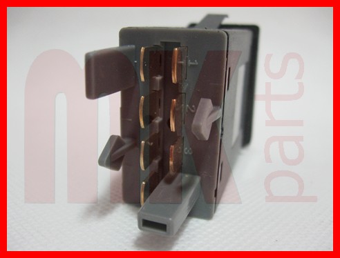

How does the turn signal relay interrupt the voltage if the switch supplies constant voltage to its control circuit?
It is not the switch itself that interrupts the voltage; an electronic timer circuit in the flasher unit powers the relay coil and switches it on and off to create the blinking [#16630205] In the A4/A6 unit, the interrupter was described as using two relays and an integrated circuit, with a different flashing time for the turn signals and the hazard lights [#16630378] The module is powered all the time and only starts working when the selected turn side or the emergency button/load is chosen [#16630204]

    Hello, gentlemen. I have a question. How is the turn signal relay interrupting the voltage? The turn signal switch gives constant voltage to the control circuit of the relay so what interrupts it? Thanks in advance for your response; D; D

    hmm. The relay is powered all the time, but it is only when it "feels" the load (by choosing the control handle which side should flash or pressing the "emergency" button) to start working.

    It is interrupted by an electronic timer circuit that powers the relay coil.

    The handle contains the light bulbs with the chopper and the one under the load begins to interrupt. Yes, chops. As for emergency DC power supply with 6 bulbs. As in the direction after the ignition of 3.

    I'm just interested in this electronic time circuit. Someone has a pattern? How it works I would like to delve a little bit. ; D

    Schemes are many, however, typical a4 I did not find. As far as I remember, the A4 / A6 interrupter has two relays and an integrated circuit which gives a different interruption time for direction indicators and emergency (emergency blinks slightly faster).

    Diagram of the chopper board in the VW Passat B5 FL
