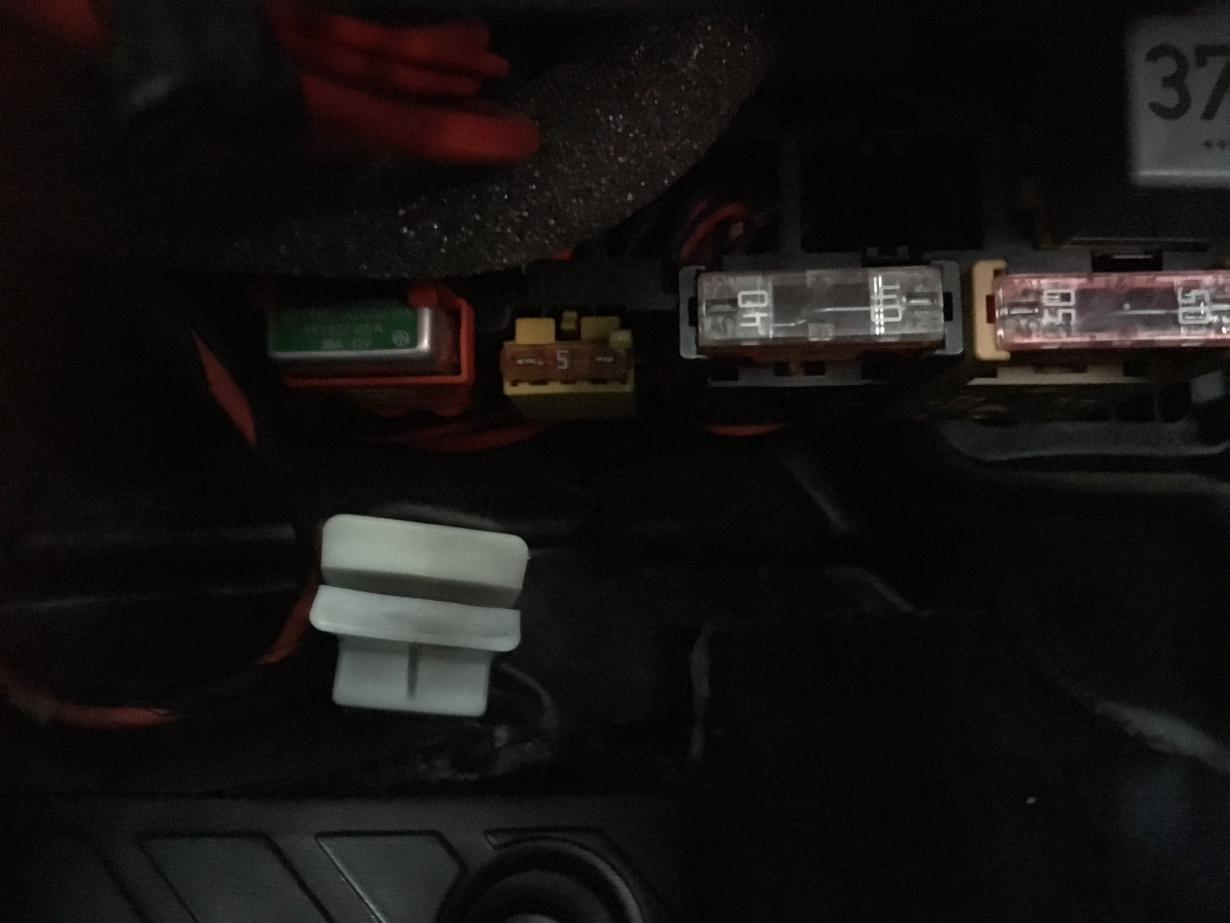

    Hello everyone
    In passat b5 2003, the turn signal light stopped blinking when closing and opening the vehicle. The central locking with the remote control works but the directions do not blink.
    The fault appeared when the turn signal fuse blown.
    Will anyone help locate the fault?

  • #9 16378409
    orion85
    Posts: 110
    Rate: 71
    welcome back
    I located the relay ticking after opening and closing the door. Under the driver's side of the carpet there is a black box with the central unit inside
    The fuse next to the pedals deep inside is good
    Directions are still not lit.

  • #10 16379795
    OSAAA1
    Posts: 56
    Help: 15
    Rate: 88
    For me over this 5A fuse there are several relays with the designation 373. And above these relays there is a 15A fuse (blue). It is very difficult to see. I was specially checked.
  • #11 16380516
    grala1
    VAG group specialist
    Posts: 9823
    Help: 1495
    Rate: 5052
    This box under the driver's seat is a comfort module.
    It should come with a signal for the direction indicators - black and white and black and green, 15-pin plug, pins 14 and 13. Exactly the same colors as with the direction indicator bulbs.
    See if there is a plus on them for a while after closing / opening the car. You can even give it there for a moment.
    In Passat rotting the cable connections on the floor and comfort likes to swim.
    If the fuse went down, I would look into the module, maybe the path on the board has burned out.

    And no one has changed the coding there? If I remember correctly, when the module will not see any of the lock switches, the direction indicators will not blink.
  • #13 16381054
    grala1
    Posts: 9823
    Help: 1495
    Rate: 5052
    Chris, there is nothing to coding there. The confirmation of directions is set in the adaptation channels.
    As for these castles is a good point. This can be recognized by whether there is locking. If comfort cannot see any of the signals from the locks, it will not blink. As when closing it is heard that it does not bolt it does not flash but I do not remember that it happened when opening.
    In this year you have a comfort module with "CAN" support and there you can clearly see in the measuring blocks even when the ignition is off, whether each door is closed or each lock is locked.
    A look at these blocks would be very helpful here.
