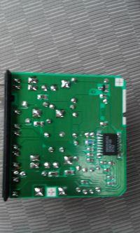

    The capacitor in the relay should be replaced or an old relay should be installed. I would check the wiper motor (contacts for support and end position) as suggested by colleague Decybel 91.

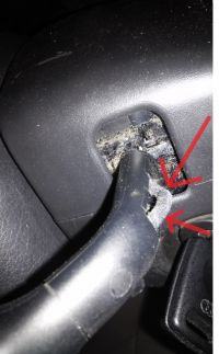

  • Checking wiper motor from steering wheel shelf and ECU link

    The problem with windshield wipers is so suddenly, did you fix something? It may be the fault of the control handle not this type (rear wiper). There may be a different pin configuration (my flush).
  • Suspected rear window switch or relay fault

    Rear wiper lever turned off to the starting position? .The rear engine has a electronics shield that you are talking about.
  • Asking whether the rear wiper uses contacts or electronics

  • #13 16511684
The discussion revolves around an issue with the windshield wipers of an Audi A4 B5, which activate erratically after the ignition key is turned. The user describes the wipers starting immediately, moving unpredictably, and sometimes returning to the correct position. Initial thoughts suggested a faulty wiper motor, but further investigation pointed towards the wiper relay module (part 377) under the steering wheel. Attempts to clean contacts and replace the module did not resolve the issue. Responses from other users indicated that the problem could stem from a damaged capacitor in the relay module or issues with the wiper motor's limit switch. Ultimately, it was determined that the limit switch in the motor was the culprit, leading to a successful resolution after its replacement.
