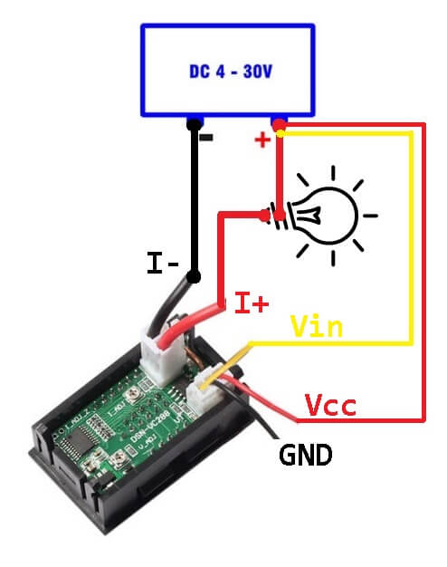

    Hi, I have a problem.
    I converted the old power supply from a computer, I wanted to build a power supply on which I can set the voltage / current, I bought a buck boost converter in one, I connected the 12V power supply to it and connected a digital LED voltmeter ammeter
    3.1.18. Do not send links that will cease to be active after some time. This will make the discussion meaningless.
    [retrofood]
    everything is ok, I can change the voltage by turning the potentiometer, but I can't change the intensity, it shows 0.00A all the time
    I am adding a diagram of how I connected everything and I would be grateful for any help

    To measure it (current value) you have to connect in series, i.e. you cut the cable and connect with one end of the ammeter to one part of the cable and with the other end of the ammeter to the other end of the cut cable. Of course, you must have some load connected because the current flows in a closed circuit ;) .

    Except that when I hook up, for example, a led module to the output, I can normally change the voltage that is sent to the diode, but the current is still 0: /

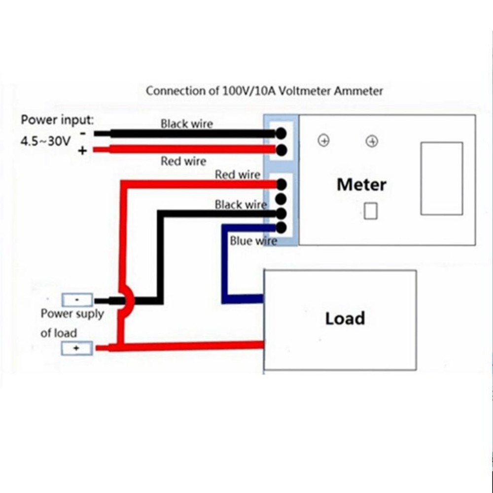

    Is it so hard to check the scheme provided by the sellers?
    How to connect a digital LED ammeter / voltmeter to the power supply How to connect a digital LED ammeter / voltmeter to the power supply

    I have other cables in my own, I do not have yellow, but blue, and I have it plugged in, as recommended by the seller How to connect a digital LED ammeter / voltmeter to the power supply
    unfortunately, it does not do anything, it only measures the voltage

    So what if the color is different, but the outputs are the same.
    Why don't you connect as the seller gave you?

    I have it connected as in the diagram above and nothing

    I have it exactly like this How to connect a digital LED ammeter / voltmeter to the power supply
    Freddy the connection you suggested is wrong, regardless of the color of the wire (yellow or blue), this wire is the output power supply (-) current consumption measurement is measured at negative voltage (shunt between - black input and - yellow output).
    The connection shown by col. sofles is correct. Reading the current consumption, as someone has already mentioned above, is possible only after connecting a receiver. This module is quite resistant in the case of low currents (fault of the automation).

    gumisie wrote:
    Freddy, the connection you suggested is wrong
    Since you are sure, I apologize, but it is an image provided by the seller and on the website :) . I still have one.

    Freddy wrote:
    If you're sure then I'm sorry
    100%, I use this type of panels because of the fairly affordable price. I have just unscrewed the power supply to make sure.
    Regards.

    @ Freddy no one excludes that you are right, the connection issue may arise from the model of this panel. I referred to the YB27VA.

    My panel is DSN-VC288, but 99% is one and the same.
    The problem is that the author, when asked to remove his layout, inserts a diagram, as if he was ashamed of editing :) .

    @sofles, Due to the fact that in the network you can actually find various solutions and it is difficult to find out which is the right one and to which panel they can be used, so in my opinion you can check it by measuring the resistance between the blue and black or red wire.

    #20 19254449
    Fi_eng
    Hope you have already solved this but there are many different types of devices. Some have 3 thin wires in one connector: red, black and yellow and two thick wires of red and black. Another type like yours has 3 thick wires in one connector, red, black and blue. That's why in this discussion there is so much confusion. I dropped to this discussion when trying to find proper documentation for these meters like some value of shunt resistor of ampmeter but no success. Just have to calibrate with more accurate device :(
    3 Thin wires + 2 Thick wires
    Red meter operating voltage +
    Black meter operating voltage -
    Yellow voltage sense - high impedance input
    2 Thick wires
    Black ampmeter negative -
    Red ampmeter positive + (from load)
    2 Thin wires + 3 Thick wires
    3 Thick wires
    Blue ampmeter positive + (from load)
    Red voltage sense - high impedance input
    Your connection is correct, so must have problem inside device lice solder break of shunt wire? If you have solved your probem, please reply, it will help me :)
