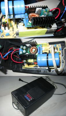

    So I put it together. The basis is the AC / DC 24V / 4A switching power supply. And then the converter in question.
    The measuring module is very similar, but a bit different - there, the power supply is on one plug (and it is connected directly to the AC / DC output, i.e. 24V), and the measurements on the other - 3-pin.
    Behind the power supply and an additional 1000?F / 63V capacitor at the input of the converter, both modules would not fall into some strange resonance. Although I am wondering if I would not put a tiny resistor in series, however, because a terribly high current goes to the capacitor when it is turned on.
    The power supply has aluminum heat sinks, which have also become a frame for the converter after using a piece of aluminum and a drill.
    Everything is closed in a fairly large housing, which was used by me for the current 14V / 1A + 5V / 1A transformer power supply (it broke down), hence the holes and scale on the front panel (going somewhere to get a clean panel?). All that's left is to desolder the potentiometers and mount them on the panel. At the beginning I was thinking about a multiturn, but what @ piterek-23 wrote convinced me and for voltage regulation I will use his idea on ordinary potentiometers. I will only use one for the electricity.
    Eventually I'll have a fast phone charger at home :) With this load of 5V / 0.9A, the whole thing is barely warm. However, I am saddened by the fact that the idle power consumption is as much as 2W (mainly the fault of the AC / DC module).
    PS. Measurement under load (with a laptop) - 20V / 1A (20W), power consumption 24W, i.e. the loss is approx. 4W. The instantaneous load jumped to 1.7A and holds 20.0-20.1V beautifully all the time (according to the digital meter). At 2A (40W) the voltage drops a bit (19.9V) and the current consumption is 47W. I do not have an oscilloscope at hand, but I will check the waveform in such conditions one day.
