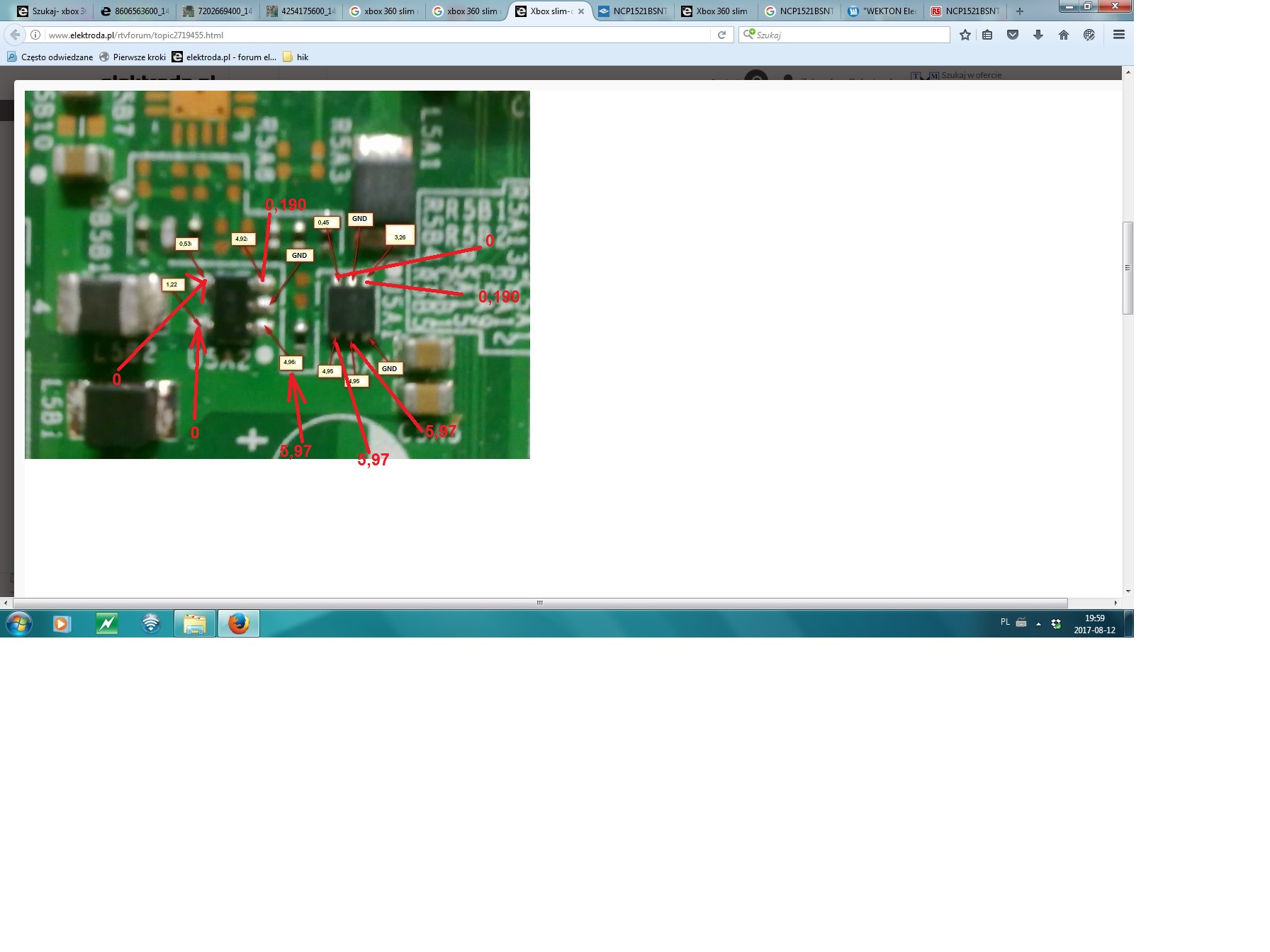

    Could I ask my esteemed colleagues for advice on repairing the Xbox 360 slim.
    The console does not work - no response, the indicator light on the front panel is off. I checked the power supply voltages (even checked on another console and everything works).
    I measured the voltages on U5A1 and U5A2 - measurements in the photo (red which
    I made, and next to them as they should be - I found on the electrode).
    So there is power at the input of the stabilizer, but none at the output. Are these two systems damaged?

    I did not find a short circuit at the output of the system. Can someone help where to get such a regulator?
    Thanks in advance.

    According to me, the bridge flew
