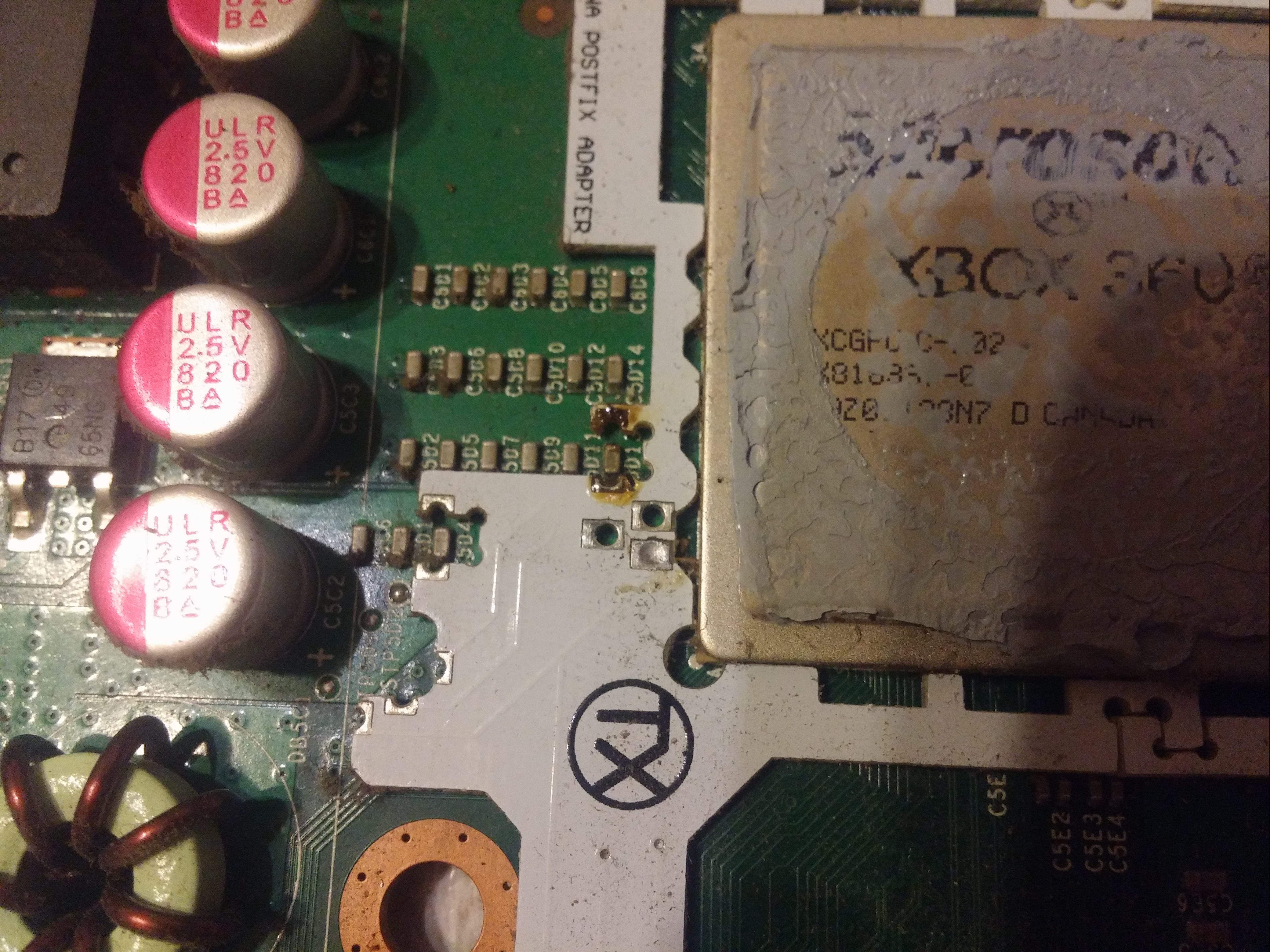

    Hello . I have an xbox 360 slim console. RGH. After a long time without use, I decided to plug it in and play in my spare time. A year has passed since the last use and after plugging in, the console worked great for the first two weeks. Problems started a few days ago. The console "stuttered" while playing, "froze in place". no reaction queues. After restarting the problem persists. Today, when you try to start the console, the fan starts, the power supply, etc., unfortunately, it does not start the dashboard. I know that the reworked rgh consoles take a little longer to start depending on the quality of the modification. Usually it started from the first kick or after 20 - 50 seconds. Unfortunately, at the moment it is trying to start without any results. I am asking for a parade where to look for the cause of the fault.
    • Xbox 360 Slim RGH Death: Freezing, Stuttering, Dashboard Not Starting - Troubleshooting Tips 20171111_212116.jpg (5.04 MB) You must be logged in to download this attachment.
    • Xbox 360 Slim RGH Death: Freezing, Stuttering, Dashboard Not Starting - Troubleshooting Tips 20171111_212314_HDR.jpg (5.01 MB) You must be logged in to download this attachment.

    Take clearer photos.
    There is a glut in the row of SMD capacitors. It is not visible whether it is a burnt element or a tin ball

    Ok will send clear pictures today. So far, the only thing I have established, or rather, are assumptions. smashed fsd on internal memory. after unfastening the disk, the console started after a long time, but on the original dashboard. I remember them once, rgh fired without a disk. From what I can see, the memory on which fsd was installed so far may have been damaged

    the glitcher diode blinks when you start the consoles
    try to start xella if you succeed, turn off the console and press the power buttton and after a second slide out the tray
