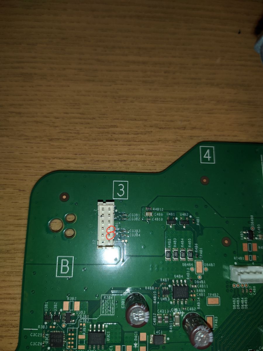

    I bought an occasional flooded Xbox One
    The console does not turn on, it is in the STANDBY mode all the time (orange LED on the power supply)
    From what I initially noticed, the 5v voltage is disappearing somewhere.
    Flooded Xbox One Console: Analyzing Standby Mode, Orange LED, Voltage Drop & Suspicious Resistors
    According to this diagram, wherever 5v should be, I have 0.4v. There is 5.2v correctly on the power socket.
    I have a couple of suspicious looking resistors in which when I check the resistance it keeps growing until the scale ends. on other similar resistors (is it a resistor at all?) I have a constant resistance.
    Flooded Xbox One Console: Analyzing Standby Mode, Orange LED, Voltage Drop & Suspicious Resistors Flooded Xbox One Console: Analyzing Standby Mode, Orange LED, Voltage Drop & Suspicious Resistors
    Any tips where to look? It is possible that what I call a resistor (marked in red in the pictures) is not one at all. I repair phones on a daily basis and for the first time I do something like that, so please bear with me ;)
  • #2 16506620
    Ba_rt
    Posts: 111
    Rate: 10
    Since you repair phones, you should know that the selected element is a regular capacitor :)
    Do you repair phones? By replacing the digitizer, battery, I guess ...
    No offense, you would tell a capacitor from a resistor I guess. Because what you selected is a capacitor, I would rather not bet on a flood-damaged one.
    You have a schematic of this Xbox? Because it's gonna be hard to find without where it goes.

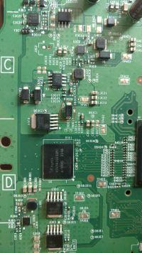

    So yes, I did a few more measurements and the 3.3v voltage is also dying and I found a place.
    Designation B2L RC40 (Diode?). 3.6v on the one hand, 0.4v on the other. Rises to 1.2v when heated, and drops to 0.4v when heated
  • #5 16506828
    Jawi_P
    Level 36  
    Posts: 3259
    Help: 260
    Rate: 715
    looks like a schotky led
  • #6 16506845
    rimot
    Posts: 1054
    Help: 145
    Rate: 146
    After all, there is a clear symbol next to it. Diode. Do not heat up, just desolder and measure. @Jawi_P clearly wrote: SCHEME.

  • #9 16506929
    Momos1
    Posts: 15
    If I wanted to, I would take it to the site, but that's not the point.
    Mosfet SI4501BDY died (no 5v voltage at the outputs, the input is as it should be) and the diodes are BAT54HT1G. Diodes are available in Poland, worse with mosfet ... only on aliexpress.

  • #15 16507399
    Momos1
    Posts: 15
    So I will. The console was flooded from underneath with orange juice :) which is like standing in a puddle. There must have been a short circuit on the other side of the plate because there are no signs of flooding at the top. I washed everything with isopropanol, I hope it will be ok. I will not start the console until all the voltages are in line with the standby. Later I will see what happens when the power supply releases the + 12v lines if it ever happens ;)
  • #16 18693612
    wicu49
    Posts: 110
    Rate: 13
    Hello, I found the topic to connect, I can not locate the power points of the two pins where, according to the first picture, it should be 3.3 V. Exactly these two pins marked in the picture. One of them just breaks off and goes nowhere. Flooded Xbox One Console: Analyzing Standby Mode, Orange LED, Voltage Drop & Suspicious Resistors
