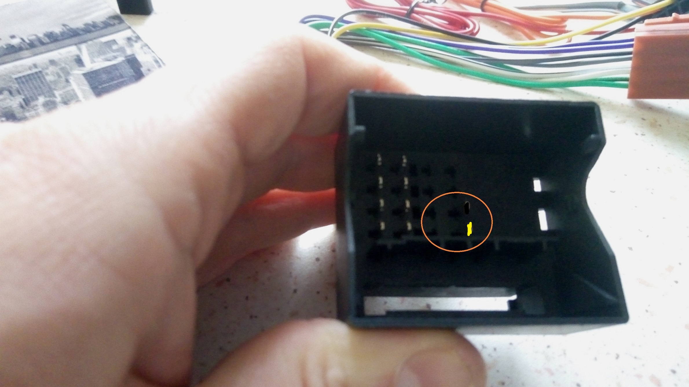

    Good morning, I have 3 questions to join experts. It's about dispelling doubts :) because, unfortunately, I found in the network 2 different descriptions of the power cube iso ...
    1) The request to look at the photo on the black-mass is ok, but as for the yellow one I do not know if it is "under the ignition" or "under the 12V battery," someone will help?
    2) Possibly if this loose red is for 12V akum. this is where to attach it to the Opel cube (2foto)
    3) Antenna - constant power (because it's probably not the same as ejecting), the blue cable goes out, I plug in where, or maybe the link with which?
    Thank you very much.

    Thanks, so it comes out that the yellow radio cable is a combination (as I wanted) with a plus from the battery, and not just from the ignition.
    There is the issue of the blue cable from the antenna power supply, no problem I will bump into the free "pin" of the cube, but should I understand that the radio will supply the power needed to amplify the antenna signal; / because I thought I had to pick up, for example, plus power? (this photo is an adapter from "opel" to 2iso, and soon I am going to the store for a radio and with it will be an adapter from 2 iso to 1iso
    PS. In the large "Oplow" cube from the picture above, these 2 power pins are in the right place, because I also found such a pattern in the net (it is also in Opel's cd30) and is "something else ... because GND (mass) is from the side and not over a plus - if I take it right from the picture.

    You can take the blue wire to the red one after the ignition and then the amplifier will work. This plugin with this scheme is not sometimes the radio of a different model than yours.

    And whether in the large "Oplowska" cube from my photo, are these 2 power pins in the right place? because I found such a pattern on the net (it is also in Opel's cd30) and it is "as if ... because GND (mass) is on the side, not on the plus - if I take it right from the picture.

    Are there any colors from this cube sticking out of this peg, what did you mark? The diagram is from the Opel-cd30-mp3 cube, that is under the Blaupunkt radio and that's why you do not like to leave.

    So two cables from the power cube, ie yellow and black, enter a large Opel cube - mark the attached picture.
    I do not want to suggest, but should not the yellow be in the black spot (plus from the battery), and black on the left here where GND, or somewhere above where is the CE-?

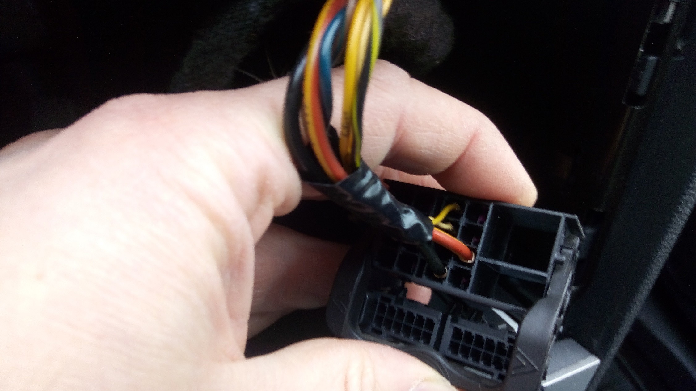

    I will go down to the car, take out the radio and see what cable colors are hidden in the installation cube in this particular pin location, like yellow / red and black as probably GND will probably be okay?

    I removed the radio and took a picture of the installation coming out of the car to the radio and in my opinion it is as I thought. I attach a photo like on the buying block should (probably) be pinned.
    I'm well-suited?
    • Opel Cube ISO Power Supply Queries: Key Switch, Battery, and Antenna Connections Clarification po zmianie.jpg (480.22 KB) You must be logged in to download this attachment.
    • Opel Cube ISO Power Supply Queries: Key Switch, Battery, and Antenna Connections Clarification P_20180202_152042.jpg (415.12 KB) You must be logged in to download this attachment.
    • Opel Cube ISO Power Supply Queries: Key Switch, Battery, and Antenna Connections Clarification P_20180202_152018.jpg (415.93 KB) You must be logged in to download this attachment.
    #12 17007675
    Pedros050
    Posts: 17914
    Help: 2471
    Rate: 3926
    You combine so well.
