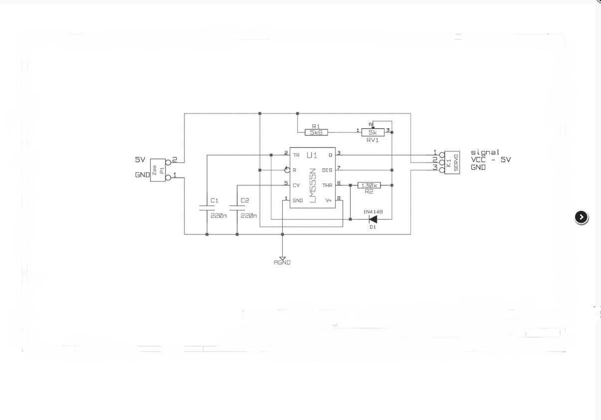

How do I control a brushless motor ESC from an old drone motherboard, and what signal should the white wire receive?
You do not feed the white wire a motor voltage; it must receive a control signal, typically the RC-style pulse signal used by servos and ESCs. The signal is usually a high pulse repeated about every 20 ms, with pulse width around 1–2 ms, and the ESC will not run the motor without that kind of input [#16648227] In a drone, that signal normally comes from a receiver or flight controller with PWM outputs for ESCs, not from directly varying the motor supply voltage [#16648154][#16651641] A simple 555-based voltage-to-pulse converter might be made, but it is not the right replacement for a proper controller and may be hard to get working reliably [#16647804][#16648227] Some drone ESCs also use faster protocols than ordinary PWM, so the safest route is to use the original PWM/control signal or replace the radio/flight controller with one meant for BLDC motors [#16648227][#16651641]

    Hello, I bought a cheap used drone called Intruder Cam, the drive mode has been damaged. I decided to modernize it slowly, wanting to leave the radio and motherboard old and replace the factory engines in it, they were ordinary motors with two cables. I bought 4 brushless motors in this store https://abc-rc.pl/silnik-1400kv-2-3s-180w-abc-power and four regulators https://abc-rc.pl/esc-abc-power-air -30a-bec-2a-simple-regulator And I have no idea how this regulator works, I mean controlling it, i.e. the white cable, I know the rest of the terminals, I don't know what to do with the white cable, that the motor starts to rotate, you need to give voltage, pulse does it have to communicate with any device? The motherboard in it controlled the turnover of the factory engines by simply increasing the voltage

    Oh, or I am starting to more or less understand what's going on, i.e. these regulators are controlled by impulses, I found a diagram on the ne555 system, maybe it would pass the exam. And I have a question whether it is possible to start the engine without building the control system. I probably still have a 555 chip somewhere at home The principle of operation of the speed controller of brushless motors for a dro

    Rather, to control the rotation of the engines you need a receiver and a transmitter.

    Model control signal is not a typical PWM signal - it is a high state repeating every 20 ms and taking values between 1 and 2 ms (description e.g. here: http://forbot.pl/blog/artykuly/elektronika/kurs-elektroniki-ii -6-signal-control-pwm-id9527 - admittedly an example on the servo but the ESC controller works on the same principle only instead of changing the deflection - it changes the engine speed from 0 to max).
    Oh, so I'm starting to more or less understand what's going on, i.e. these regulators are controlled by impulses, I found a diagram on the ne555 system, maybe it would pass the exam
    in the form as in the drawing - certainly not, because it is - a controller for modeling servos / regulators but rather a tester - servo position / motor speed is set by a potentiometer and you need a converter but voltage-controlled.
    No. The regulator must receive the signal described above and will come alive.
    Generally, this is first of all without electronic experience (assuming that you will even find a ready converter diagram) - excuse me but the previous questions indicate that you are a bit beginner - you have little chance to assemble and run one.
    Secondly, drones use other solutions (faster - a computer drone reptile with regulators with a much faster protocol - about 10 to 50 times - than ordinary PWM).
    So try to make these dentures: voltage output - brushless regulator you can but how it will work - a lottery ...
    So, as the previous speaker wrote - it would be good to replace the whole set, i.e. the radio - control board - regulators (the engines you bought are suitable)

    I managed to make an engine tester from this diagram, which I included on the Ne555 system, instead of a potentiometer I soldered in front of the system that gave voltage to the factory engine and I managed to get speed control even quite smooth from the drone factory motherboard, you might need to choose the appropriate resistor to control the sensitivity and it should be fine but I can regulate the engine speed with the remote control. Alternatively, you might need to look for some more interesting schematic of the system changing the voltage to pwm

    And what about the trimmer regulating the rotational speed of engines (there are no ideal parameters for each engine and regulator) to correct the position.

    Self-adjusting speed for position correction also works. Only this engine is a little more sensitive I will play with the selection of resistors in this system on ne555 but generally works smooth speed control from the remote control now I have to make a new frame because it bends you can see that the engine is stronger and etch the plates under the systems on ne555 and assemble the whole :) I am curious myself how it will fly, it will succeed, it is worth trying, if not I will change electronics, but these engines have a completely different working culture compared to the old ones on gears, so maybe it will be better :) I am happy that it works and what we will see next :)

    Most often the PWM signal comes out of the receiver, and this goes for a simple RC filter and brush motor controllers.
    It is better to look for the original PWM signal and not play 555. And completely get rid of the brush power amplifiers - they needlessly consume a lot of valuable current.

    defect , PPM is usually used in modeling receivers, not PWM.
    In addition, pins with a width of about 200us come out of the receiver as such and only after the channel decoder are they "virulent" for servos and motors.
    As for motor controllers, you are also wrong, there are no filters and amplifiers there, the regulators replace PPM for PWM for motors and are made on microcontrollers.
    From the regulation side, the brushless and brush motors are controlled identically.
