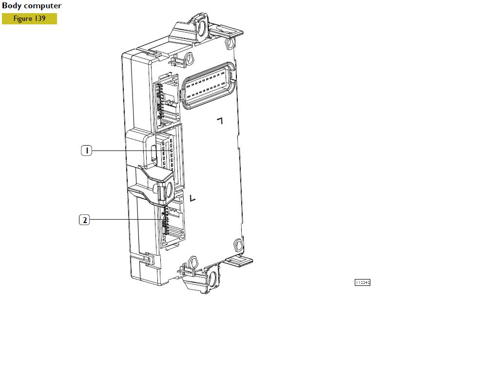

    Hello. I have a problem with outdoor lighting. There is no power to the rear left position. I dug the entire beam under the car, I found nothing there, all the wires ok. There are 3 yellow wires to the rear lighting, two position and the backlight of the board. The second thing is the left direction, all the bulbs are ok and the breaker is knocking as if one was burnt. I was looking for a lighting controller, but it is missing under the steering wheel. Maybe someone knows what can be and where the lighting controller is. The car is from 2007. All fuses ok. Diagnostics shows a short circuit on the right and left side of the rear lighting, which is not there, unless the drivers have a short circuit.

    This model has a computer body near the fuses and all the lighting goes to the rear.

    In which place, the fuses, and exactly the fuse box, the one in the cabin and in the engine compartment, I turned out. I found nothing there in the compartment next to the battery is the controller but the ecu engine.

    Thanks I found was for plastic. Maybe someone has some description of the cubes.

    At the fuses inside the driver's left leg, I will add a diagram, maybe it will help.

    Maybe you have some description of the wires

    Description of Body-computer connectors.

    Hello, in order not to do another topic, what cube is LN (color and place)? I need it because I have a short circuit against the foggy left pin 43

    In post 6 you have Body Connectors ..., above OBD is LN connector.
