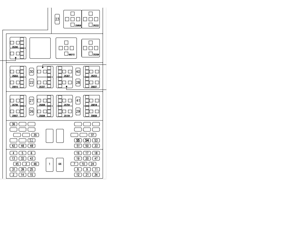

    Hello, I am the owner of Iveco from 2000. In the toy car there is a problem with the blower at first it was only at the maximum speed range, so the diagnosis fell on the resistor, however, after replacing it with a drug, nothing else. The fuses are ok. The blower also works well when connected to the battery for a short time. After connecting the multimeter to the plug from the blower on the 1,2,3 range shows less than 12V while on 4 there is a lack of voltage. Here's my question, what may still be wrong and can you check the resistor somehow?

    yes, with a multimeter, measure the resistance of the resistor.
    4 pin is mass.
    but your description shows that the resistor is damaged.
    best regards.

    Something had to be combined under the dashboard by the previous owner, because after pulling the power from the lighter everything works as it should.

    A common reason is the blown miniature fuse contact No. 21 or plug at the supply switch.
