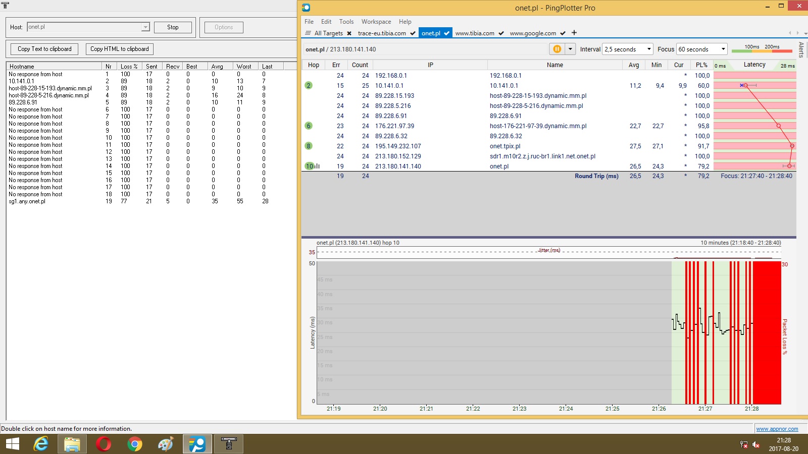

    Hello, I recently connected the internet to multimedia. I sometimes play one game online and unfortunately there are large ping jumps up to 5000-10000 ms, I assume that it is the fault of losing a lot of packets but I am not a specialist for this, so I decided to ask for help to determine the actual cause of the problem .
    What I know about the network:
    30Mb / s, coaxial cable splitter for tv and internet.
    Arris tg2492s multimedia router

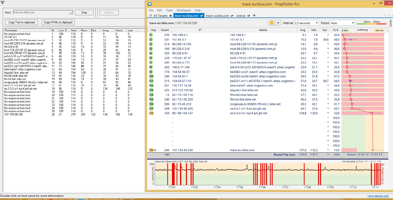

    here are screenshots from the winmtr program and pingplotter, in addition, I decided to do tracert on 1 multimedia server on the way,
    High Packet Loss Issues: Arris TG2492S Router, 30Mb/s Coaxial Cable, Ping Spikes up to 10,000ms
    High Packet Loss Issues: Arris TG2492S Router, 30Mb/s Coaxial Cable, Ping Spikes up to 10,000ms High Packet Loss Issues: Arris TG2492S Router, 30Mb/s Coaxial Cable, Ping Spikes up to 10,000ms High Packet Loss Issues: Arris TG2492S Router, 30Mb/s Coaxial Cable, Ping Spikes up to 10,000ms
    I did more tests but saved them to a text file but most of it looks like this,
    router 30% loss,
    10.141.0.1 ~ 90%
    and another mm server also about 90%
    I will be grateful for your help, I hope that the information provided is sufficient.
    Regards Grzegorz.

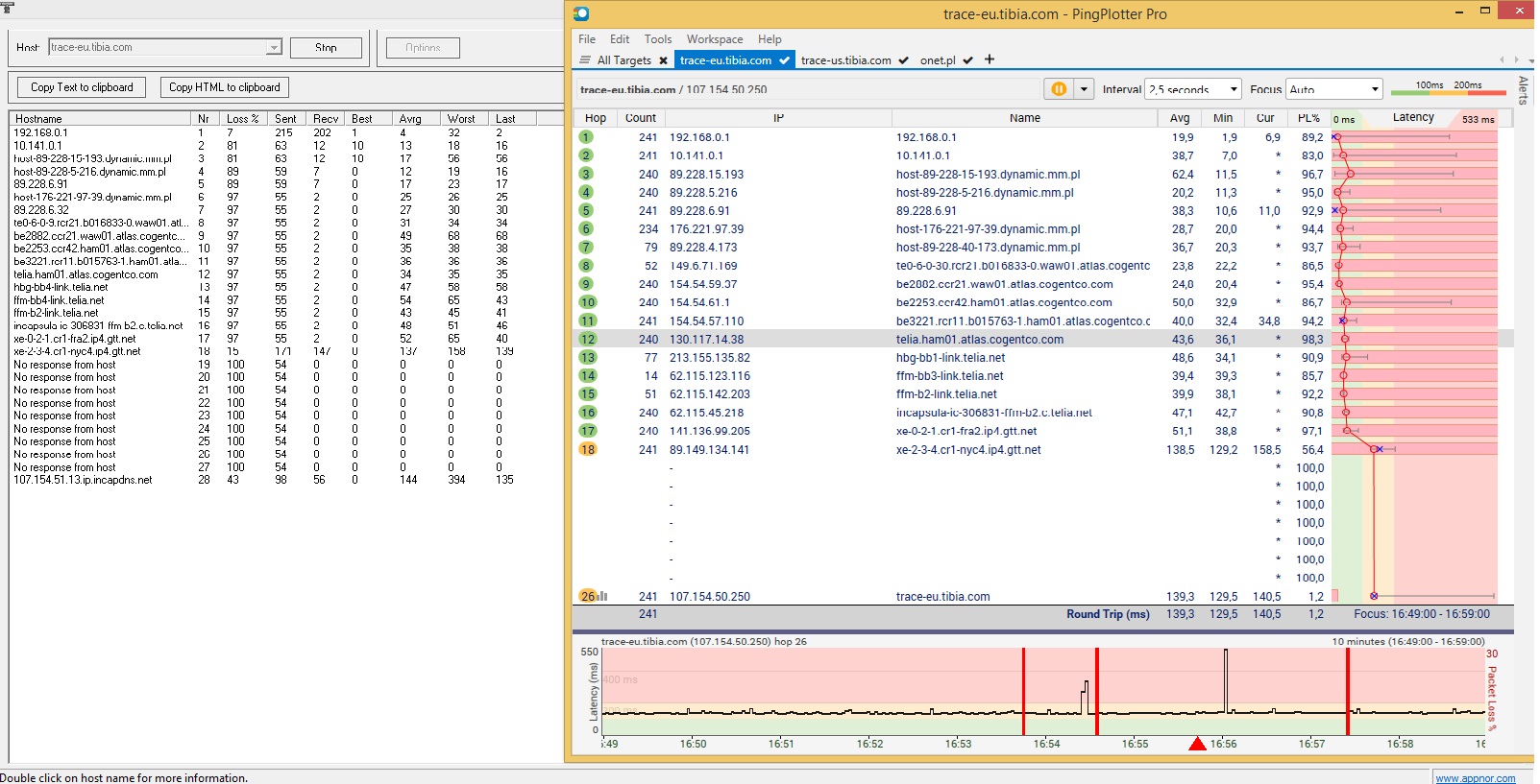

    The router as I wrote in the first post is
    Arris TG2492S
    it is owned by multimedia and I cannot log in to it, all I can use ebok is to set the WiFi password and the channel, but changing the channels does not change the situation.
    Yes 192.168.0.1 is rather my router because what else? As I wrote, I can't log in to it.

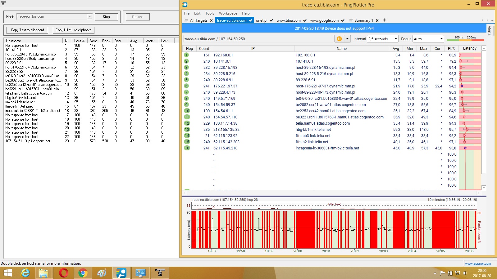

    here is a photo of working on the cable about 10 minutes

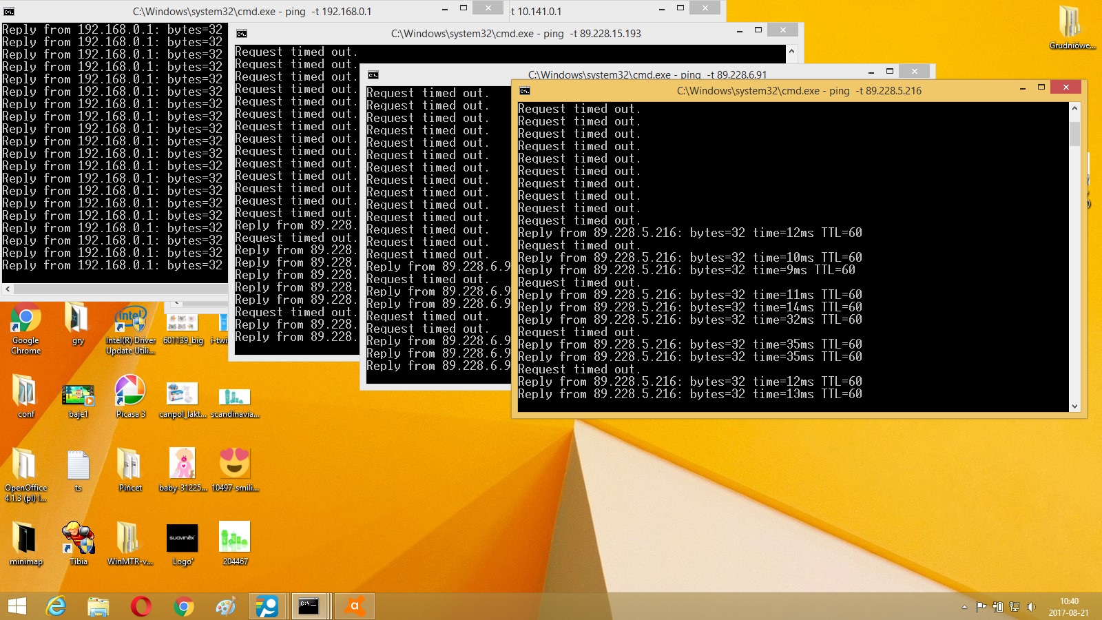

    Ping -t on the router shows no ping loss on average 1-6ms maximum 20ms, it took me a while to start in safe mode but I finally managed and unfortunately it does not change anything, I think a short test shows what is needed.

    Szafamoto wrote:
    Ping -t to the router shows no ping loss on average 1-6ms, maximum 20ms,
    Apparently trace packets from the plotter's ping are blocked / ignored.
    Try multiple cmd.exe "ping -t xxx" windows where xxx are consecutive traceroute routers until you find the bottleneck.

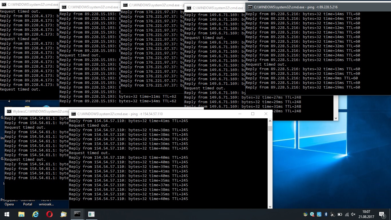

    ok i did, from the second laptop i hope it's not a problem.
    I will throw in a photo but I will describe it first.
    1 after the router, I do not know what it will be, a box on the cage or something I do not know. Request time out.
    on each subsequent one from time to time there are losses from 2 starting, although I think it wasn't until I started pinging around server 9 but it may seem to me, I will try in the afternoon to do it better on my laptop with a mouse because the touchpad is for me divine punishment. I will also put in a comparison with 2 computers that could also rule out computer fault.
    What is a bottleneck? And am I able to use a ping plotter or something else to tell which server is not responding at the moment? Since not every packet loss corresponds to in-game freez, but I am able to locate which by playing.
    I throw symmetrically made ping, here is laptop No. 2, for WiFi High Packet Loss Issues: Arris TG2492S Router, 30Mb/s Coaxial Cable, Ping Spikes up to 10,000ms
    Here is the laptop No. 1, connected with a cable, High Packet Loss Issues: Arris TG2492S Router, 30Mb/s Coaxial Cable, Ping Spikes up to 10,000ms
    Ping routers before and during gameplay to find bottleneck

    Do "ping -t" without playing (eg to the first 5 routers from the traceroue list), interrupts on some router? ie what% losses are on a given router, you save the results.
    then you test the ping while playing, and look at where it stops and compare it to the results without playing.
    I see ping first on x.193 router, so that's the bottleneck.
