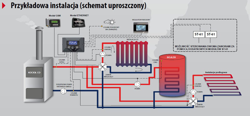

How can I stop the floor-heating return water from dropping the boiler return temperature below the 68°C setpoint in a Defro Comfort Eco 15 kW installation with a 4D valve?
Connect the floor circuit behind the 4D valve together with the radiators, not directly to the boiler, because in the current layout the valve cannot properly protect the boiler return from cold water [#16655719] [#16655954] The second scheme is considered correct, and the controller can handle an additional 4D actuator with separate control of each circuit [#16656696] An extra pump near the boiler is not needed in that setup if the DHW pump runs all the time; if you do use a boiler circulation pump, the 4D valve alone is still a compromise between precise circuit temperature control and boiler protection [#16656696] [#16656781]

    Hello, in my opinion, all heat consumers should be connected behind the valve. In this diagram, it does not fulfill its role.

    The floor is not connected properly. It should be connected to the 4d valve just like radiators and not directly to the boiler. I would not put an additional pump on the boiler because in this system the HUW pump already has the function of mixing. In addition, until the floor is properly connected, the additional pump at the boiler will not change much.

    It should look like the first diagram. In my opinion, the second scheme is also legitimate (and I may be wrong). Then I would not have much change, but I do not know if I can put a pump on the return because I have 1 1/4 "there. Unless it can be without this pump by the stove.
    Do you have thermostatic valves on the radiators? You did this installation yourself or did someone do it to you? How is this four-way valve controlled?
    As for the pump on the return, even if you have a 1 1/4 pipe, so what, you have not seen how the pumps are installed in CO even on 2 inch pipes? Do they have 2 inch connectors?

    Both diagrams are checked and will work properly. The second diagram is also OK because your controller will handle an additional 4d valve actuator and will have control over each circuit separately. An additional pump next to the boiler does not need to be installed if the DHW pump is switched on all the time.
    For this to be the pump from the hot utility water would have to work in parallel with the CH pump.
    lechumb1 wrote:
    I would like to know if any of the following schemes will solve my problem with flooding the boiler with cold water from return
    Diagram two with a boiler circulation pump.
    The 4d valve itself has the weakness that you will either precisely control the temperature of the water in the circuit or the protection of the boiler.
