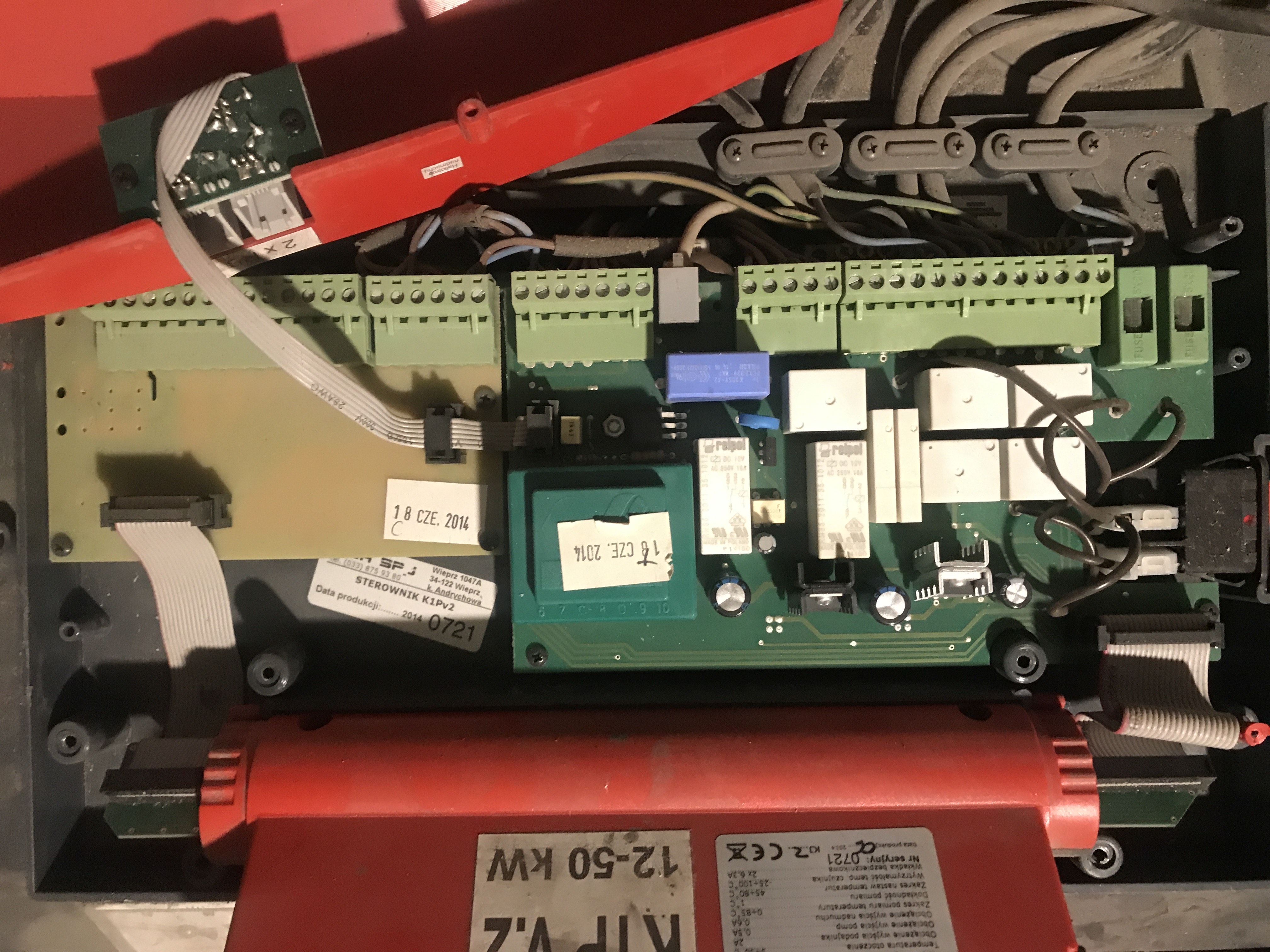

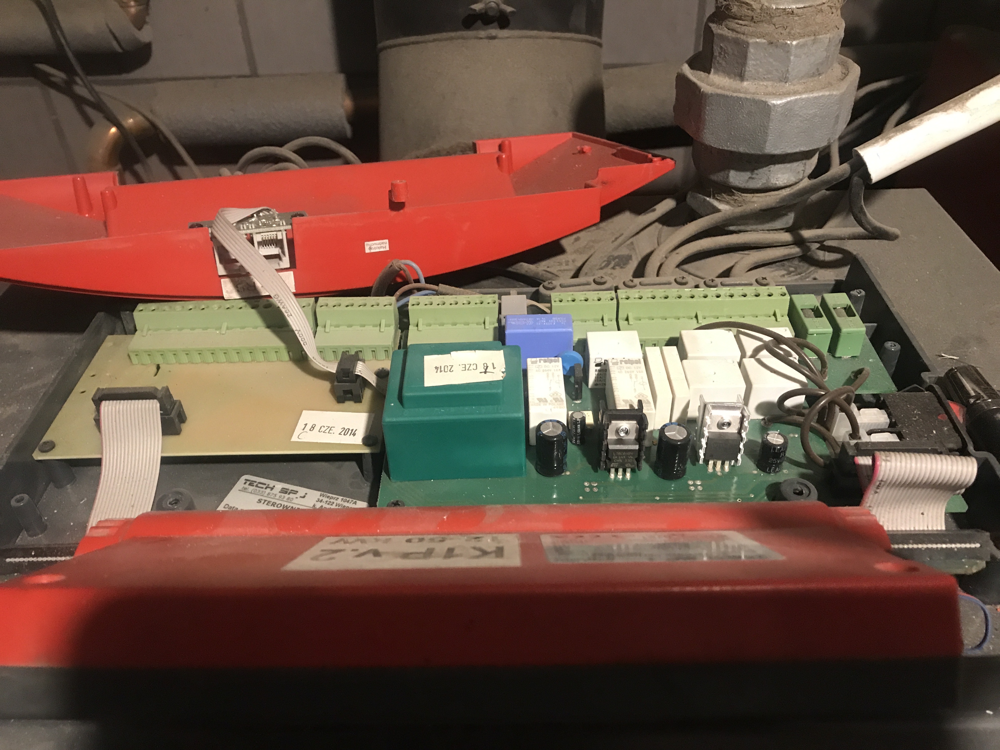

    I have a problem with a 6-year-old heating boiler for eco peas, it's about a pop-up alarm regarding too high mosfet temperature.
    Company: Defra
    Model: Eco Comfort 15KW
    Driver: K1P v.2
    Description of the problem:
    The stove works flawlessly and I would sum up as a sensational device, but ...
    For several weeks I have been getting an alarm "Mosfet temperature too high"
    I took off the housing behind the digital display (photos).
    When I open the windows and there is a breeze, everything works fine.
    So something must be overheating somewhere.
    Do you have any idea what it could be and how to fix the problem

    The mosfet controls the fan speed. Maybe the bearings just ran out and it's working with resistance. Check what is the actual temperature of the mosfet. It's probably the one with the aluminum (bright) heatsink.

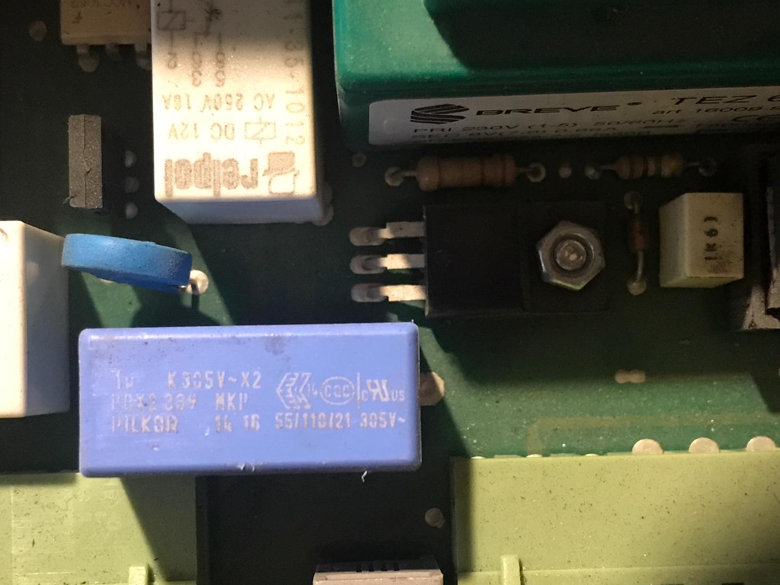

    Sorry. Yes 1uf 305V. The mosfet is the blower fan control transistor without a heat sink and is screwed on the board next to the blue capacitor that needs to be replaced.

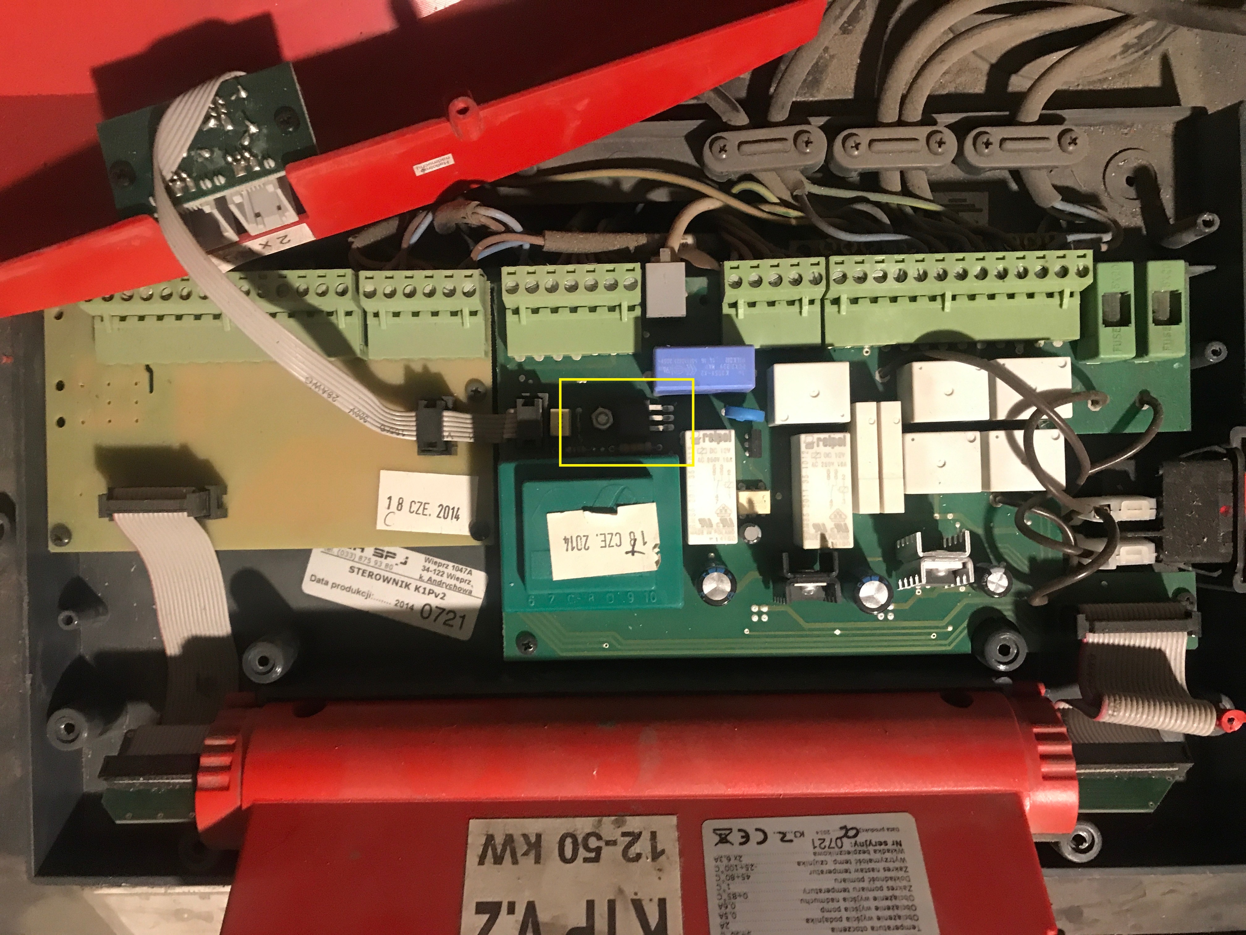

    Is that the capacitor I circled in yellow?

    #7 18965210

    No, the blue cuboid next to it.

    The one who wrote mipix. The one marked is a mosfet transistor.

    I'm sorry I ask so much. Is it the blue one?
    It doesn't overheat, it's not hot at all.
    • Defro Komfort EKO 15KW failure "Mosfet temperature too high" WhatsApp Image 2020-10-14 at 08.04.48.jpeg (148.33 KB) You must be logged in to download this attachment.
  • #10 18976598
    andrzej55
    Level 37  
    Posts: 3000
    Help: 306
    Rate: 373
    Yes the blue one. Just replace with a new one with the same parameters.

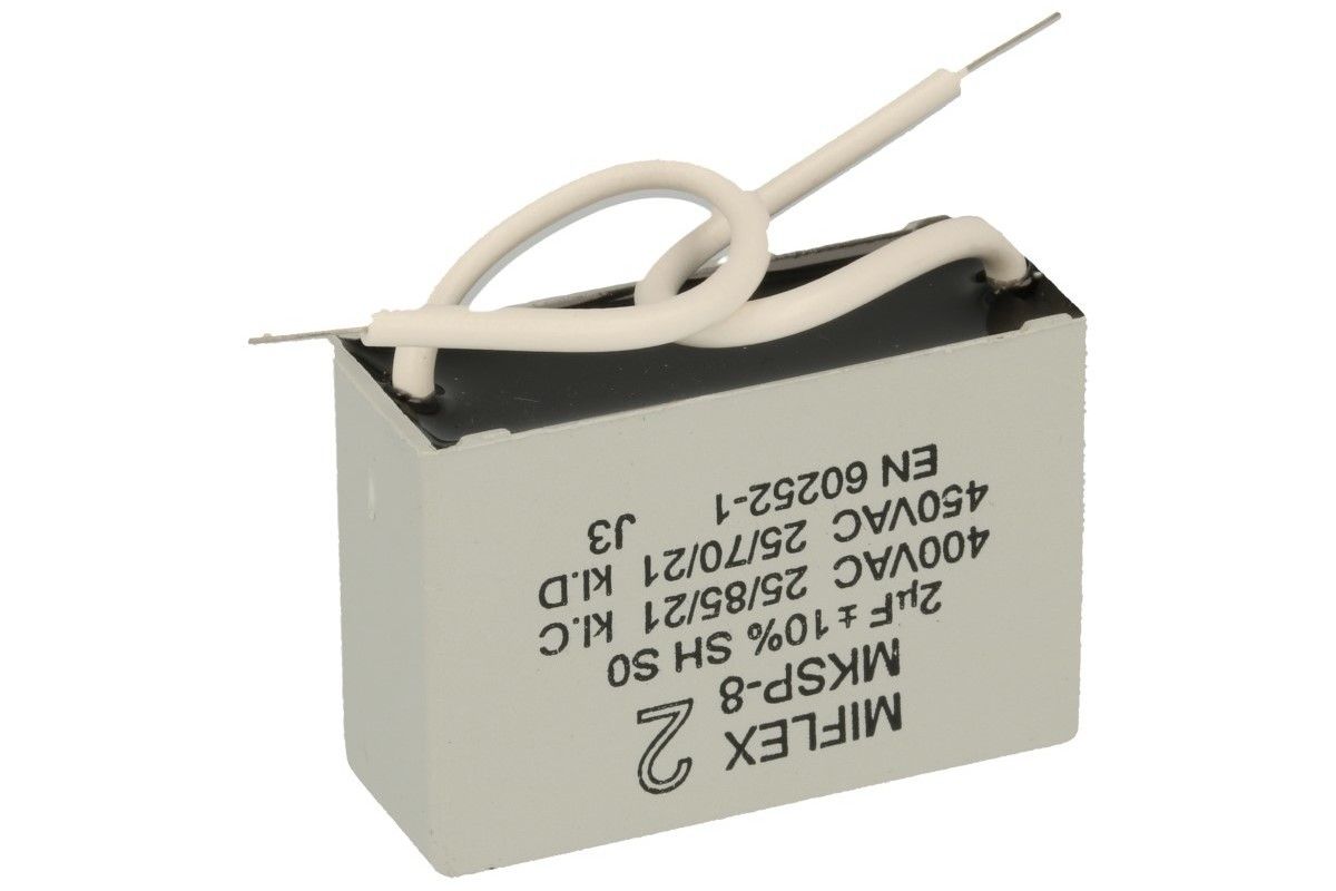

    I checked the driver and the capacitor (blue 1uF) had a loss of capacitance. I replaced with a new (identical) 1uF 305V capacitor and mosfet transistor. Unfortunately, the problem persisted. On the display I still have the message Mosfet temperature too high (error 200).
    I will add that the blower in manual mode works properly (i.e. it is possible to adjust the speed).
    What did I miss? Please help.

    Please check the blower condenser and the blower duct for obstruction.
  • #16 19630489
    maystero
    Posts: 1010
    Help: 58
    Rate: 204
    Gb601 wrote:
    Please check the capacitor at the blower and the blower duct for obstruction.
    Turbine, okay. New capacitor installed (2uF/400V)
    The problem has not gone away.

    Already the driver works for a week. Replacing the cube in the controller helped, it clearly had no capacity. I also replaced the cube in the blower but this one was good 2uF. I did not have a mosfet and did not replace it, but I will buy it as a spare. Thank you for your help
