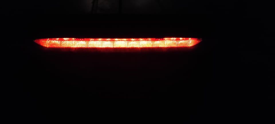

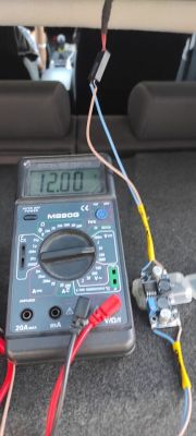

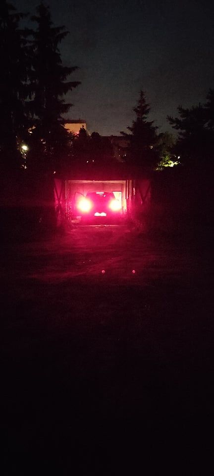

    Seat Leon Third Brake Light LED Replacement: Identify Correct Diodes & Calculate Values Seat Leon Third Brake Light LED Replacement: Identify Correct Diodes & Calculate Values Seat Leon Third Brake Light LED Replacement: Identify Correct Diodes & Calculate Values Hello, I had a similar replacement of damaged diodes, ended with a mechanic replacing them with a LED strip. It did not work too long, because max 12v can withstand the LED strip and the installation gives 13.6v. I used a voltage stabilizer and everything flickers
