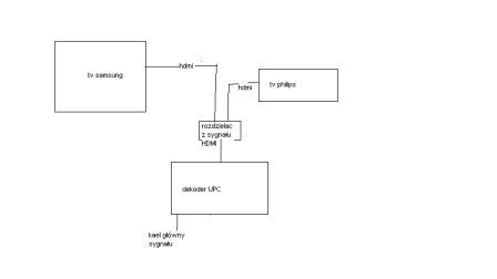

    Hello all. I have a question related to connecting two TVs to one UPC decoder. How do we connect cables so that everything receives programs. According to me .. the main antenna to the decoder and then from the decoder only via HDMI to TV let's call the main .. Samsung 40 'and the second also via HDMI to TV No. 2 philips 24'. I skip the issue of UPC signal blocks and the need to buy a Multi room or something. And further ... the smaller TV has a 20 m HDMI cable ... which extends partially into the wall and sometimes under the skirting boards by the floor. Does it affect the lack of signal and its transmission ...? Of course, I assume that the cable is ok bought at a price ... about 70 PLN. Does the Philips TV settings require any special configuration? Previously, he received terrestrial tv programs on a regular cable and it was ok. Does this philips have to have HDMI cables connected and traditional antenna ones> ??? ... I hope everything is understandable ... I wait for every word that will solve my post-renovation problem . Pozdrawim.

    is this correct? Connecting 2 TVs (Samsung 40' & Philips 24') to 1 UPC Decoder: HDMI Cable Setup & Configuration

  • #15 16676045
    Staszek z Chełma
    Level 19  
    Posts: 304
    Help: 19
    Rate: 56
    In such a situation, in both TVs the same program, you still need to bypass HDCP protection, maybe this device will meet the requirements.
    Have you read the first post?
    And according to the specifications:
    Maximum HDMI cable length: 10 meters for 28AWG specification; 15 meters for 26AWG specifications.
    So rather money thrown down the drain.
