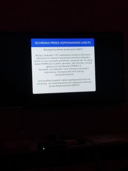

    Hello, I am in the process of connecting satellite TV channel plus
    After connecting the decoder to the Samsung TV, an error appears regarding HDCP protection, what to do or how to bypass it
    Thank you in advance for your help
    Regards
    Added after 49 [minutes]:
    An error that appears on the TV
    Hmdi 2.0
    How to bypass HDCP error between Canal+ decoder and Samsung TV?

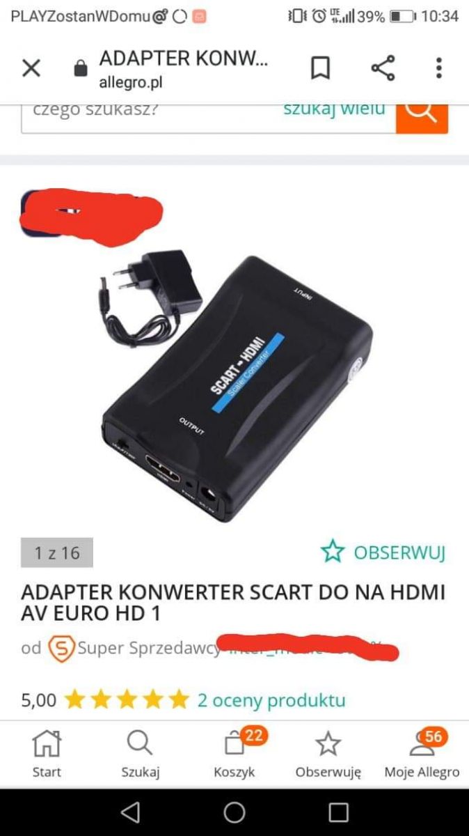

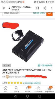

  • #17 18610560
    lukaszduda9595
    Posts: 20
    I found a converter
    They only have 2 signal types, one from Euro to HDMI and the other from HDMI to Euro
    Which one should I choose if I want to connect it to the NC decoder with a Samsung TV so that it works properly? How to bypass HDCP error between Canal+ decoder and Samsung TV? How to bypass HDCP error between Canal+ decoder and Samsung TV?

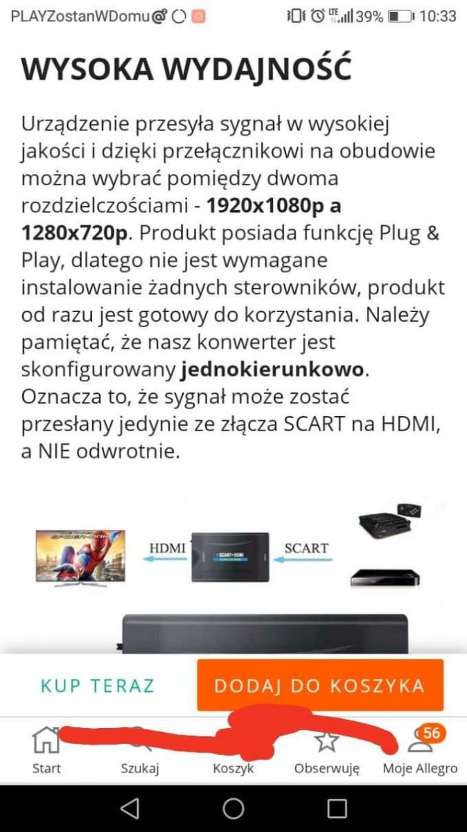

  • #19 18610734
    lukaszduda9595
    Posts: 20
    I want to connect it to the euro, but I don`t have it on my TV and I`m thinking about buying this converter with a power supply, but I don`t know which one to buy, I need advice in which direction the transmission should go.
    I think it`s from eruo to hdmi but I`m waiting for an answer before purchasing
  • #20 18611748
    vito007
    Level 26  
    Posts: 942
    Help: 73
    Rate: 216
    Nothing with a Euro connector is suitable for this.
    Look for an HDMI splitter, only a better one, with external power supply. Cost approx. PLN 100. Cheaper crap isn`t suitable for this.
