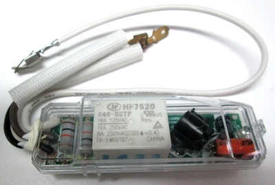

    I have a Bosch Sensixx DA50 iron in which the electronics, the so-called fireman, burnt. From what I know, this model also has an ionization function, but I can do without it. Would someone familiar with the subject tell me how to connect the power / bypass this electronics so as not to completely spoil the iron. Attached photo with power cables ... I did not add photos of this burnt module, but with it there was a cable about 0.75mm 2 black with a small male pin, and the rest of the wires were burned ...
    One more question by the way. How to remove the top of the handle / handle, something holds the middle right next to the steam buttons?
    Thank you very much in advance for your help

    Remove the white cover from the foot and take a good photo with the wires lying next to it and draw where to connect.
    I just need to see the thermostatted foot.

    Sometimes you have to remove the steam keys because there is a screw holding this part of the housing underneath them.

    :arrow: nioop I throw in another photo, maybe it will explain something ...
    Bypassing Electronics in Bosch Sensixx DA50 Iron with Burnt Fireman Module
    In my opinion, I would combine brown with the plate instead of white and additionally black with it (the bulb would shine and the thermostat would be shorted). I forgot to write in advance because the photo shows poorly ... There are the following markings on the plug: blue - N, white - L, yellow-green - you know PE
    But I prefer to ask specialists not to burn it completely ...
