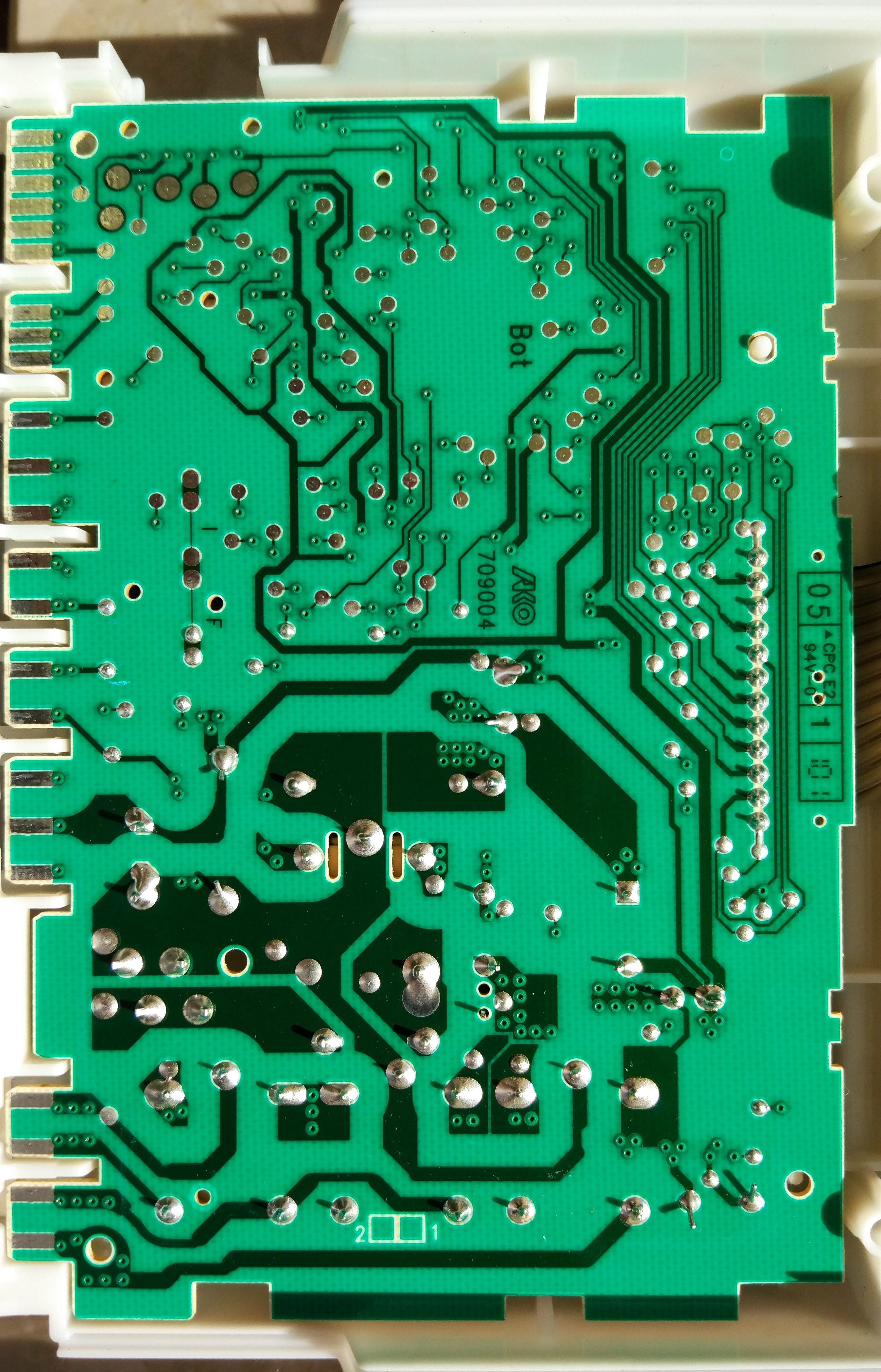

    So yes: the patient is a dishwasher Bosch SRV45T63EU/01 it has been at my house for about 7 years, during these years of use regularly it gains value. Yes, it's not a mistake! the dishwasher breaks down in the same way every time exactly after the 2-year warranty expires, its problem is the programmer ( the board is AKO 709004 while the model of the programmer is AKO 718778-02 ) in which, as can be seen from the observations, the resistors burn out (it is always the same 222) in addition, some other element is probably damaged, but it is hard to tell in the system connected at the layered board.
    As I said, the same thing always happens, so the dishwasher turns on and allows you to choose the washing program, after closing you can hear the pump that wants to pump out the water that is not there and there is a long wait of about 3 minutes (here the dishwasher should open the solenoid valve and let water in) and then it starts again the pump starts and everything loops like this because of the lack of water.
    I would like to warn you right away that, as after any failure of the programmer so far, the solenoid valve is checked directly under the voltage of AC 230V and each time it turns out that the valve works properly
    I will add that there is currently a small problem related to the beam, most likely. After turning on the power via the main power button, the dishwasher did not start, the first thing that came to my mind was moving the beam thanks to which the dishwasher turned on, but after several attempts I still cannot tell which wire is responsible.
    Moving on to the merits of the case Would anyone like to share the scheme of the programmer and its service pads, or what where I can measure and what should be the values.
    The equipment itself washes dishes well, the programmer is quite expensive, and the services that initially undertake to repair it change their minds and claim that the module needs to be replaced (of course I understand it, I often replace modules myself instead of playing with a trifle). As the dishwasher is twice as expensive to me as it was at the time of purchase, I would like to resurrect it to make it last a bit longer.
    I am posting photos of the damaged board and also with the resistor replaced with "threaded" due to its higher power, but it did not solve the problem.
    Tips from someone who has already gone through this problem are welcome.

    At the very beginning, I suggest checking the wires that are plugged into the connector at the damaged resistor. This model has a dishwasher program indicator, it may have been flooded. The indicator light is inside the door, check the plug and condition of the wires.
    https://www.elektroda.pl/rtvforum/topic3296863.html#16243780
  • #3 17184307
    matilago
    Each time the new module restored the correct operation of the dishwasher, but I will actually check the condition of the wires at the connector from the burnt resistor at the end of the week.
    When you talk about the dishwasher program indicator, do you mean the diode that signals the dishwasher's operation? It works properly and there is no option for it to be flooded because it is located on the front of the door, in addition, I checked the bundle visually and it does not show any signs of abrasions or interruptions, so the phenomenon after moving the wires is inexplicable to me, just like the wires in the power connectors are well embedded and there is no option for anything not to connect there. The plug is like new.
    Regarding the test points, I have a problem with measuring different values on each controller at the moment, each of them has, but it seems quite strange to me that these values do not match, which is why I asked for some diagrams/documents.
  • #4 17207951
    Loker
    Posts: 3368
    Help: 575
    Rate: 721
    Salt sensor line pull-up. The contacts of the sensor short this line to ground, if there is a break in the beam, instead of ground, 230V may go to this line, which will burn the above-mentioned resistor, plus I suspect some further damage to the system.
    So if you're checking a bundle, it's the whole thing.
  • #5 17208577
    matilago
    @Loker thank you for your reply, I will check the circuit again carefully then. Do you think there is a possibility that something like this happened from lack of salt?
    The module itself works, I can choose the program, I close the dishwasher and if I pour too much water, it will pump it out, unfortunately, because it is unable to open the solenoid valve, it cannot go to the next part of the program. Is it possible the relay went out? Do you know who is responsible for the solenoid valve? I will only add that they all have a resistance of 100? on the coil side
  • #6 17209684
    Loker
    Posts: 3368
    Help: 575
    Rate: 721
    No salt has anything to do with it - possibly a broken/non-contacting wire in the harness.
    There are several valves in this dishwasher - they are all controlled by triacs. The triacs in the photos look fine.

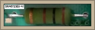

  • #7 17366420
    gotiger
    Posts: 7
    Does anyone have another photo of the above-mentioned programmer board? I mean a photo or comparative information, and more specifically, the color of the green resistor (the big one next to the electromagnetic relay).
    For me it's burnt and I'm not sure about 3 lines:
    1-brown,
    2-black,
    3-black or dark gray,
    4-gold.
    Dimensions 13x4.5mm.
    I am asking for help in choosing (maybe someone has a diagram and will tell).
  • #8 17366486
    dzi_dziuś
    Home appliances specialist
    Posts: 2046
    Help: 341
    Rate: 1169
    The value of this resistor is not critical, you can give brown, black, brown, gold or something close to it. Resistor power 2W. However, you must take into account that this will not be the only fault to be removed, unless you do not write everything and you made a short circuit in its vicinity :)

    gotiger wrote:
    more precisely, the color of the green resistor (the big one next to the electromagnetic relay).
    A green resistor with colored bands on a circuit board.
  • #10 17366569
    gotiger
    Posts: 7
    baby thanks for the info, as for the power, I wasn't sure if it was 1W or 2W. The rest of the elements seem to be OK, but if there is anything more, it will come out in the wash ;)
    I didn't do the short circuit myself, the beam will remain to pass, if there are any abrasions, cracks. I had concerns about the relay, but the measured one seems to be working.
    On the other hand, the resistor has worked for 6-7 years and could simply overheat (I think).

  • #12 17367424
    gotiger
    Posts: 7
    Why do you ask if you still have a problem so trivial
    No exaggeration, and I'm asking because 100? and 1.01k? definitely makes a difference (photo below).

    gotiger wrote:
    I am asking because 100 ohms and 1.01k ohms
    Of course, 100? and 1.01k? is a difference, but:
    1. Where do you see the 1.01k? resistor (it would have to be from the E192 series, i.e. 0.5% of the value tolerance).
    2. The resistor with brown-black-brown stripes is 100? even if the resistor overheats (as you can see in the pictures) the stripes changed colors.
