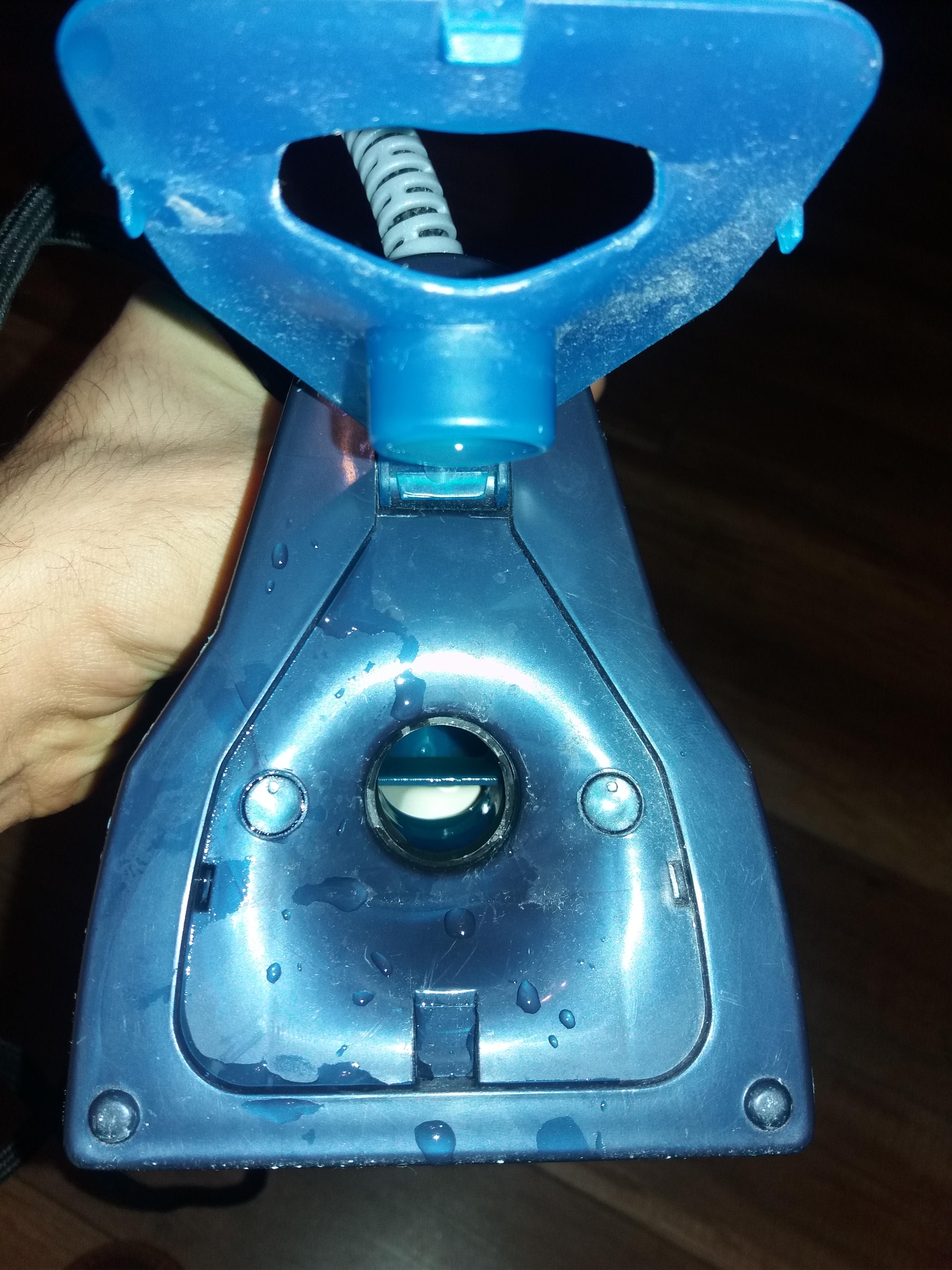

    Hello forum users!
    My question, or rather the problem, concerns the steam button on the Bosch TDA 5680 Sensor Secure iron. Namely, you can not use it. After heating the iron to the required temperature, you cannot press it to use the steam function. I admit that I do not use the iron personally ;) but the problem affected me so please help. The iron has never been descaled.

    Remove the pump from the iron, disassemble, clean. Be careful not to let the small metal ball fall out, which is under the pump.

    Yes, that's it.
    Unscrew the back, remove the keys, unscrew the screw. We remove the upper handle housing ...

    Is the back of the iron what I have included in the attachment? If so, then you write about its dismantling. I think there are two end caps there. How to remove them to get further, I think for the screws?

    Yes, end caps.

    What do you pick them from?

    There are mini grooves in them ...

    Gently with a knife or a small flat screwdriver.

    I took them out, two screws appeared ...

    In conclusion, the diagnosis of MARCIN.SLASK proved to be 100% accurate. When I got to the pump, I took it out. It turned out that the shot there (steel ball) was "caught" with a stone. After cleaning it, the steam strike works.
    Thanks again for your help!
