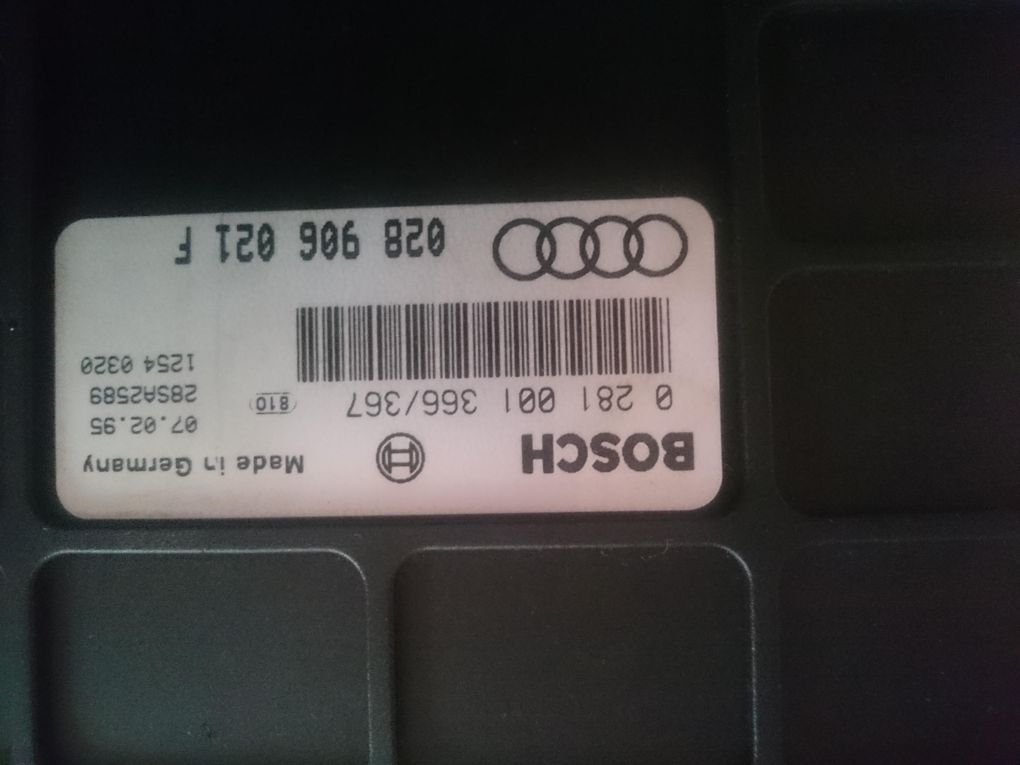

    Colleagues need info on how to do this in this driver off.
    Apparently, the right eeprom 93c46 read in 8bit.
    But when I change it, the online program doesn't work, it doesn't modify the batch at all.
    The amendment modifies by entering zeros from 39 to 3F, but in the read batch there are already zeros and the driver has never been dismantled.

    Read as 16bit and this is probably the order as in the picture. You have to compare. Audi A4 1Z Immo Off Guide: Driver 028 906 021F, EEPROM 93c46 in 8bit, Online Programs & Issues

    From these dunks it follows that the right is not moved and the left is modified?
    Unfortunately, with what I read from my photo R memory, it is completely different than your original R.
    Can I safely upload your dunks and it will be immo off?
    I am adding my original batches.
    I will add that the emulator does not move this driver.

    Adds one more batches read according to memory 93c46 documentation as 8 bit, ORG leg is connected to ground.

    I think it worked, I read the bones as 16, in the left I changed the values to 00, in the right one there were already zeros so I did not move.
    The error of the blocked driver by immo disappeared.
    So should it be ok?
    After uploading the batches from the second post, the controller was still blocked with an immo error.

    The car burns immo off, I close the topic.
