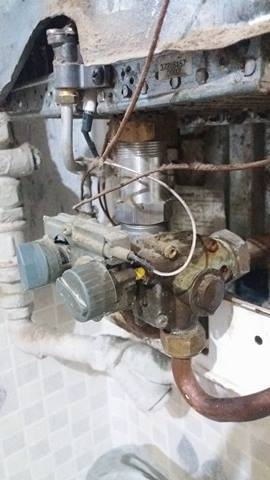

    Hello, two days ago my parents broke down Junkers, probably due to pipe repairs at the estate, plastic filings got into the filter. I just have no idea how to clean them and where they are. Please help! :) Below are photos.
    thank you in advance!

    You should have the filtere pressed into the body of the water unit under the brass cap (the one visible in the photo below).
    After unscrewing, gently release the water shut-off valve to the stove so that something from the tube may still come out.
    Remove the filterer from the body (use a screwdriver, only carefully so as not to damage the strainers), clean and fold.
    In addition, check the aerators in the taps if they are, although you write that the problem is only with hot water pressure, so it should be ok.

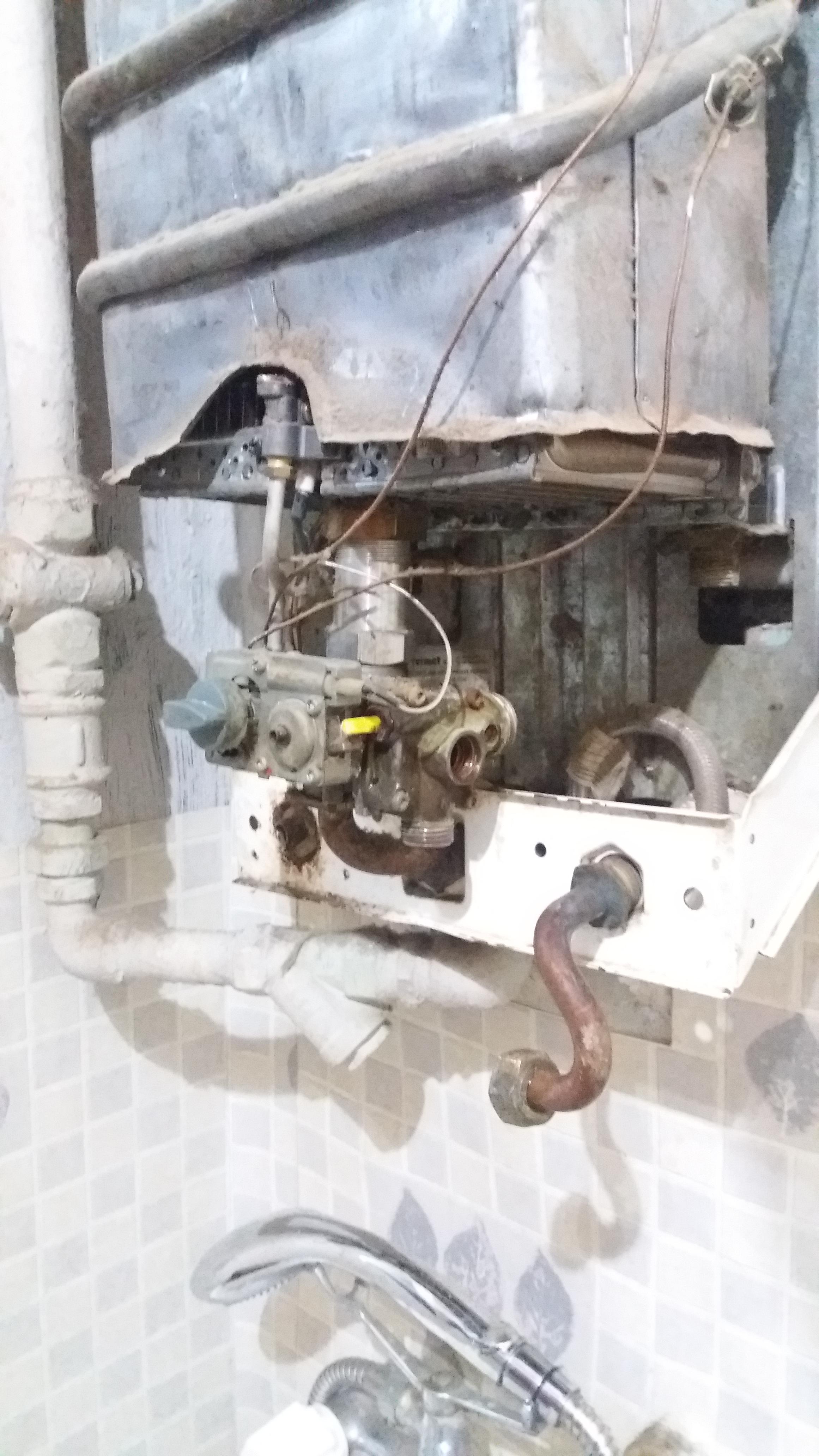

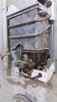

    I turned it off and there are no filters. :(

    Maybe someone removed the filterek.
    Attach this supply tube to the water unit and check that it releases well from the back.
    Then hook under the coil and unplug it at the exit and see the flow.
    You can also look at the valve (flow control). Maybe there's something in it.
    You can unscrew the battery head and see there, and maybe even you had to first: p
