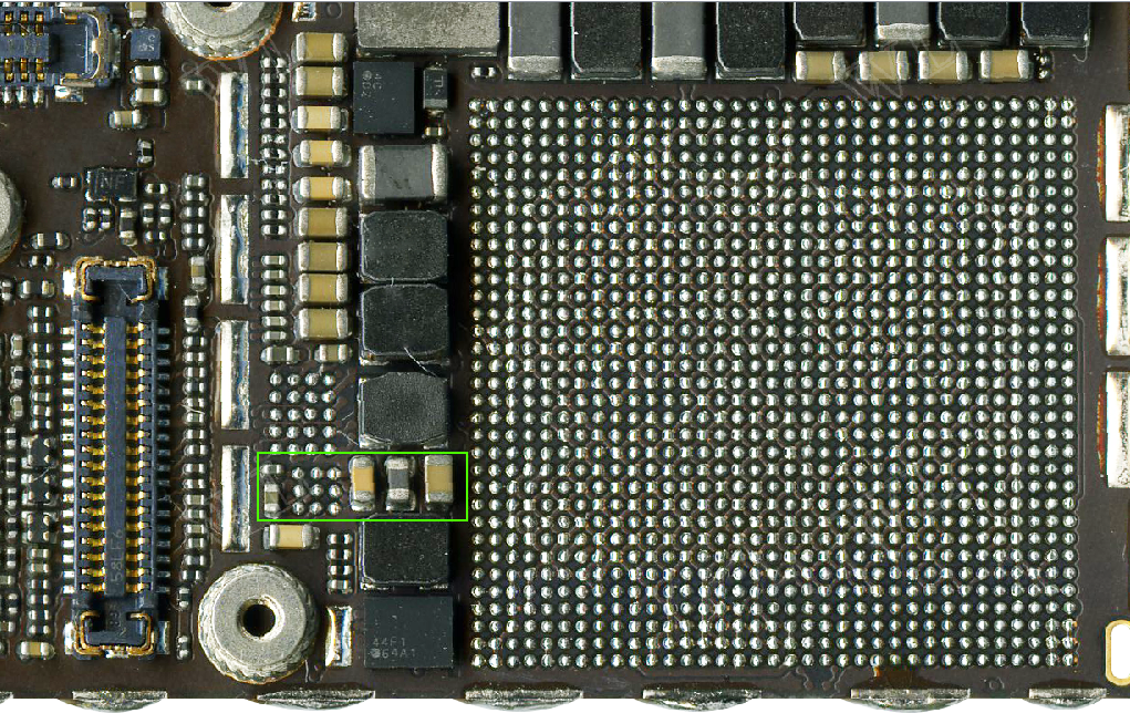

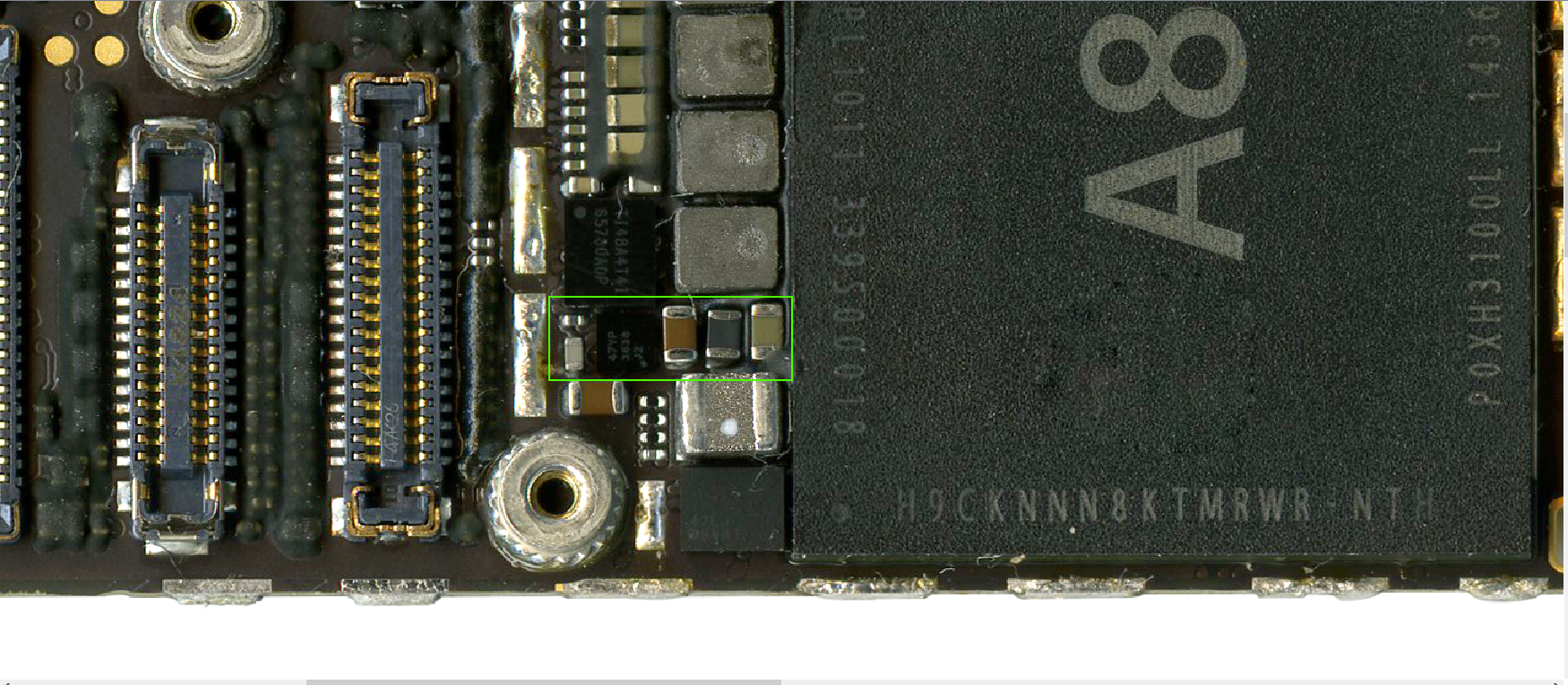

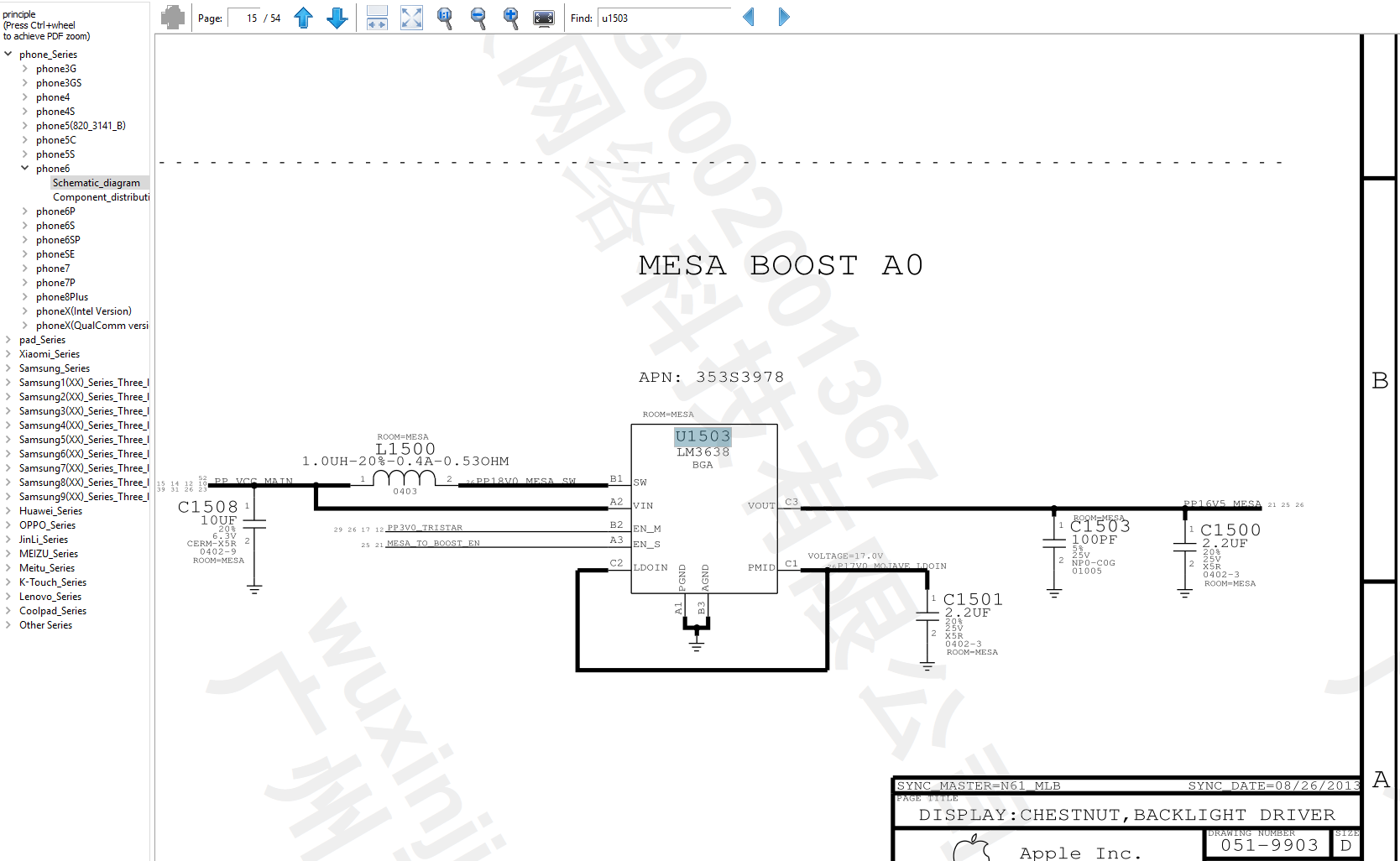

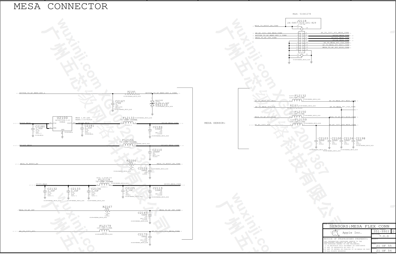

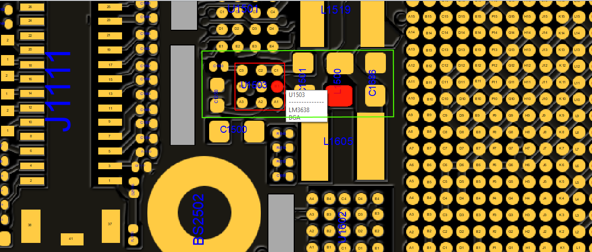

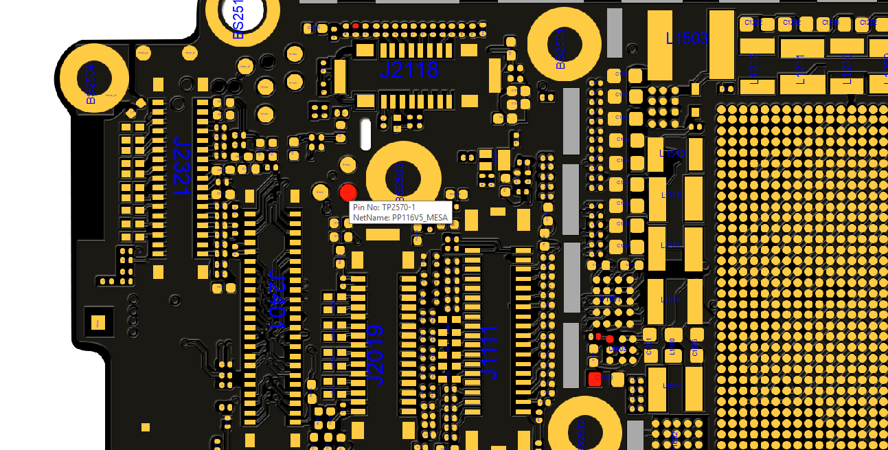

  • #16 17004611
    RafalB
    Level 28  
    Posts: 1110
    Help: 91
    Rate: 222
    Maybe someone else will have problems verifying the damage of the TouchID scanner power supply, the following information will be useful :)
    iPhone 6: Non-operational Post Home Button Replacement - iTunes Safe Mode Detection
    iFixThis
    Łowmiańskiego 18, Poznań, 60-685 | Tel.: 516XXXXXX (Show) | Company Website: https://www.instagram.com/ifixthis.pl/
