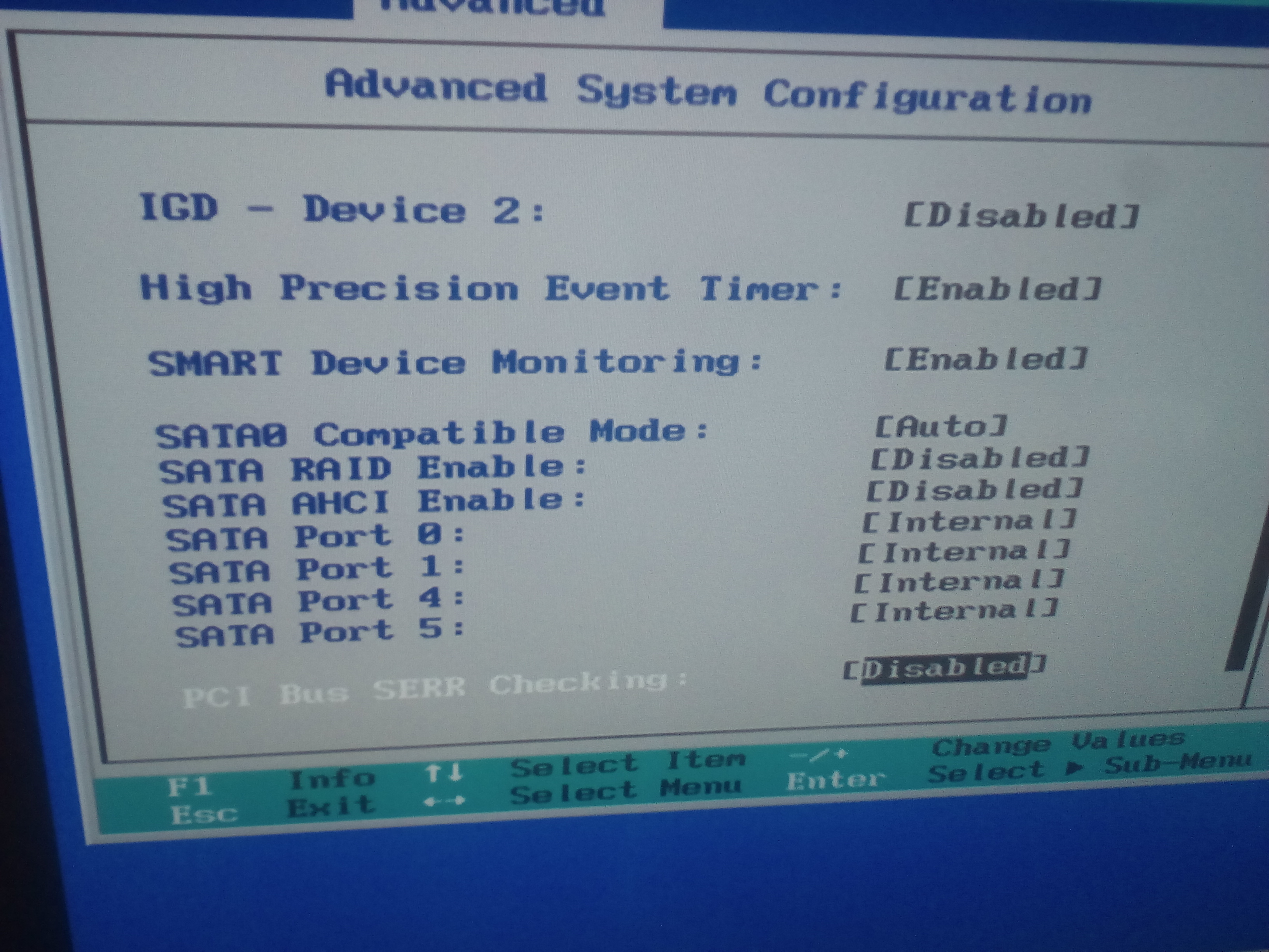

    I have an office computer of some Simens Fujitsu and I do not have an option in bios I have only something like:

    Well, how is it? And "SATA0 Compatible Mode" is what?

    And as for the SATA0 Compatible Mode option
    There is only an Auto or Disabled option
