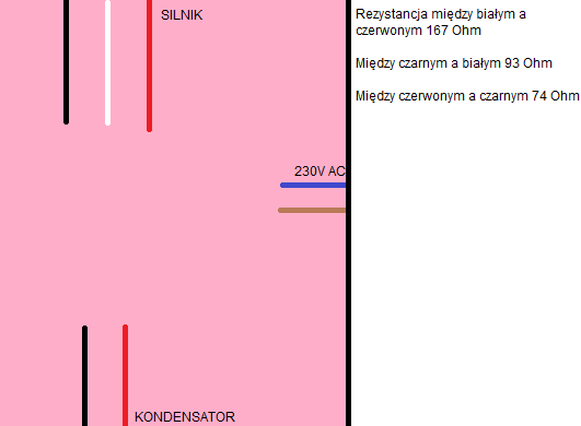

How do I connect this 3-wire single-phase motor to 230 V with a 4 µF capacitor?
Connect any two motor wires to 230 V, and connect the capacitor between one of those two wires and the third free wire [#17140510][#17140542][#16698917] If all three winding resistances are approximately equal, the motor is a reversing type and the rotation direction will depend on which two wires get the mains and where the capacitor is placed [#17140510][#17140542] The capacitor must be a proper motor capacitor with sufficient AC voltage rating; the shown capacitor was rejected because its voltage on this connection would be around 300 VAC [#17140578] The original capacitor from the typewriter worked with this motor [#17142053]

    Please help. The capacitor is CBB61 4uF. I am sending a picture with R measurements
    Single-phase motor 100 W - 3 wires how to connect a capacitor and to the network
    #2 16698917
    janek5555
    Posts: 18
    Rate: 12
    Capacitor between white and red, red and black under 230V.

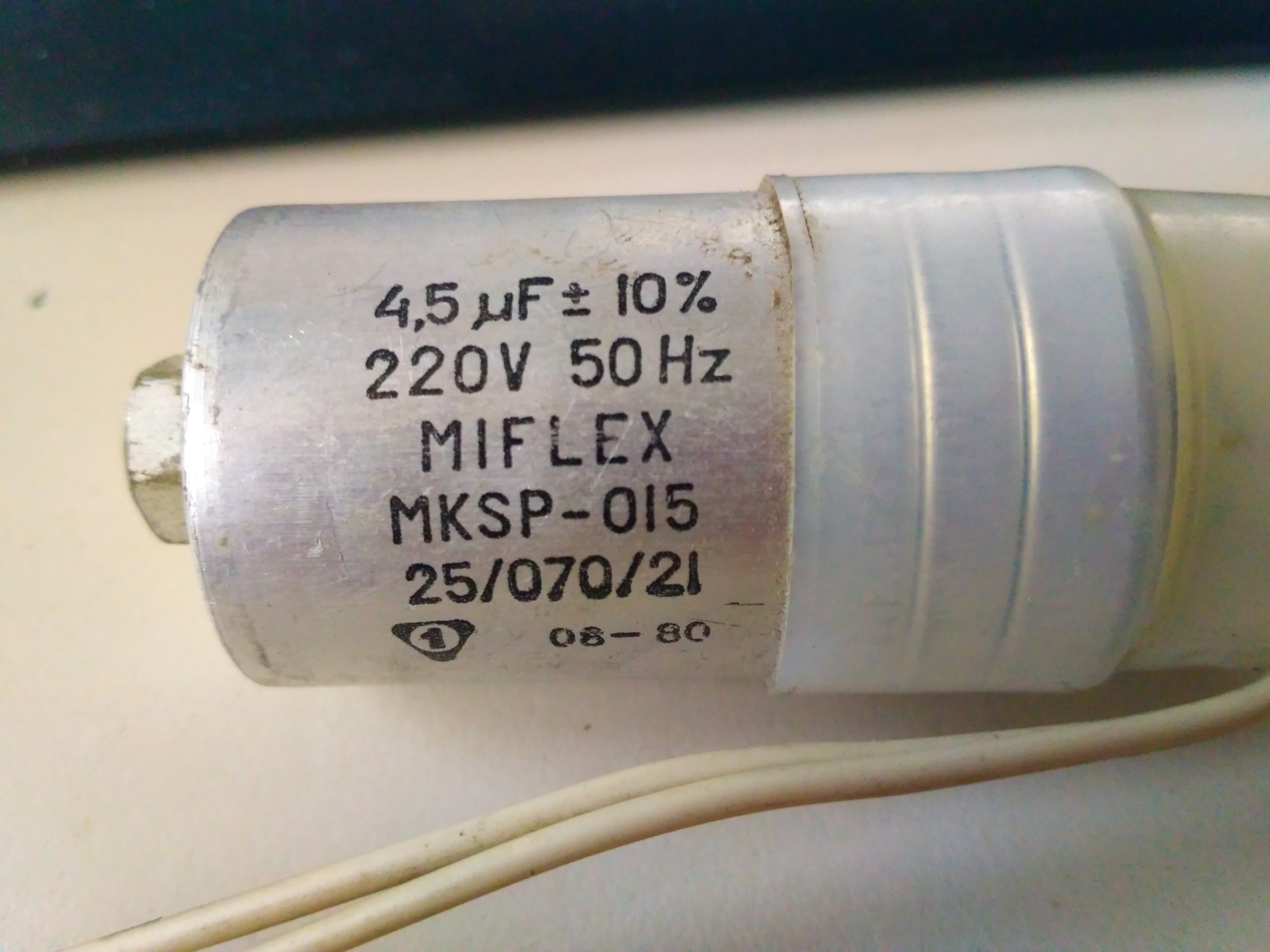

    I have such a capacitor. May be?

    Can not! because the voltage on it will be around 300 VAC. On the first photo you have the right one.
  • #9 17140583
    grzegorz.bk
    Posts: 9
    Rate: 16
    Thank you very much for your help. In that case I will buy the right one and go back to testing. Regards.

    It worked. I got the original capacitor that worked with this engine in a typewriter. :)
