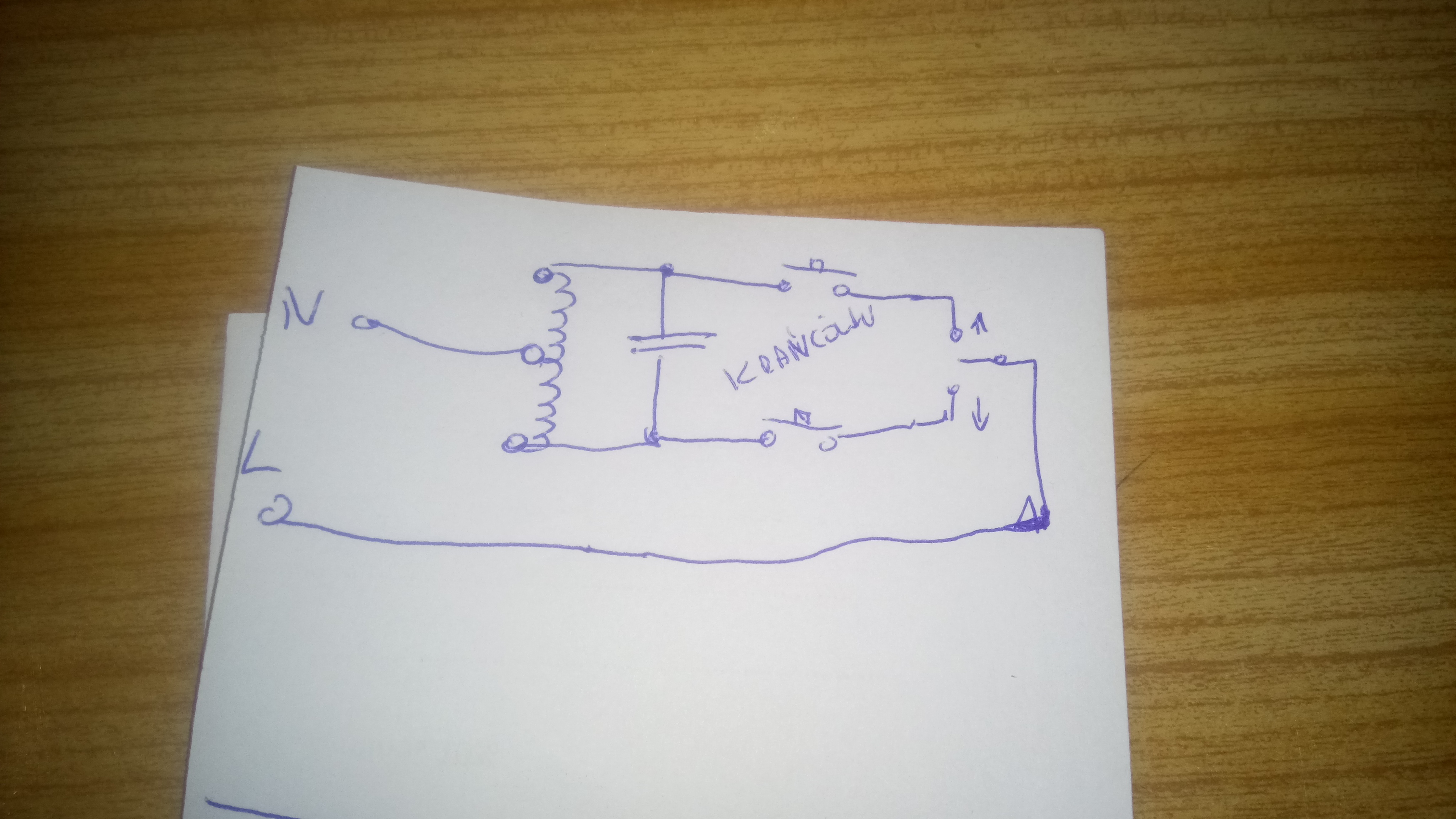

    I am converting the manual control system of electric winches with single-phase motors to automatic (2 contactors per motor - you need to change the direction of rotation). As the motors will be about 30-40m away from the electrical cabinet each, I decided to lead them to them with a four-wire cable (for each tap), and leave the starting capacitors in the cabinet by the contactors.
    I realize that the starting capacitors should be connected as close to the motors as possible, in fact the only alternative I see now is to leave the starting capacitor permanently connected with one terminal to Z1 and the other one will be on the wire going to the cabinet. What do you think about it?

    What kind of winches are they? Recently, today I put four of them on the control from one place ? and the capacitors were built in the remote controls. It controls three wires and I installed the capacitors at the motors.

    They are to be typically Chinese winches with 0.5kW single-phase motors (specifically DWI 125 / 250kg 230V). I need to control six such motors from one control cabinet while maintaining the ability to control directions.
    Maybe a colleague to explain the control method? My colleague left the power cord and replaced it only a switch or all the wires from the engine go to the control panel?

    Everything goes to the headquarters. Neutral, two phase (top / bottom) and protective. A little later I will paste the diagram.

    It's like - will a friend send a diagram? :) I have already drawn the control for the motor with two identical windings, but from what I found out, these motors have a starting winding with a higher resistance.

    They have the same. Common to N, capacitor to extreme. Krancowki in series. I will paste the diagram in a moment. Honestly, I forgot ...

    The motors have the same windings. My colleague's diagram came in handy. Problem solved - thank you for your help and I'm closing the thread! :)
