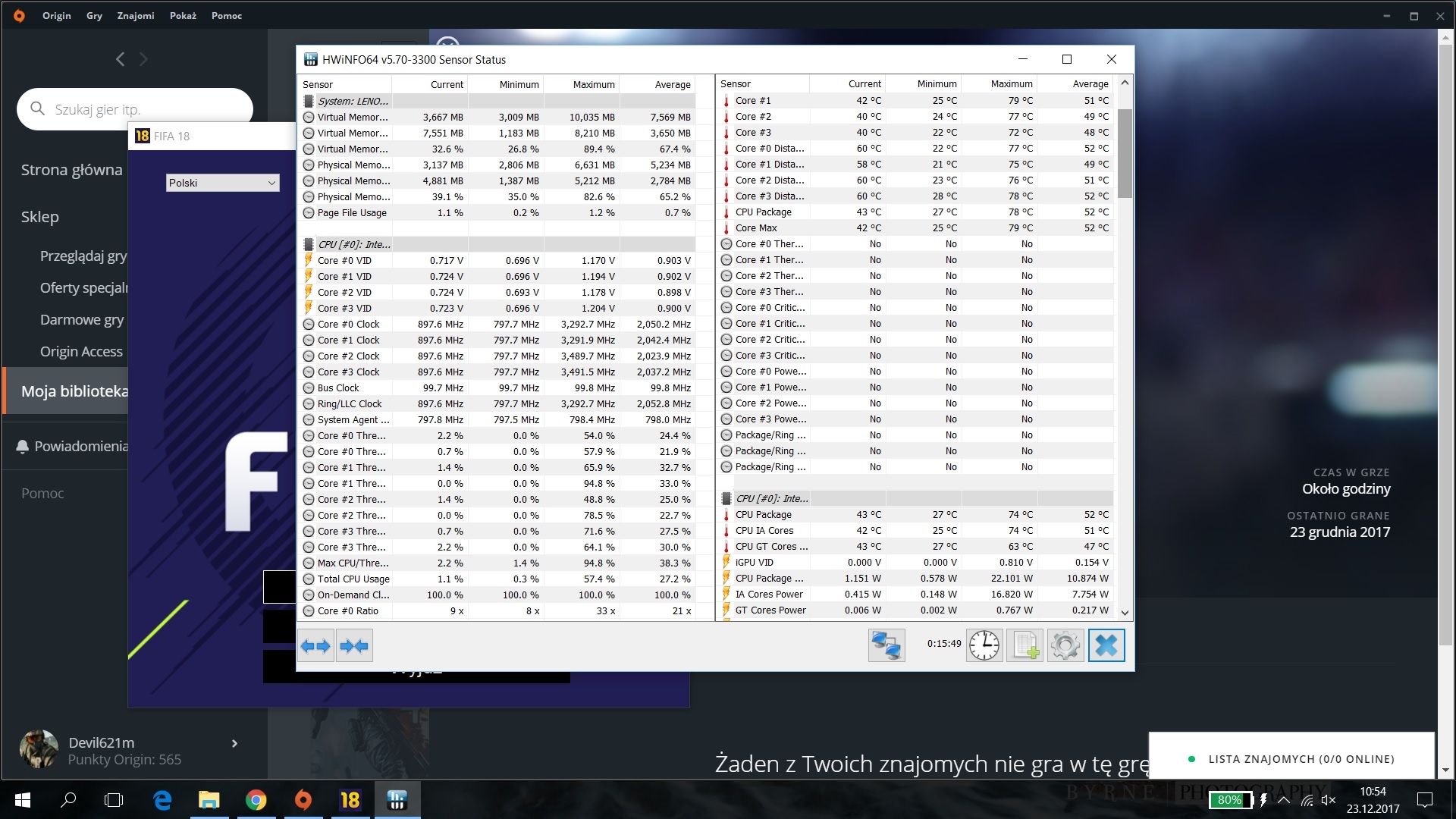

    This is the temp while playing for a little over 5 minutes (of course, it also stuttered) - I also noticed that the fans do not work at high speed when playing games. Maybe it's because components are burning up and there are stings.

    dawid456ug wrote:
    Here's the temp
    "Here" is the top section of HWi. Post the whole. There are blue arrows to add columns.

    enhanced wrote:
    Since the demo was the same, it is not a configuration for an ultra-simple matter.
    As I wrote - you can see the residual HWi results, we do not know the load of the GPU, but the CPU is not heavily loaded.
    You have to check the settings in the game itself. @ dawid456ug post screenshots with settings - including V-sync and frame limiter. Turn on the normal details.
    It can put a movie with those jams because we do not know how they look exactly.
    Maybe it's some minimal pruning from the fault of another subassembly.
    I bet on poorly optimized game code.

    It helped replace the disk from the disk on the ssd now the game goes perfectly, thanks to everyone for the willingness to help.
