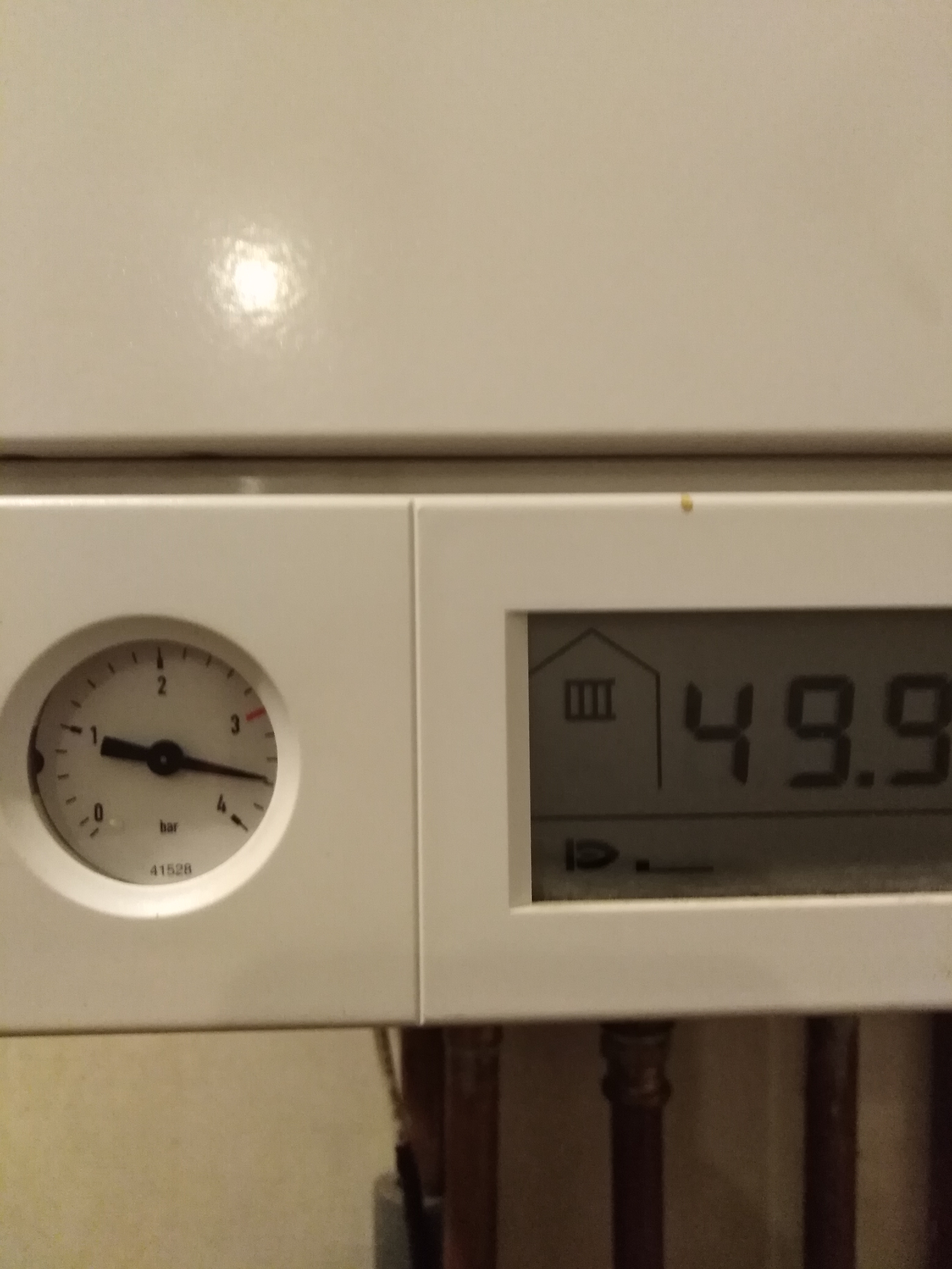

    For about half a year I have been observing cyclical pressure drop in the central heating installation. Today I decided to check the pressure in the diaphragm vessel out of curiosity. I unscrewed the jumper cap, connected the manometer and instead of measuring half a liter of water fell out of the valve (the valve hung after pressing). I barely turned it on, it just crumbled. I cleaned the internal thread, installed a new car vent, inflated the air, but ...
    Well, should the water in this vessel be mixed with air, or has the membrane broken? The furnace is only 2 years old, inspections were carried out, except for the motherboard that had fallen once :D he didn't cause any problems.
    If it is necessary to replace it, can I buy such a diaphragm vessel myself? The exchange looks very easy.
    Thanks in advance for your help.

    When the water flew it is damaged.
    You can buy and put on the dish yourself but you will not receive a guarantee for it.
    You live in an apartment or at home. Where is the boiler installed?

    So, for exchange ... I found such a dish in an online store for 390 PLN, the Vissmann part number is 7837231 (maybe someone will use it), the link is intentionally not given.
    I live in a house, a boiler in the bathroom. Does it matter in this situation? ;)
    Can using the vessel in its current condition cause any problems? Will the air mix with water and spread throughout the entire installation?
    During heating, the pressure in the system may jump to 3 bar and the boiler safety valve will open. As you know, water increases in volume as the temperature rises.
    You do not need to buy the original dish. In the basement or other storage room you install a universal diaphragm vessel with a volume not less than what you have installed in the boiler. Of course, the pipe from what the principle of operation will be exactly the same as that built into the boiler.

    I come back with some news. I was able to replace the diaphragm vessel, I do not throw any pictures because it is screwed with only one nut from the top of the furnace, 10 mm. Replacement is trivial, a bit westerly with draining the furnace water (only the furnace, not the installation) and subsequent filling + venting. I checked out of curiosity, the new one has exactly 1.0 bar inside. Oddly enough, the old one after disassembly was also some residual pressure, despite the fact that water was pouring from the valve, and during the last tests I pumped up to 1 bar. I conclude that the leak was "half", but as it is technically resolved - I have no idea.
    400 PLN back and an hour of work.

    Hello, there is a problem with the boiler, it shows me 3.6bam Vitodens 100-W W1 B1C Expansion Vessel Issues: Pressure Drop, Water Leak, & Membrane Replacement
    Where is the pot in the boiler with behind the bag. Is the cause of such high pressure a damaged vessel? I will add that he will use the boiler from yesterday.
