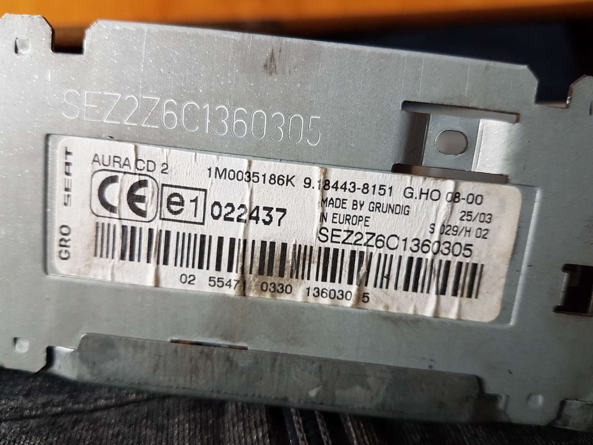

    Hello, is anyone able to prepare a batch for this radio to set the code to 1000? Unfortunately, I did not find anything on the net on this topic - and I know that there is certainly a spec in the forum for which it would be a piece of cake.
    Radio: Grundig SEZ2Z6
    • Grundig SEZ2Z6 Radio: Batch Preparation for Setting Seat Aura CD 2 Code to 1000 Aura CD 220180325_154750..jpg (250.09 KB) You must be logged in to download this attachment.

    Load the memory (bin) of your radio.

    Enter the Menu (Pty / Prog) and you can make the code inactive.

    I did not find this option: / Maybe I'm looking wrong or need to hold something?

    Hold down longer and select the correct setting to be modified. I don't remember if he writes SAFE or CODE.

    If I hold it down, I write SAFE and I have to enter numbers - I enter the believing code, I hold PTY / PROG and the radio is still asking for the code

    1. Enter the code to start the radio.
    2. The radio works.
    3. With the radio on, press and hold the Pty / Prog key. I go to the menu. I am looking for an option to disable the code - I write Safe or Code (I don't remember - rather Safe) and I enter it.
    4. I am entering the correct code. The displayed text changes from - Safe to Code.
    5. The code is inactive.
