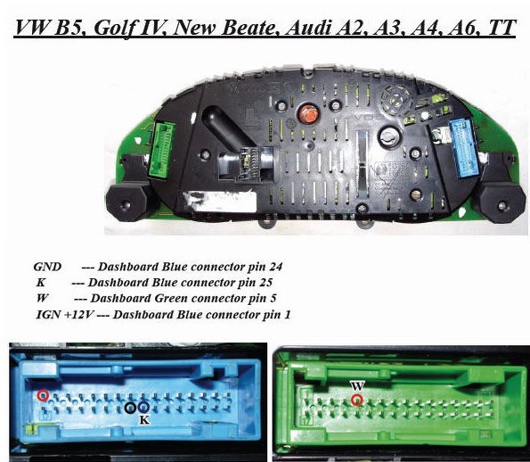

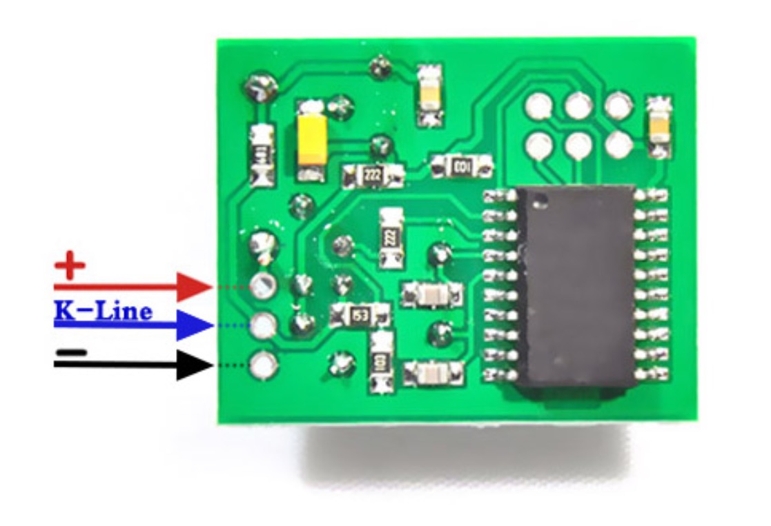

    My colleague lost the transponder from the key of his car and I can not run it so I bought an emulator but I have a problem with the connection Line K and Lini W the best drawn diagram will help me mase and zapo I know how to connect under which pins in the meter I have described but I can not understand description heh, please help in black and thank you very much for all the responses I greet Bartosz Emulator IMMO VW Golf IV 2002 - How to connect Emulator Immo golf IV 2002IMG_67..JPG (127.27 kB)You must be logged in to download this attachment.

    What do you not understand here?
    The emulator has 3 wires.
    You connect the red cable to the plus after the ignition, ie pin 1 of the blue plug of the meter.
    You connect the black one under the minus or for example 24 pi of the blue counter of the meter counter.
    Blue - you cut off the wire from the W line of the meter, or pin 5 of the green plug. You now have two ends of the wire. One goes to the meter and the other to the beam under the dashboard. Under the wire that goes into the bundle in the board, you connect the blue wire of the emulator.
    The other end of the cable that has been cut (the one that goes to the meter on pin 5 of the green plug) is insulated and you forget about it.
    The car should start.
    After this procedure there will be no communication with the engine control unit.
    You can try to connect the wire from the blue connector, pin 25 to the blue wire of the emulator and with that cut off what goes into the beam.
    It should be possible to diagnose the engine after this.
    You will see a light on the meter.
