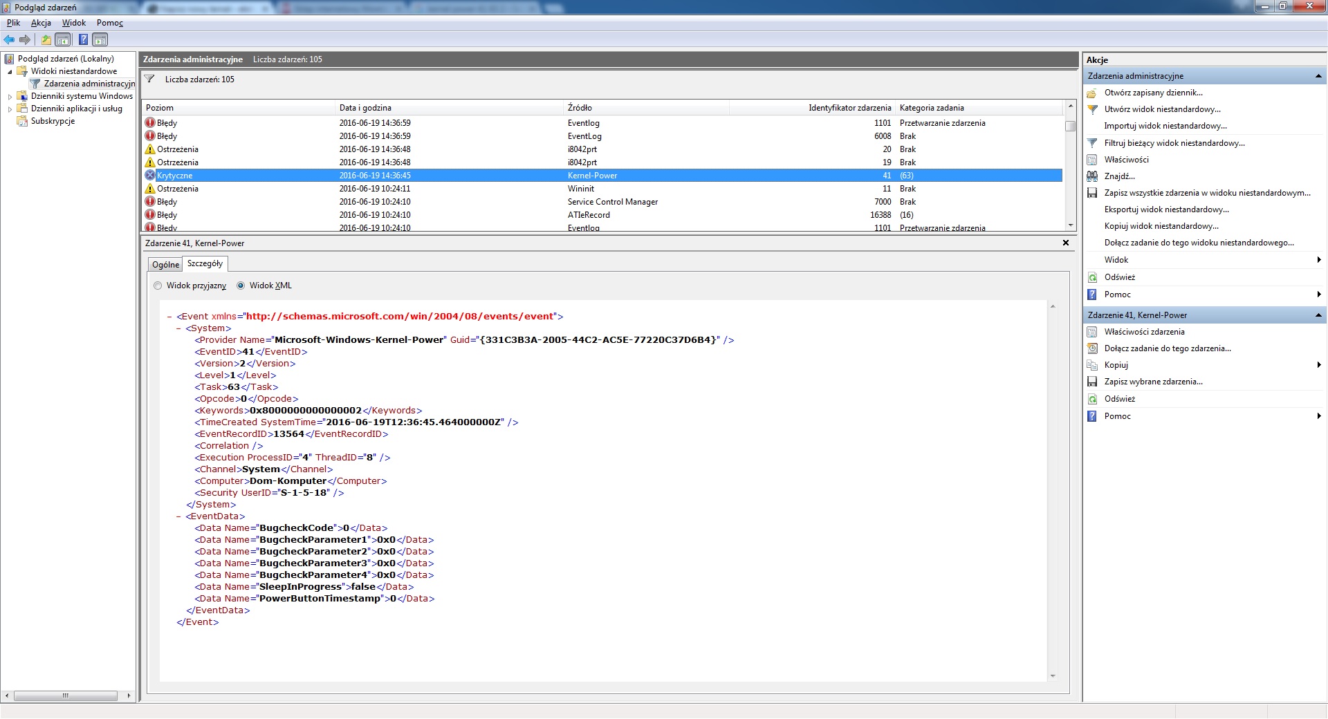

    Hello, I have a computer problem. The computer is new, bought about a month ago. The computer randomly sometimes while playing, sometimes when browsing the internet it starts making a strange noise, the screen goes black and all I can do is turn off the power button and then turn it back on. This happens 3-5 times a day.
    MSI B150M Mortar motherboard
    Intel Core i5-6500 processor
    Sapphire AMD Radeon R9 380 NITRO OC 4GB graphics card
    SilentiumPC Vero M1 600W 80Plus power supply
    Memory Mushkin Blackline DDR4, 8GB, 2400MHz, CL15
    Samsung SH-224FB drive
    Seagate 1TB, SATAIII, 7200RPM, 64MB cache drive
    Windows 7 64 bit
    All drivers updated, bios too. I also tried windows 8 and it continues the same. The Kernel-Power 41 (63) error always appears in the windows event log after such a restart. After installing a different version of the drivers for the graphics card, I thought the problem was solved because it was not present for about a week, but yesterday the problem reappeared during the game and then while browsing the internet. I did the memtest86 + ram test and it did not detect anything.

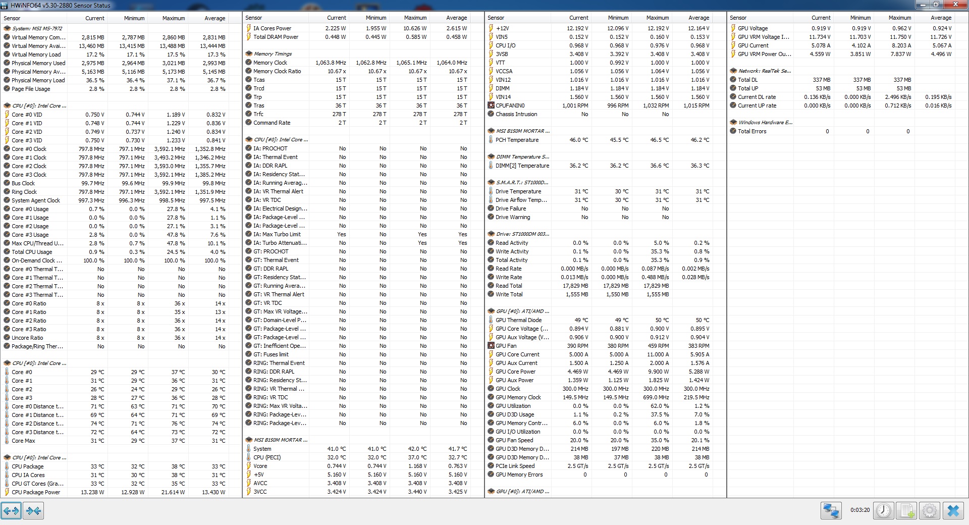

    Define the sound and describe where it comes from. Maybe it's overheating?

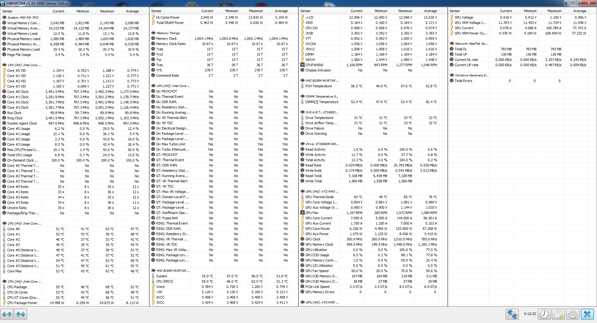

    Screen from HWiNFO "sensor only" mode show as many parameters as possible.

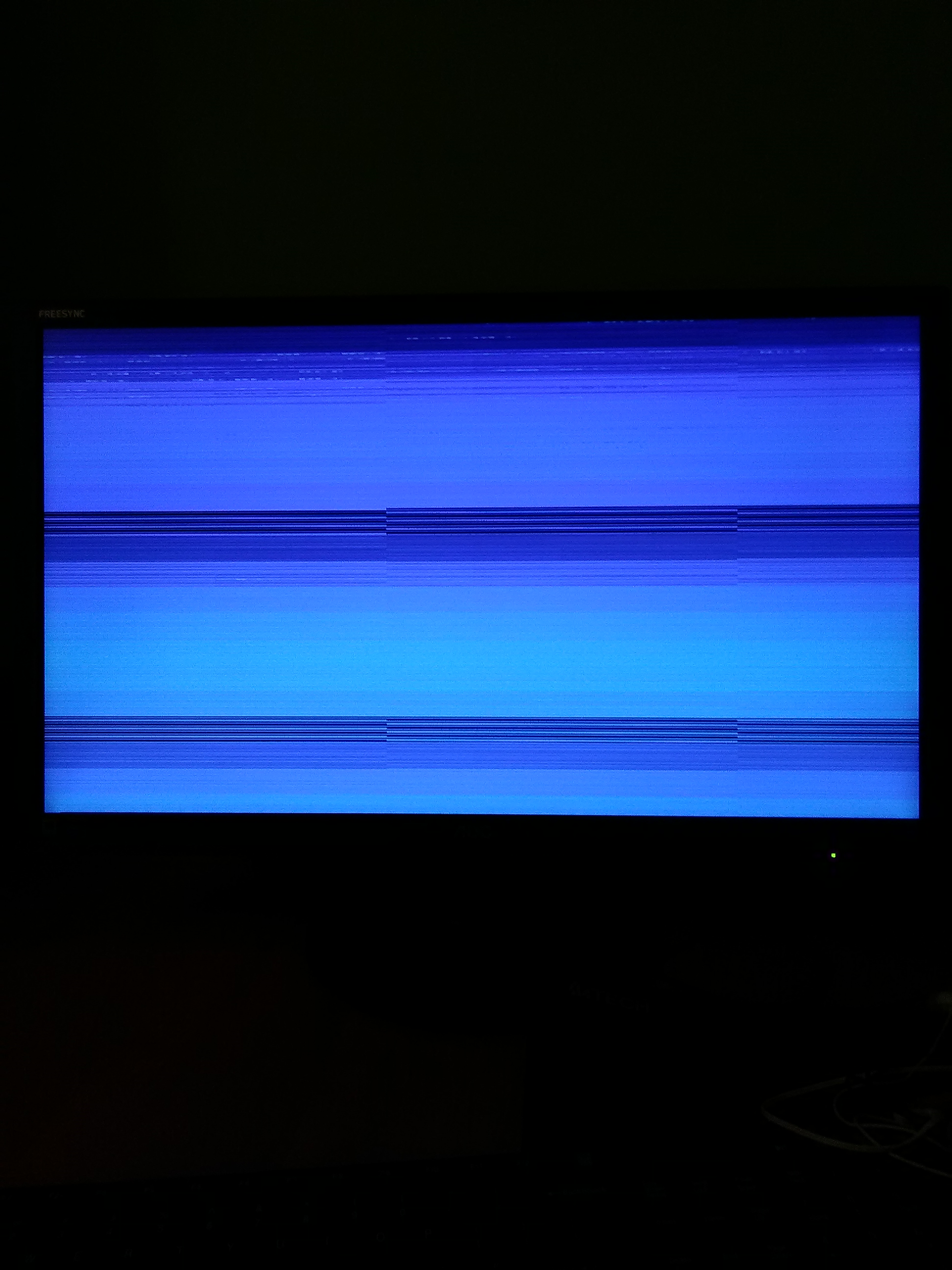

  • #4 15755709
    realek
    Posts: 14
    The sound doesn't come from inside the computer, it just jams and you can hear a drill, something like that. In foreign forums they say this is freezing / buzzing sound.

    310artur
    Posts: 9002
    Help: 980
    Rate: 670
    Temperatures at rest are fine outside of the graphics card. Of course, it's hard to judge at no-load temperatures. Perhaps this is how he has a cooling profile written down that he works quietly "agreeing" to 50 degrees at rest.
    I suggest a graphics card test. You can choose - OCCT and GPU test or Furmark and test there. Anyway, keep HWiNFO (sensor only) open in the background and after a 10-15 minute test show the HWiNFO screen.

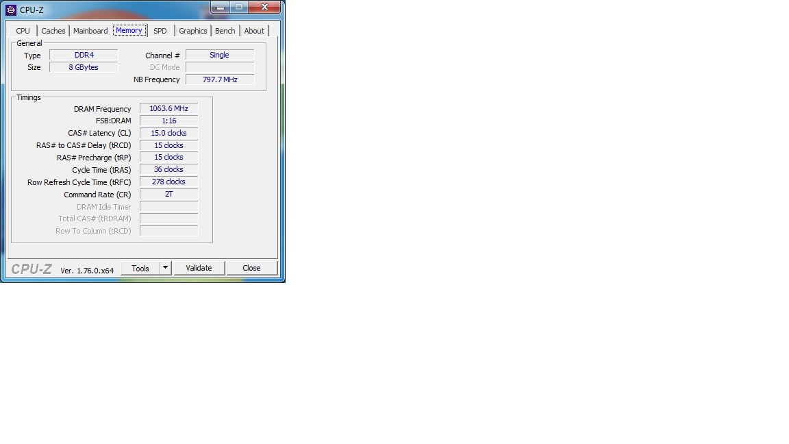

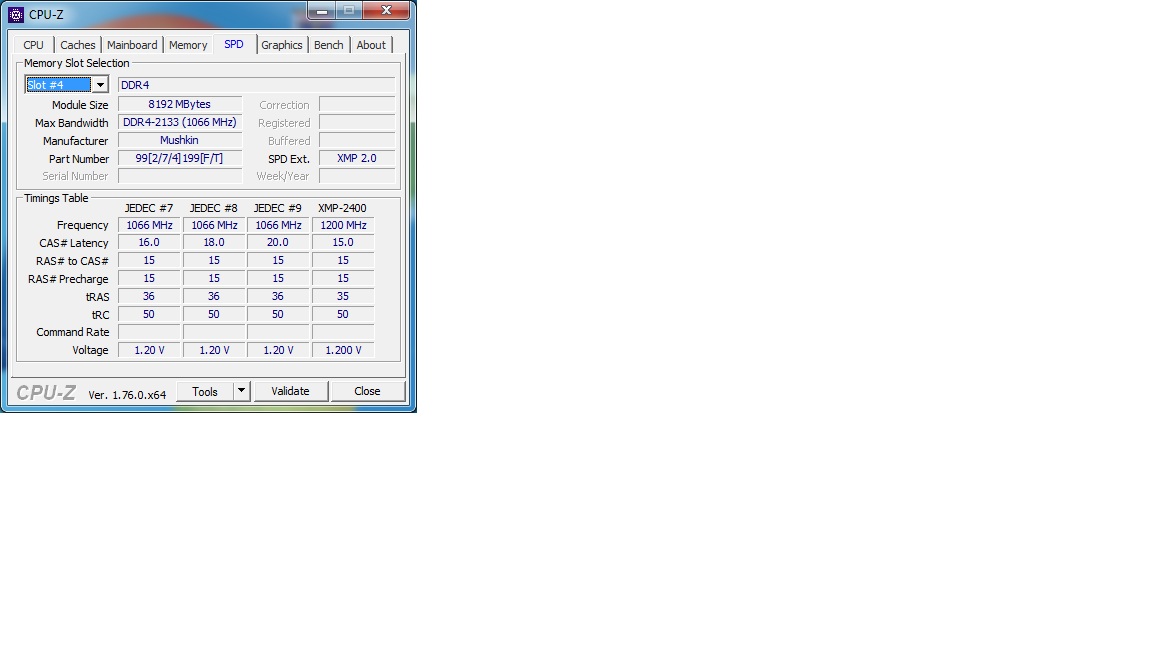

  • #12 15761741
    realek
    Posts: 14
    Screeny memory i spd
    New Computer Random Restart: MSI B150M, Intel Core i5-6500, Radeon R9 380, Kernel-Power 41 (63)
  • #13 15761836
    310artur
    Posts: 9002
    Help: 980
    Rate: 670
    I think they should work like that, but I don't know much about DDR4. To be sure, you can raise them CL to 20 and repeat the test. Basically, however, I do not expect the result to be different.

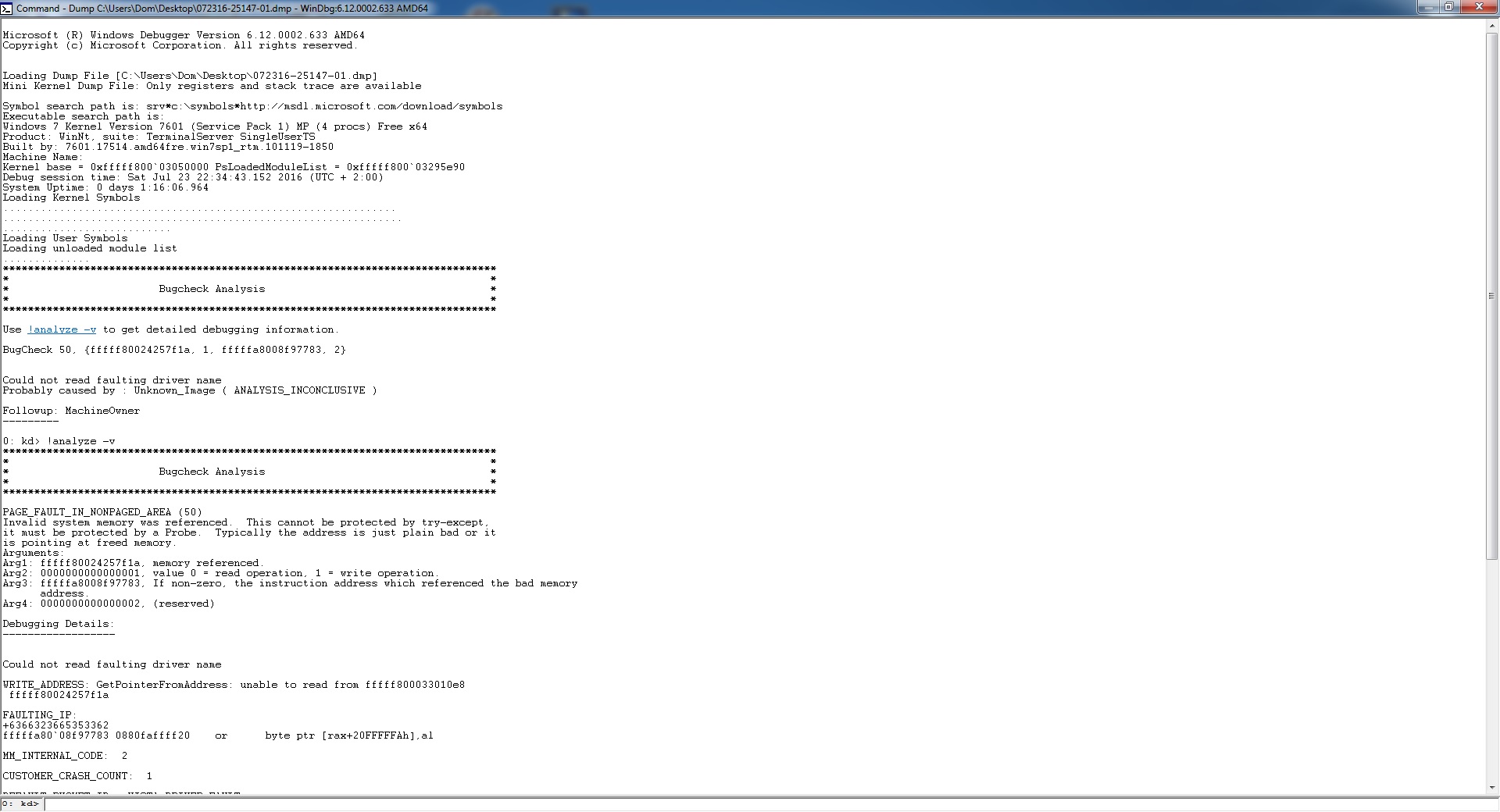

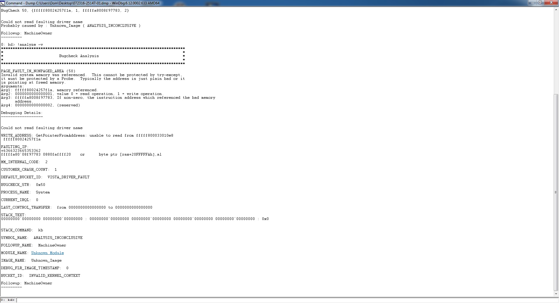

    Added after 1 [hours] 13 [minutes]:
    My new memory is not listed in the compatibility list on the motherboard page. A moment ago there was a problem again while shutting down the computer. After pressing close, after a few seconds, blue stripes appeared on the screen (photo in the attachment) and the computer would not turn off. The hard drive LED on the case has gone out. When I started the computer, the fans on the motherboard were spinning, but not on the graphics card. I am also sending the windbg report.
    • New Computer Random Restart: MSI B150M, Intel Core i5-6500, Radeon R9 380, Kernel-Power 41 (63) winddbg2.jpg (243.53 KB) You must be logged in to download this attachment.
    • New Computer Random Restart: MSI B150M, Intel Core i5-6500, Radeon R9 380, Kernel-Power 41 (63) IMG_20160723_223600.jpg (1.23 MB) You must be logged in to download this attachment.
    • New Computer Random Restart: MSI B150M, Intel Core i5-6500, Radeon R9 380, Kernel-Power 41 (63) windbg1.jpg (293.43 KB) You must be logged in to download this attachment.
  • #18 15826304
    310artur
    Posts: 9002
    Help: 980
    Rate: 670
    BS sees most often at unstable TPL. But with you nothing is turned up. I have no idea what else to look for.
