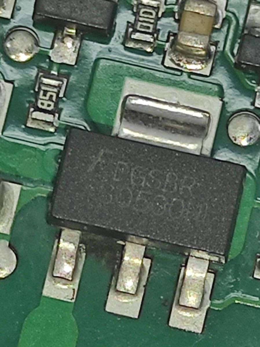

    This is what a damaged tile looks like. Probably a transistor from the converter marked 1011B. I don`t know what was in the front because there is a hole.
    RMW marking at the top.

    I`m not sure, but it could be this chip:
    www.onsemi.com/pub/Collateral/NCP1010-D.PDF

    No, that`s not it. In the original version, Pin 3 receives Vin 320V behind the rectifier.

    I have: fsq500hl

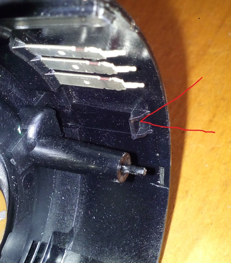

    How to get to the pump electronics? How to disassemble it without damaging it?
    The red body fits tightly with the black element and I don`t know how to disassemble it.

    I have marked in red the places where the hooks holding this "cover" are located. Only this pump is a slightly different model, but probably put together in the same way.
