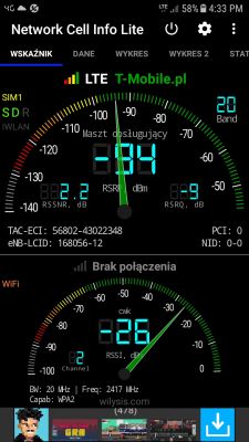

    As in the topic I need a good external antenna for this router. I live in Mystków / I prefer to connect with the LTE800 transmitter I see from the window but the speeds are poor now: 8down and 17 up at night better. When the rooftop exhibition catches mine 1800 from the shadowy one, I will add that there are no antennae tightened, and something out there on 2,100 and 2,600 with a new filter, as shown in the screenshots.
    Which antenna would be the best in this case.

    marszalek1989 wrote:
    I can see the transmitter from the window but the speed is poor now: 8down and 17 up at night better
    Remember that you have 30 DAYS OF TEST in this offer, for free, for everyone, also at stationary points.
    The speed you have is good, it's normal LTE speeds. If you take out the average, it will come out so much that ho ho. For example, I used to play 1 Mb / s in the evening, 30 Mb / s in the evening, and a daily average of 15 Mb / s. 100 lucky people will do so with 200 Mb / s ...
    Important how real. The LTE market is a poor compared to TV antennas. In theory, it would be best to have a good antenna / antenna at 1800 and 2600 and select the aggregation of these bands. I wish you good luck in searching. Only 1800 has a lot of good antennas to choose from like Cybertech, but you can not guarantee that there will be higher speeds. The only option is to go to the transmitter in the evening with a telephone and do tests.

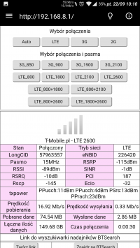

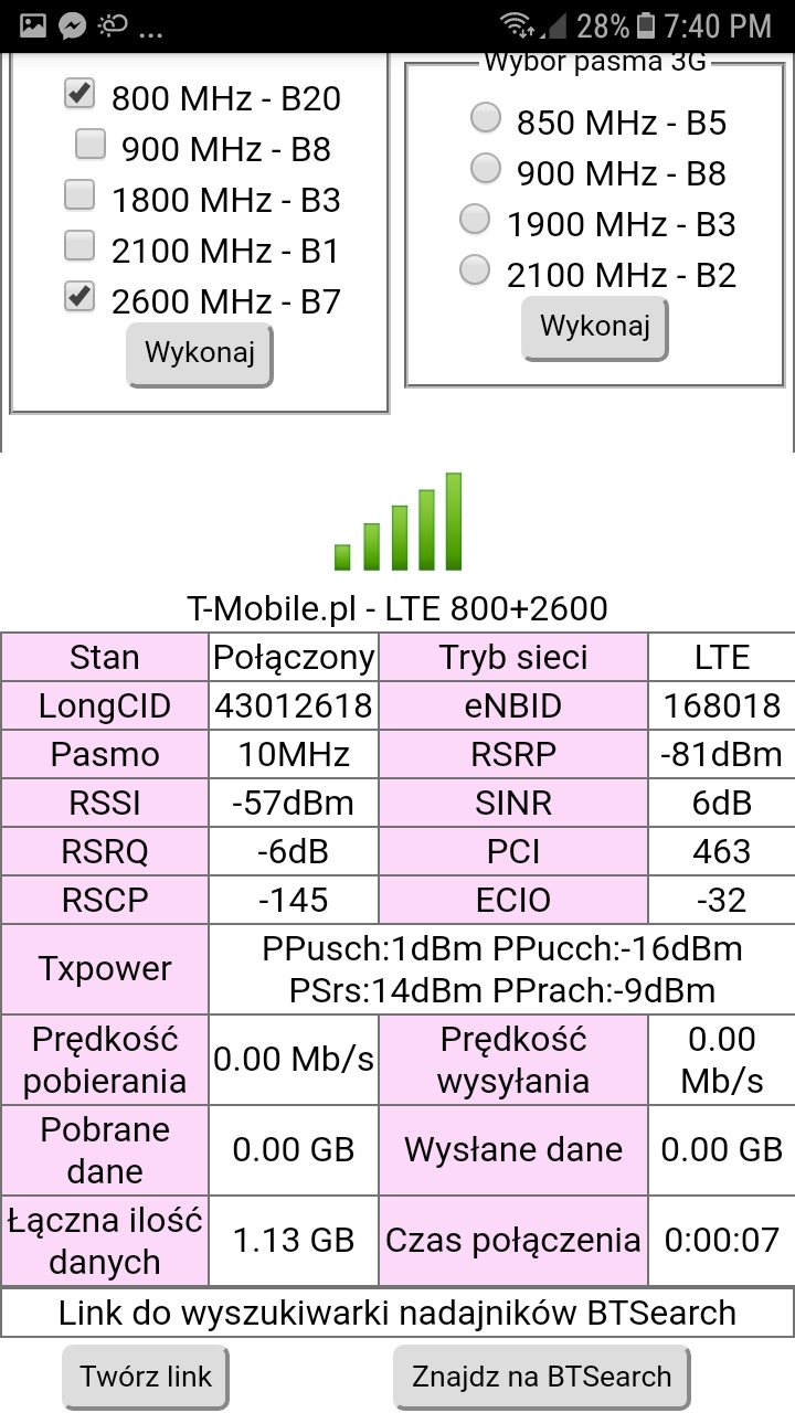

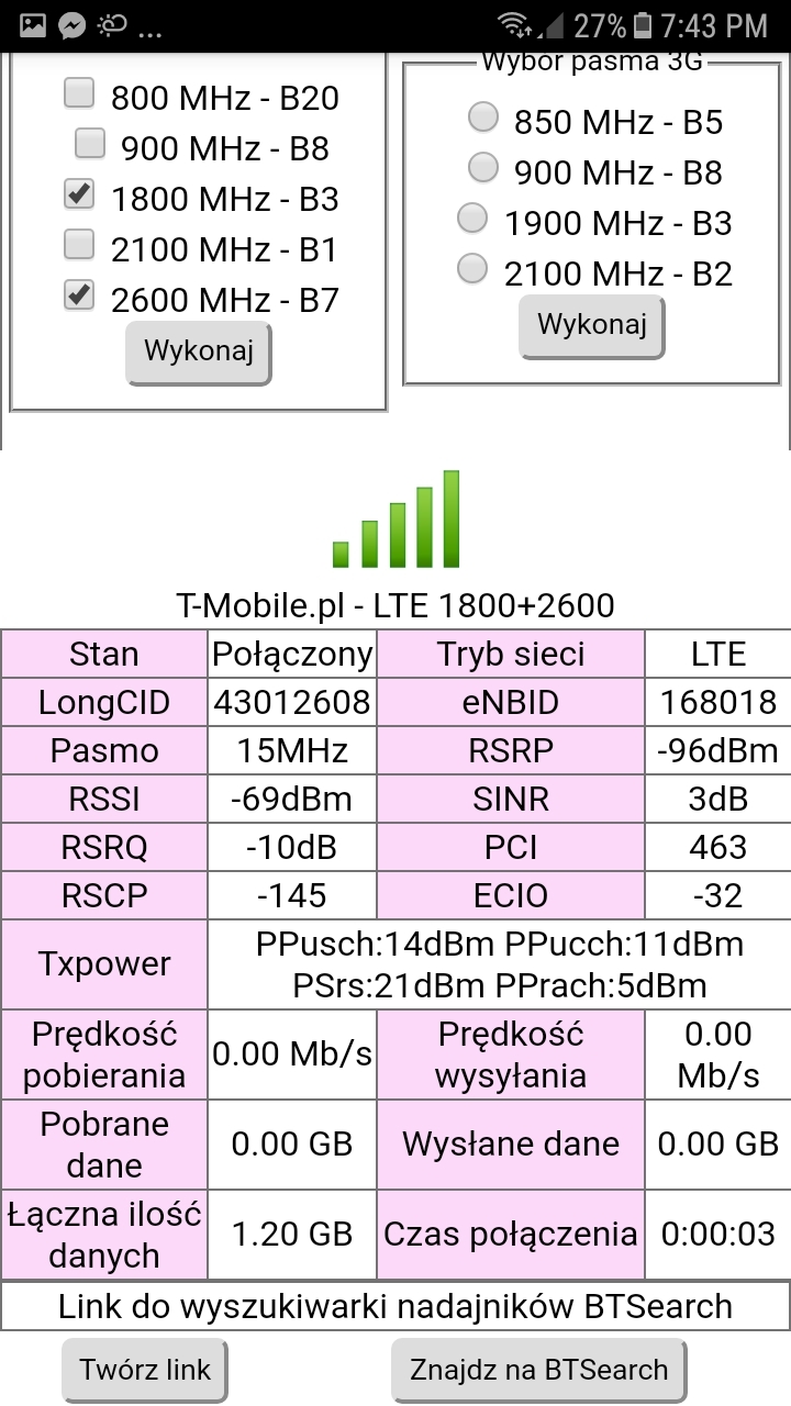

  • #8 17589854
    cfirek
    Posts: 21

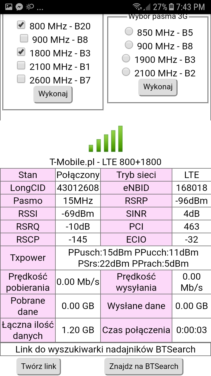

    It will kind of rejuvenate the old chop, but it's practically identical, namely I took the Internet home from T-Mobile to 60Mb / s for the trial period. I was provided with a router without antennas, would it be anything else to change at my own expense? If so, what do you recommend?

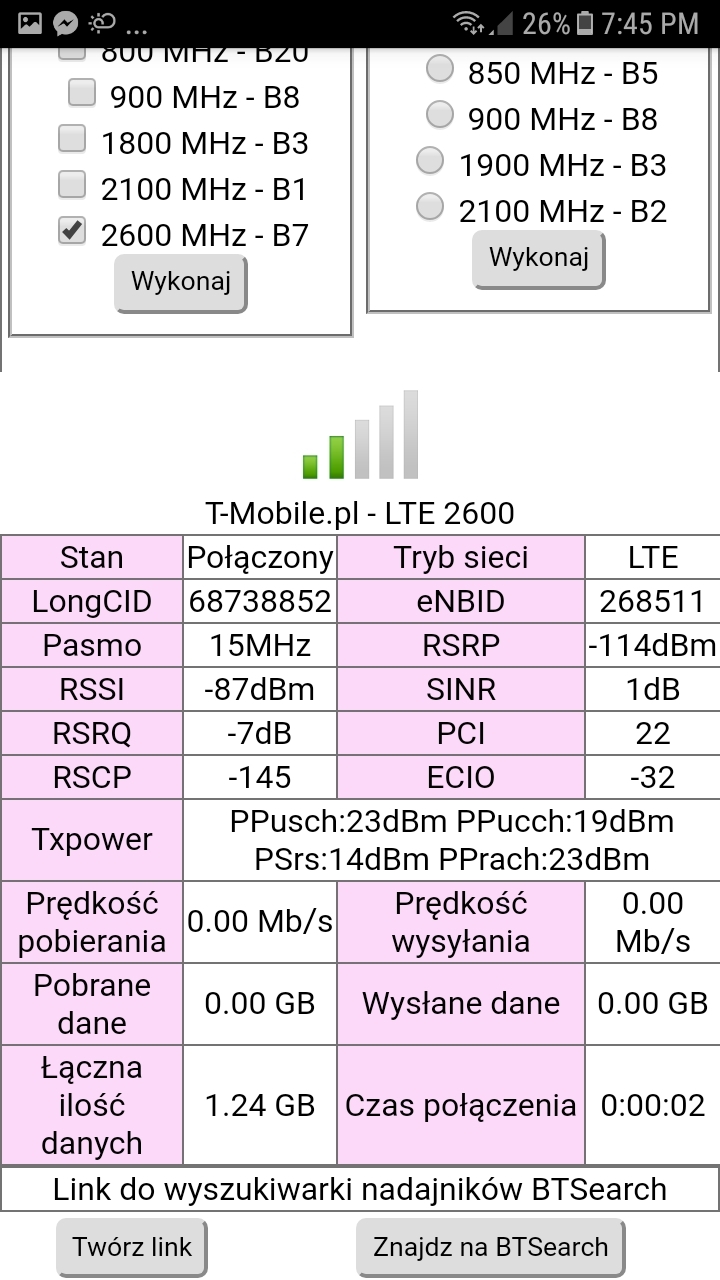

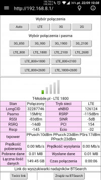

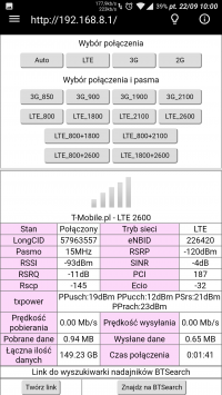

    The router is in the attic and its destination will be there. I live in the village of Przedmoście near Glogów in the province Lower Silesia. Below are screenshots from each of the HManager configurations.
    Selecting the Best External Antenna for Huawei B525 Router - LTE800 Transmitter Selecting the Best External Antenna for Huawei B525 Router - LTE800 Transmitter Selecting the Best External Antenna for Huawei B525 Router - LTE800 Transmitter Selecting the Best External Antenna for Huawei B525 Router - LTE800 Transmitter Selecting the Best External Antenna for Huawei B525 Router - LTE800 Transmitter Selecting the Best External Antenna for Huawei B525 Router - LTE800 Transmitter Selecting the Best External Antenna for Huawei B525 Router - LTE800 Transmitter

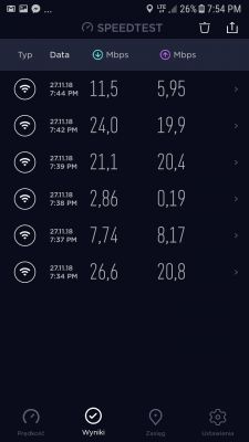

    When it comes to speedtest, it's made in advance:
    1800 + 2600
    800 + 2600
    + 800 1800
    2600
    1800
    800
    Please, let me know if it is worth keeping 60Mb / s and if I can improve anything, because it provides Netflix in 4K.
  • #9 17590046
    matek451
    Posts: 31251
    Help: 4352
    Rate: 5808
    The LTE800 T-Mobile works best with BTS Rudnowska 75, the correct signal on it is also slightly overloaded LTE1800NetWorks with sufficient signal, LTE1800 + 800 aggregation with it did not turn on. LTE2600 from BTS at Skarga 25, so low and low speed. On the BTS, also LTE1`800, but aggregation from it to LTE2600 + 1800 did not work. You can not achieve anything more on LTE800. Aggregation LTE1800 + 800 from Rudnowska rather does not work and LTE1800 also does not kidnap.
  • #10 17590122
    cfirek
    Posts: 21

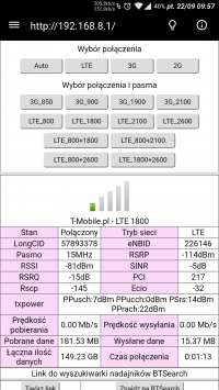

    Okay, that's the best LTE 800, and I set it up as well. Is it possible to mount antennas for whatever it gives me? If so, what to mount? Possibly, can I do something else? I am beginning to consider either reducing the package or, in general, giving up and searching for something else ...

    At LTE800, you probably do not get too much. Improvement of the LTE1800 signal should accelerate something, but it costs about PLN 300 for broadband antennas at 800-2600MHz. You will also improve the LTE2600 signal on them, it may surprise the LTE2600 + 1800 aggregation from the complaint but it is difficult to predict how it will translate into speed. If you had an Android phone and Network cell Info application under BTS on Rudnowska and Skarga, you are standing in your direction and checking the signal parameters and CID BTS in NCI and you are doing speedtest. Under BTsSami will connect you to LTE1800 and LTE2600 respectively, signal parameters will be correct so speedtest will show how these bands are loaded on these BTSs.

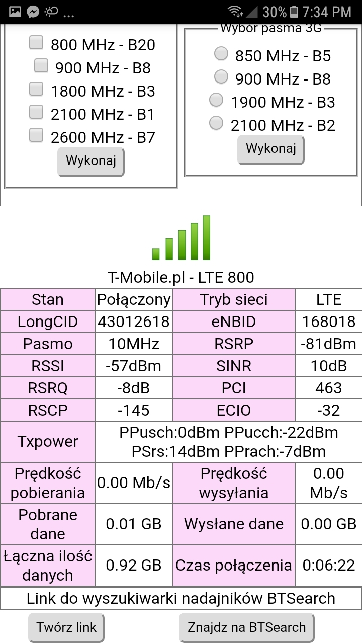

  • #13 17619876

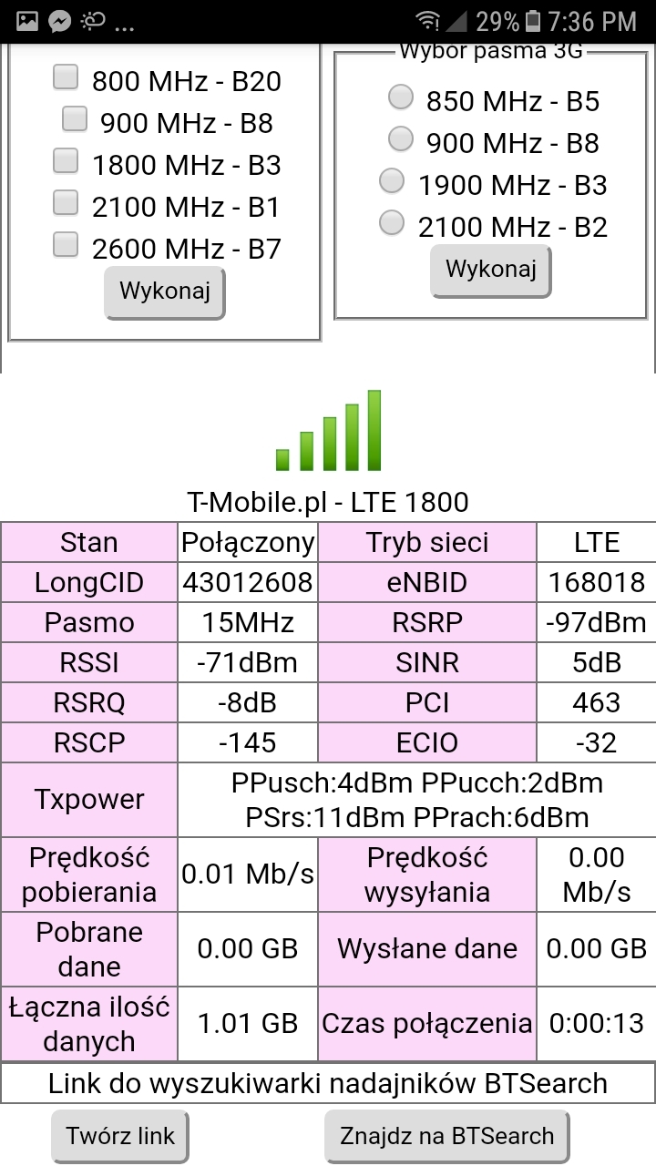

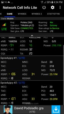

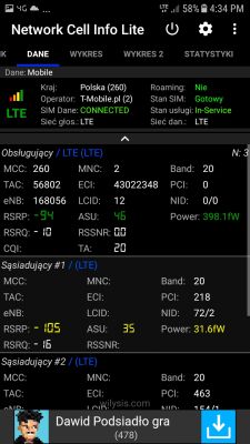

    cfirek
    Posts: 21

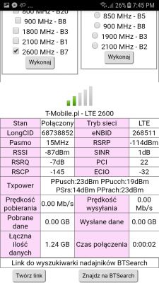

    Results from Network cell Info.
    Can you judge if it is worth pushing at 60Mb / s? Or maybe some antenna will help?
  • #14 17619924
    matek451
    Posts: 31251
    Help: 4352
    Rate: 5808

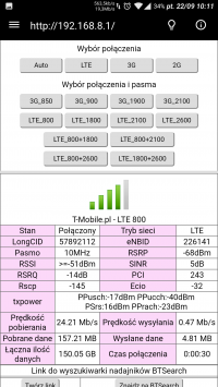

    Test with BTS-LTE800 T-mobile in Grębocice, signal sufficient, low SINR so and speeds are probably weak, no speed test. At LTE800 there is no chance of getting sensible speeds, T-Mobile has 10MHz bandwidth in MIMO2x2 and DL up to 75Mb / s, of course in theory. As a rule, the band is heavily loaded and clogged. The antenna will not change anything here.
  • #15 17620071
    cfirek
    Posts: 21
    Ok and setting another LTE? In the earliest posts the best speed test was for LTE 800 + 1800 and LTE 800 + 2600 settings?
