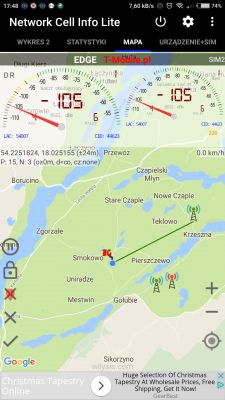

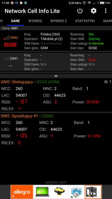

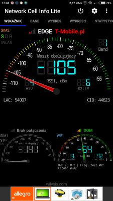

    Is this test at home or outside? Connection with BTS Borucino 3 to 2G with GSM900, poor signal parameters. Location difficult, on BTS Borucino LTE800 T-Mobile, same in Krzeszna. A powerful 800MHz antenna is needed, i.e. 2xATK-20 or 2xATK-10 / 800-980. Selection after testing on the B525 outside after extending the LTE800 band on it.

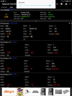

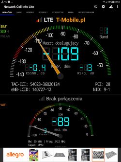

    Test made at home ... in the weakest place. I have the impression that now that there are no leaves, it is better than in summer. I am planning a mast maybe 1 m above roof level. At home, lte will definitely not catch (I never caught). Today, for a moment, I dumped the phone through a roof hatch. How much will I get on 3G? You know now I have 3MB / 1MB Wi-Fi so if it is better then I will be happy :) . In the attic I had a Speed test with 1.5 MB DL / 3MB UL as I caught a better signal. The fact that I can't check LTE yet because I have a Mi5S Plus phone without a village LTE 800 MHz
    Added after 13 [minutes]:
    One more question, will the panel or directional antenna be better in my case?

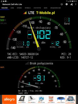

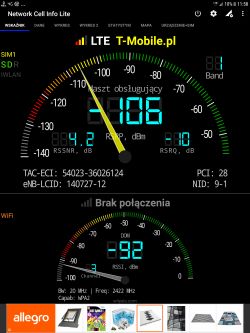

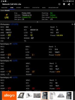

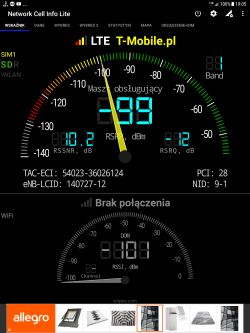

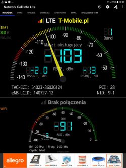

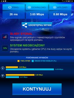

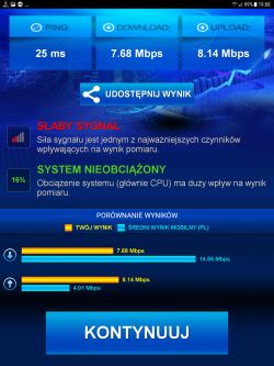

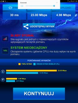

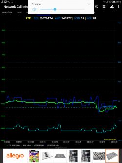

    Today, another tests, I went a little higher on the roof and took the measurement (on the tablet):
    Optimal Antenna Selection for T-Mobile Huawei B525s-23 LTE Router: BTS Dependent Options Optimal Antenna Selection for T-Mobile Huawei B525s-23 LTE Router: BTS Dependent Options :
    Connected to Borucino so it's certain that I will direct the antenna to this transmitter, now the question is whether ATK 10 will be enough.

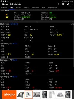

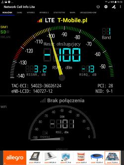

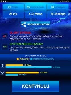

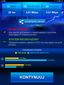

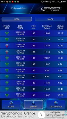

    Evening tests:
    Optimal Antenna Selection for T-Mobile Huawei B525s-23 LTE Router: BTS Dependent Options Optimal Antenna Selection for T-Mobile Huawei B525s-23 LTE Router: BTS Dependent Options Optimal Antenna Selection for T-Mobile Huawei B525s-23 LTE Router: BTS Dependent Options Optimal Antenna Selection for T-Mobile Huawei B525s-23 LTE Router: BTS Dependent Options Optimal Antenna Selection for T-Mobile Huawei B525s-23 LTE Router: BTS Dependent Options Optimal Antenna Selection for T-Mobile Huawei B525s-23 LTE Router: BTS Dependent Options Optimal Antenna Selection for T-Mobile Huawei B525s-23 LTE Router: BTS Dependent Options Optimal Antenna Selection for T-Mobile Huawei B525s-23 LTE Router: BTS Dependent Options Optimal Antenna Selection for T-Mobile Huawei B525s-23 LTE Router: BTS Dependent Options Optimal Antenna Selection for T-Mobile Huawei B525s-23 LTE Router: BTS Dependent Options Optimal Antenna Selection for T-Mobile Huawei B525s-23 LTE Router: BTS Dependent Options Optimal Antenna Selection for T-Mobile Huawei B525s-23 LTE Router: BTS Dependent Options

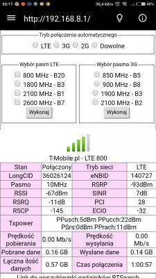

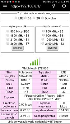

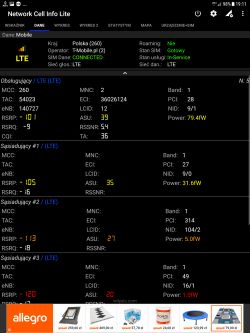

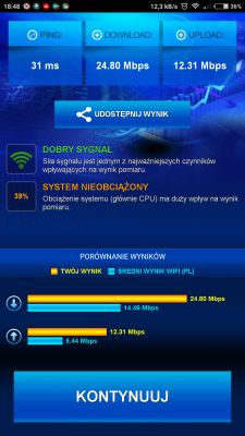

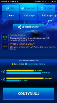

    Today came the router, mounted atk 10 antennas yesterday, the results are as follows:
    The speed jumps a little, although it's better than I have now via WiFi. Unfortunately, the SINR factor can jump to -2, so it's not good. Maybe I will turn the antenna a bit, but if it is clear, let me know where I am directing.
    • Screenshot_2018-01-10-20-16-02-825_pl.speedtest.android.png (895.6 KB) You must be logged in to download this attachment.
    • Screenshot_2018-01-10-20-17-23-400_com.nasser.huaweimanager.png (285.55 KB) You must be logged in to download this attachment.
  • #13 16950968
    makosuu
    Posts: 2984
    Help: 369
    Rate: 370
    Low SINR is the fault of the BTS load as seen by the speeds. The antenna is working properly.

    Today I changed the antenna direction. Unfortunately, he doesn't log in to Krzeszna. He logs me in to Szymbark straight away despite setting the direction for Krzeszno. So I changed the antenna even more and now I have the direction to Szymbark. The results are: Optimal Antenna Selection for T-Mobile Huawei B525s-23 LTE Router: BTS Dependent Options Optimal Antenna Selection for T-Mobile Huawei B525s-23 LTE Router: BTS Dependent Options Optimal Antenna Selection for T-Mobile Huawei B525s-23 LTE Router: BTS Dependent Options
    Download is not bad at peak times, upload smaller than at Borucino. However, I care more about DL. I will see in the evening how the University of Lodz will be shaped. Better signal quality at Szymbark. I leave it for now.
