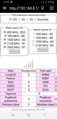

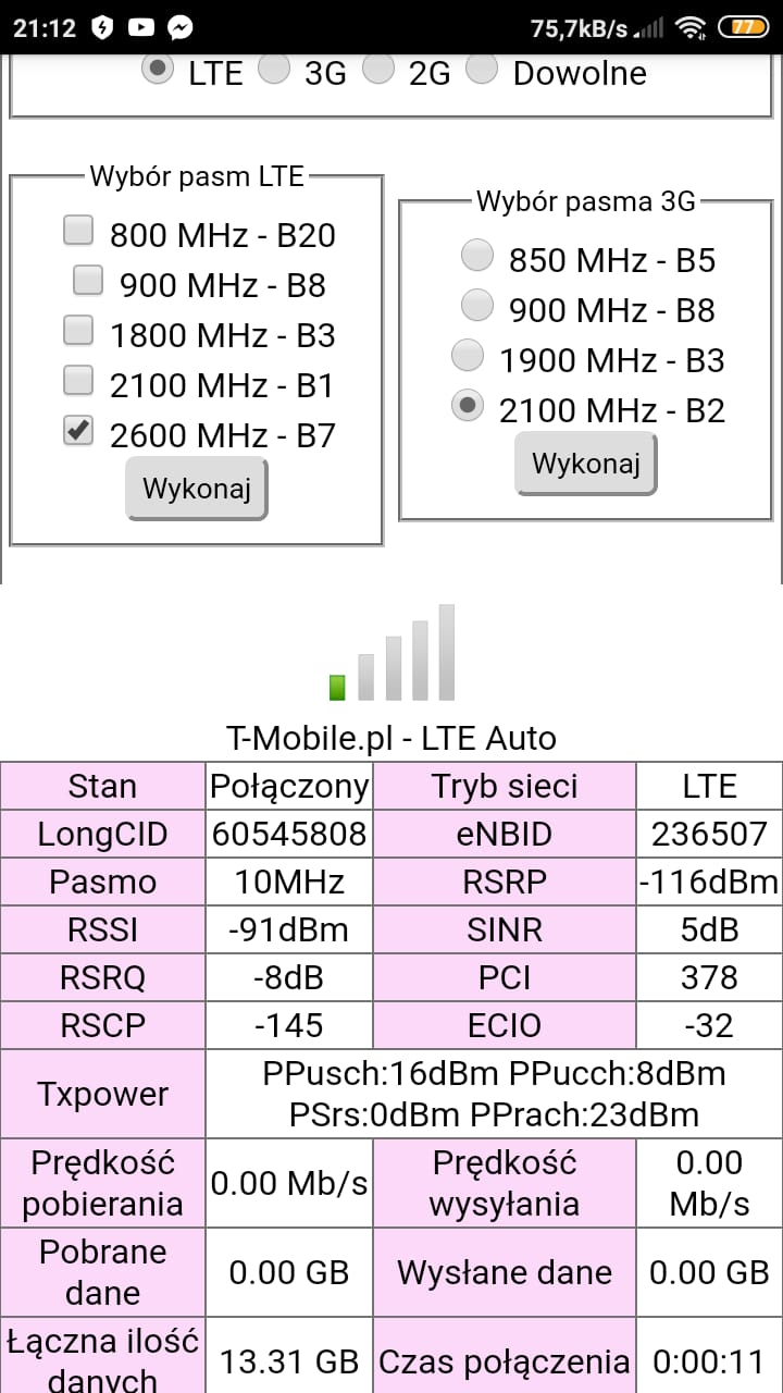

    Best External Antenna for Huawei b525s-23a Router: Boost 4G LTE (GSM 1800) & LTE 2600 Signal
    what could be wrong, the same for 2 phones.
  • #8 18268223
    Dawid_M_93
    And have you connected to wi-fi? You need to connect to the router because you won't see anything on the data packet from the phone :-)

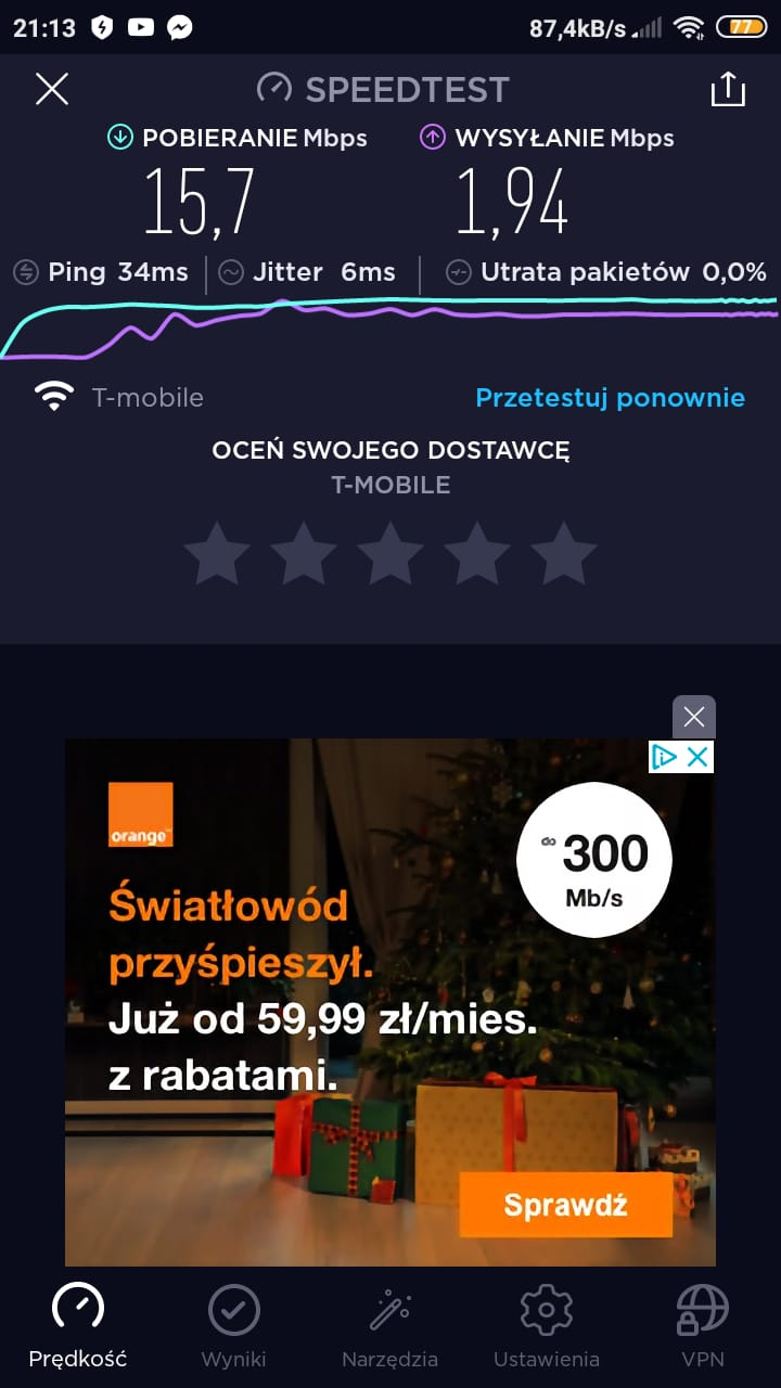

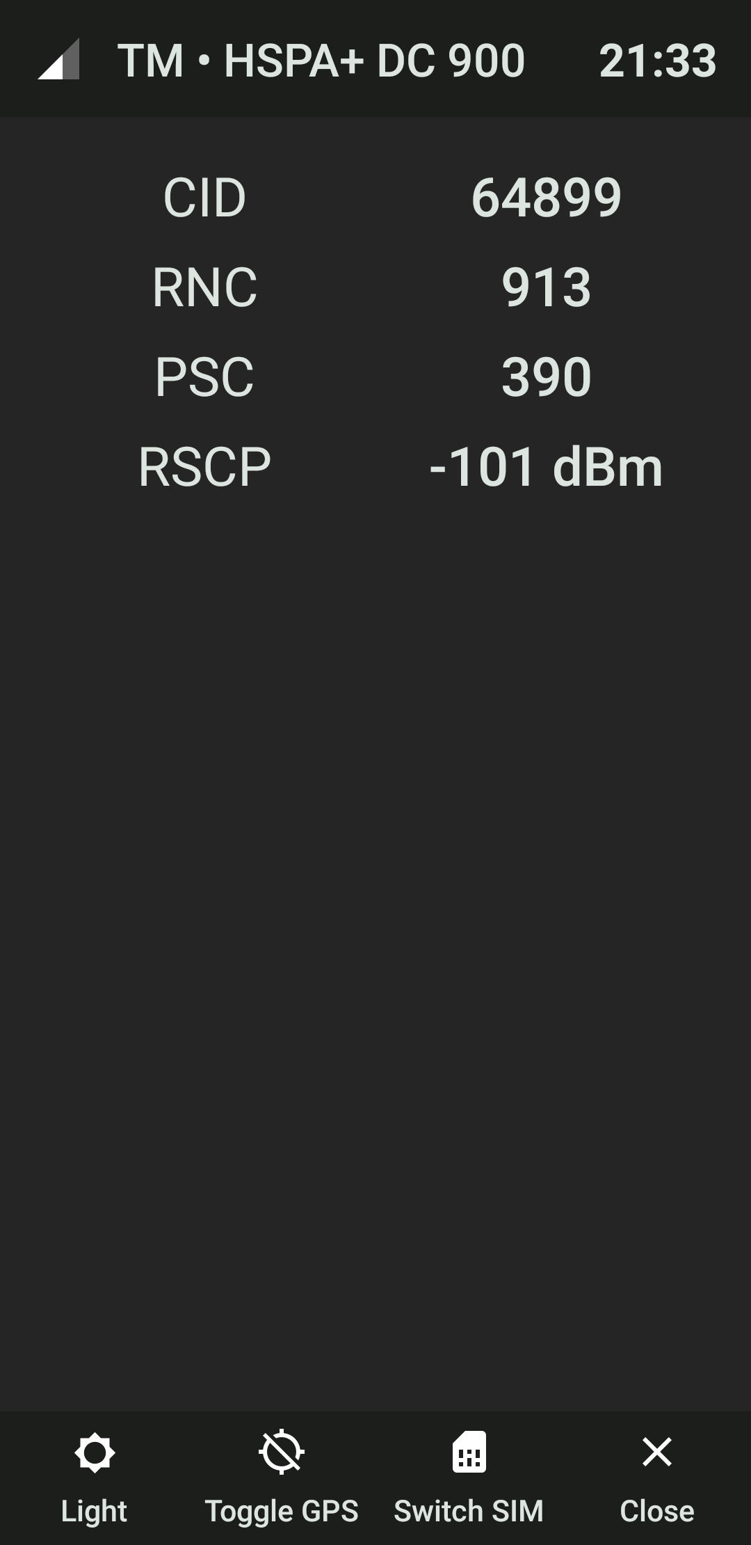

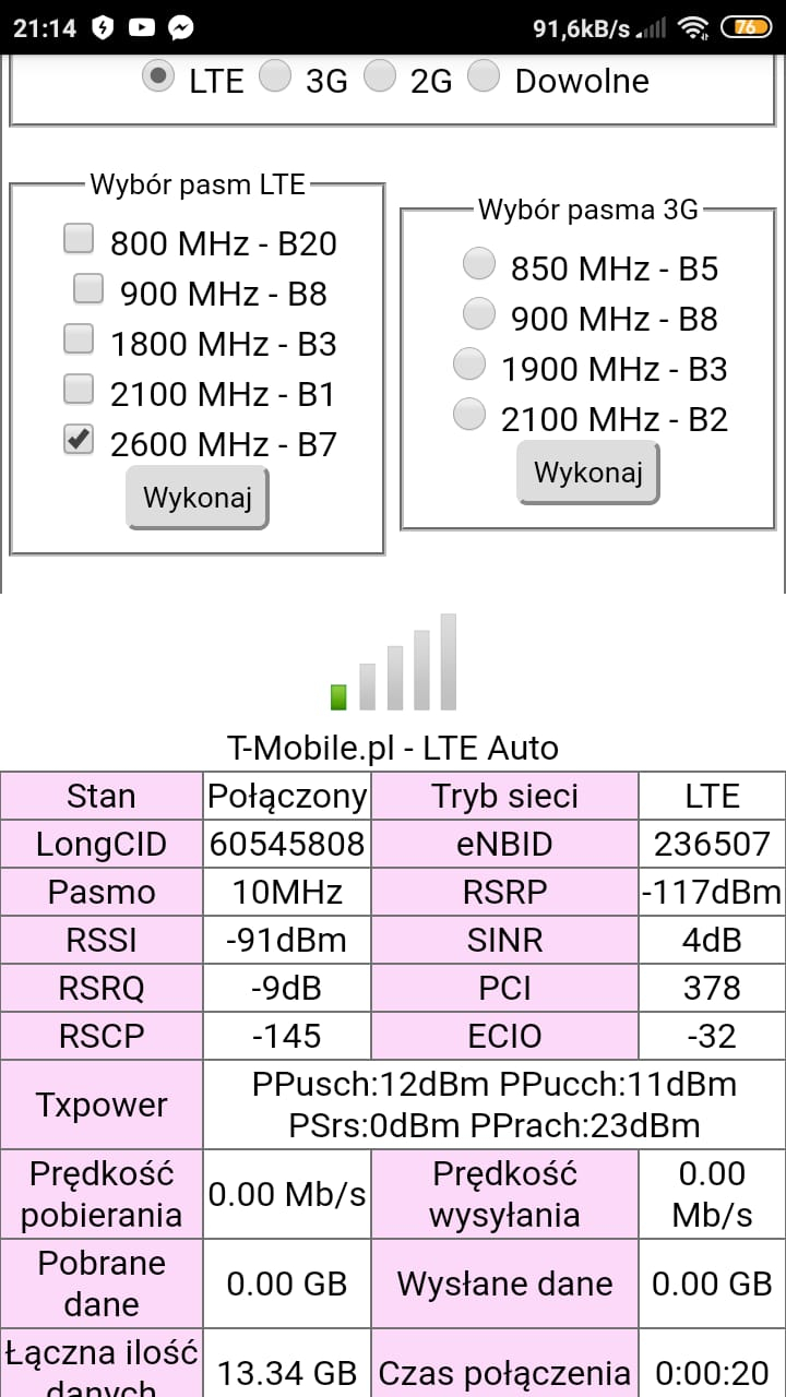

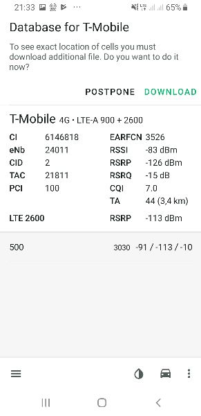

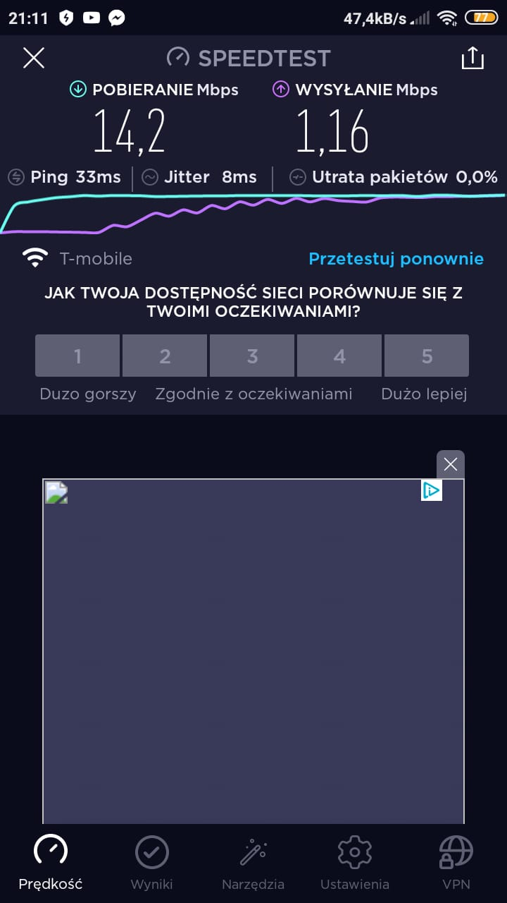

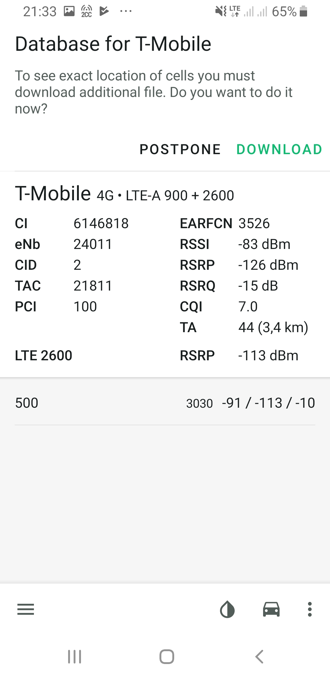

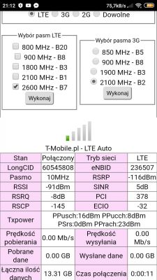

    Pictures below, we have a card from T-Mobile
    • Best External Antenna for Huawei b525s-23a Router: Boost 4G LTE (GSM 1800) & LTE 2600 Signal Screenshot_20191128-213318_NetMonster.jpg (332.46 KB) You must be logged in to download this attachment.
    • Best External Antenna for Huawei b525s-23a Router: Boost 4G LTE (GSM 1800) & LTE 2600 Signal Screenshot_20191128-213358_NetMonster.jpg (276.26 KB) You must be logged in to download this attachment.
    • Best External Antenna for Huawei b525s-23a Router: Boost 4G LTE (GSM 1800) & LTE 2600 Signal Screenshot_20191128-213342_NetMonster.jpg (137.79 KB) You must be logged in to download this attachment.
  • #16 18307986
    matek451
    Posts: 31251
    Help: 4352
    Rate: 5808
    This is not a T-mobile test, but Plus, a sim card in the second slot that does not support LTE. Hence the data is for 3G on UMTS900

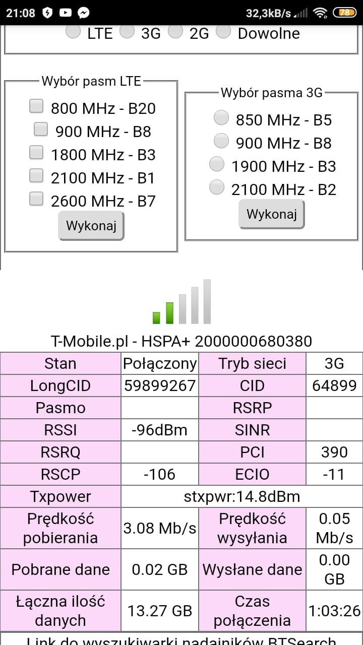

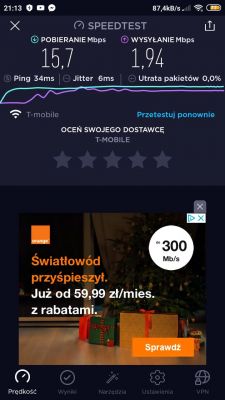

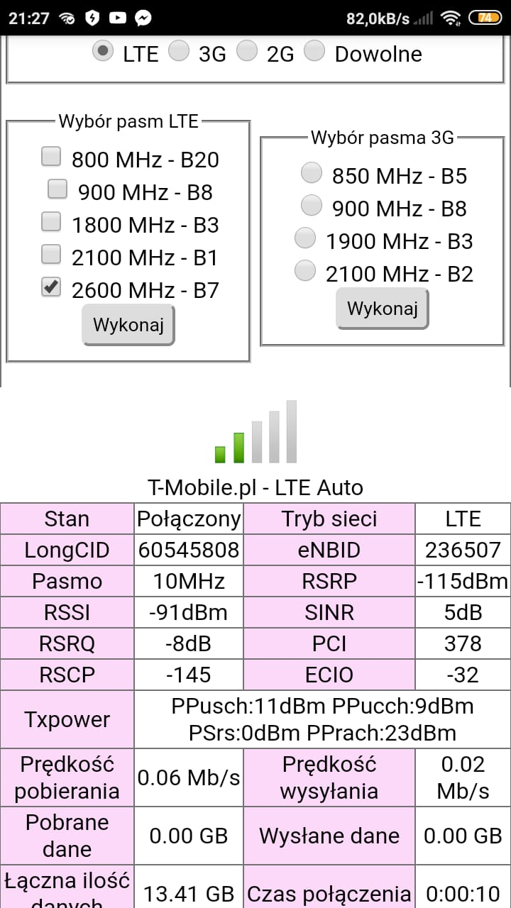

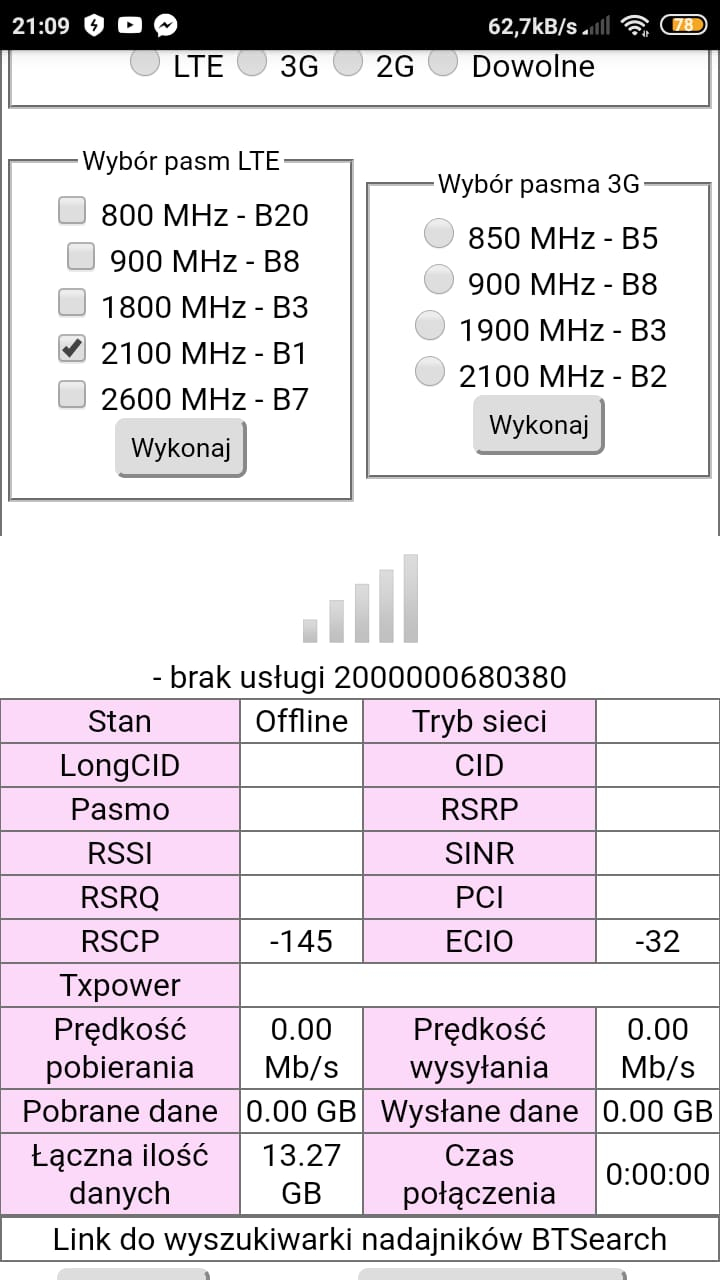

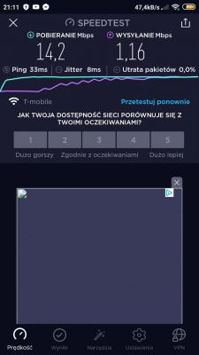

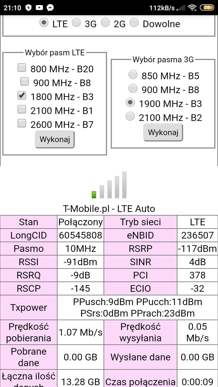

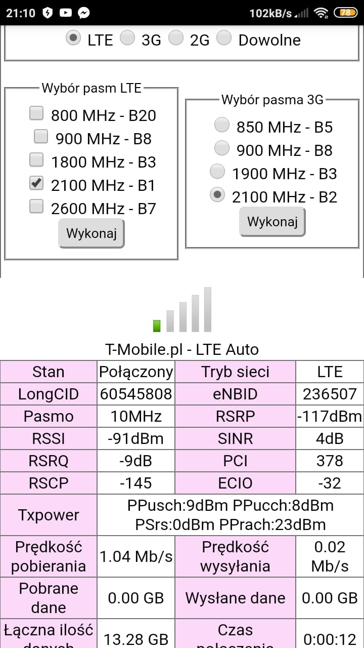

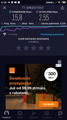

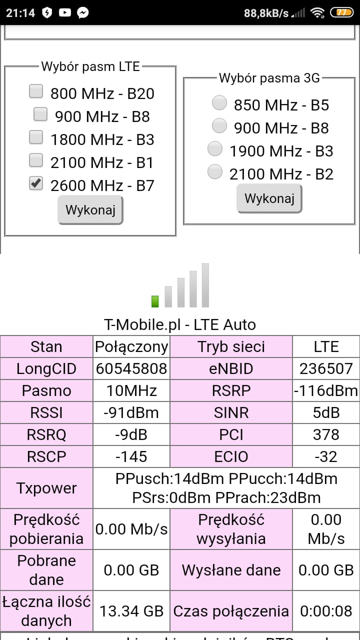

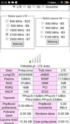

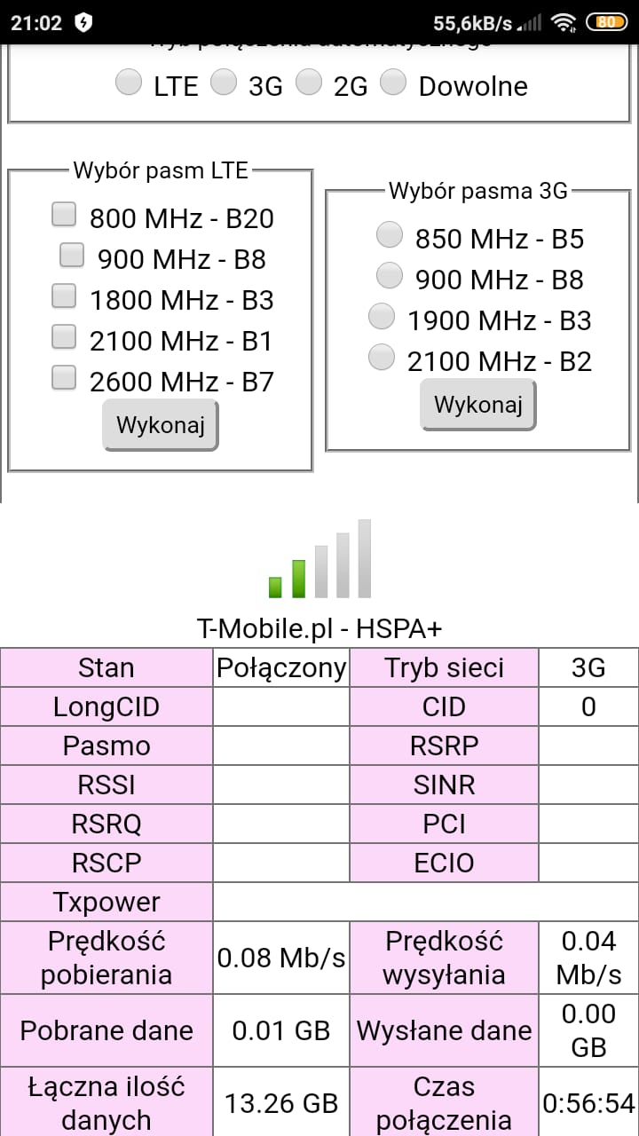

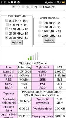

    Here are photos from T-Mobile
    • Best External Antenna for Huawei b525s-23a Router: Boost 4G LTE (GSM 1800) & LTE 2600 Signal Screenshot_20191128-213358_NetMonster.jpg (23.26 KB) You must be logged in to download this attachment.
    • Best External Antenna for Huawei b525s-23a Router: Boost 4G LTE (GSM 1800) & LTE 2600 Signal Screenshot_20191128-215011_NetMonster.jpg (17.55 KB) You must be logged in to download this attachment.
    • Best External Antenna for Huawei b525s-23a Router: Boost 4G LTE (GSM 1800) & LTE 2600 Signal Screenshot_20191128-214912_NetMonster.jpg (16.89 KB) You must be logged in to download this attachment.
    • Best External Antenna for Huawei b525s-23a Router: Boost 4G LTE (GSM 1800) & LTE 2600 Signal Screenshot_20191128-214957_NetMonster.jpg (15.65 KB) You must be logged in to download this attachment.
  • #18 18308251
    kejk1992
    Posts: 35
    Rate: 14
    Change these cards in places.

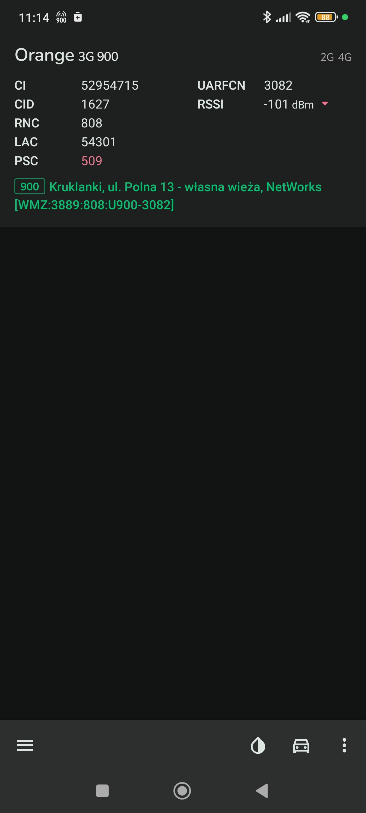

  • Need BTS location and antenna suitability advice
    #22 18420238
    MrMojoRisisn
    Hi
    I recently bought a lte Orange with the same router which is in the title of thread, the speed is unfortunately very weak, maximum 2mb and it drops even to 120kb, when it happens ping also jumps a lot, mainly I play games I do not care about the speed only as low and stable ping as possible
    I am completely green in the subject, so I would like to know if buying a device of this type will help
    https: // allegro .pl / offer / antenna-dual-typhoon-ii-15met-3g-4g-lte-46dbi-huawei-7535744056? msgtoken = 048a25b10f8bf5405c1e387864ffa85323220a1444b540a86acf77d00be2ff62
    https: // allegro .pl / offer / power-strong-antenna-dual-3g-4g-50dbi-huaw-zte-2x10m-8242022877
    Unfortunately, I do not know where bts is and on the website mapabts.pl I am not able to enter the address because the google message pops up
    I live on Gostyńska Street in Gdańsk, the provider is Orange.
  • #23 18420332
    matek451
    Posts: 31251
    Help: 4352
    Rate: 5808
    Precision worth noting, Gostyńska in Gdańsk has a few kilometers, in this topic everything has been written about the b525 tests using Hmanager, so first the results of the B525 tests for LTE2600, LTE2100, LTE1800 and LTE800 are shown.

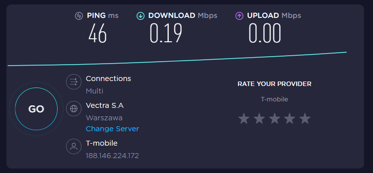

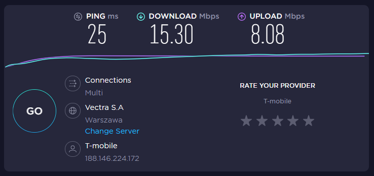

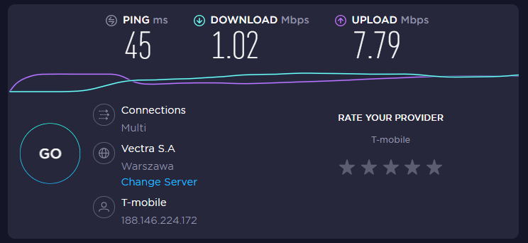

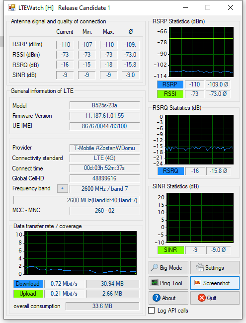

    I would like to check with you the tests for Żyrardów, ul. Warynskiego 1. T-Mobile mobile internet. Due to the specific buildings limiting the exhibition, I focus on one specific station Żyrardów, Mazowieckie, ul. rtm. W.Pileckiego 82 (chimney of the PEC Municipal Heating Plant). I was supposed to throw in tests both inside and out, but the results were practically identical. At least in the context of the transfer, because I do not know what else you are reading and how. So maybe I will repeat the test outside. I noticed that the 2100MHz band is a bit better than the rest. The biggest problem with all this internet is a lot of volatility. The 2100 band gave me 15DL / 8UL, but there were also 1DL / 8UL. And some intermediate values.
    I was wondering about the antenna and that's how I found this thread. Can you suggest what diagnostics should be performed? I know that 15Mb DL is a good result, but often the transfer is so hopeless that I disconnect from the wifi because the pages are not loading. I would like to add that my wifi can be used by up to 4 people and 6-7 devices at the same time, so I am also aware that sometimes it is just difficult to distribute everyone.
    I can't upload photos with captions, and I described the results of the speed test only in the name of the file, which is not here. So here's a description of the speedtest photos:
    0.19 / 0.00 - 2600MHz
    1.02 / 7.79 - 1800MHz
    4.45 / 6/78 - 800MHz
    15.30 / 8.08 - 2100MHz
    In addition, I checked that my router (Huawei b525s-23a) does not have the option to select one band permanently. So I have the impression that if I wanted to use one particular one, I would have to fire up the computer, fire up the soft for the test and select the appropriate band in it. Is it true?
    Best External Antenna for Huawei b525s-23a Router: Boost 4G LTE (GSM 1800) & LTE 2600 Signal Best External Antenna for Huawei b525s-23a Router: Boost 4G LTE (GSM 1800) & LTE 2600 Signal Best External Antenna for Huawei b525s-23a Router: Boost 4G LTE (GSM 1800) & LTE 2600 Signal Best External Antenna for Huawei b525s-23a Router: Boost 4G LTE (GSM 1800) & LTE 2600 Signal
  • #27 18618820
    matek451
    Posts: 31251
    Help: 4352
    Rate: 5808
    This is a drama, the station on LTE1800 and LTE800 is clogged, sometimes it works somehow on LTE2100, but since there are such fluctuations, LTE2600 but the signal here is poor. In general, the chances of this BTS for normal internet are small, probably some on LTE2600 and maybe on LTE2100 after improving the signal on these bands but I would not count on miracles, Żyrardów and T-mobile are a poor choice, the operator sold offers without limits and the result is easy to predict, a poor network of 5 base stations can no longer cope. In addition, B525 does not aggregate LTE2600 + 2100.

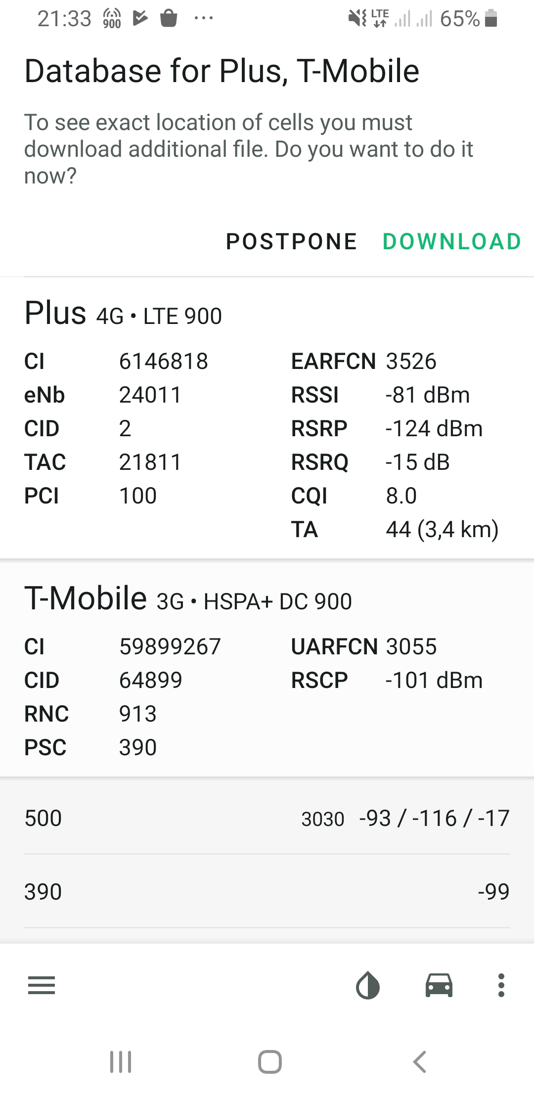

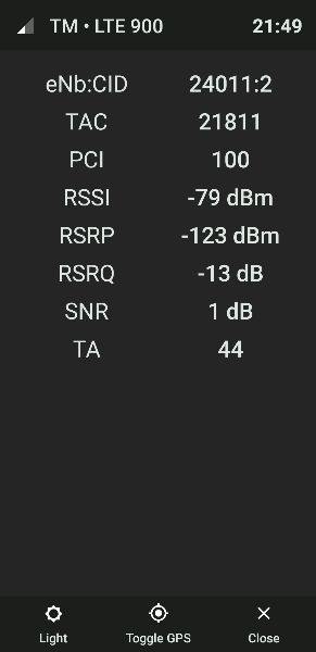

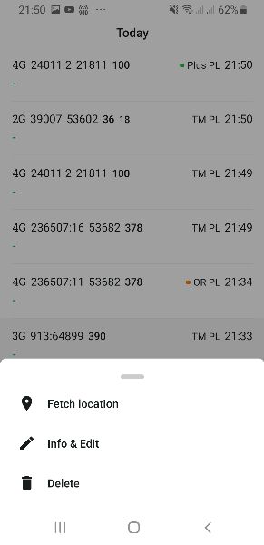

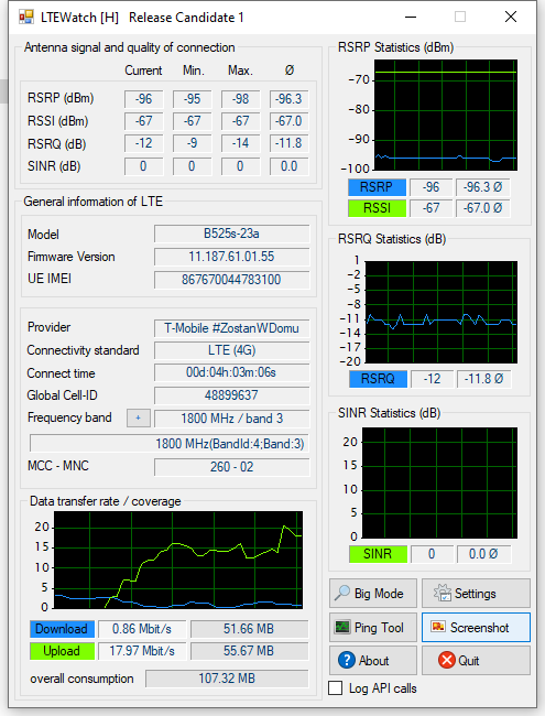

    Good morning. This is the snapshot I got from NetMonster. Huawei b525. Is there a point to the antenna? If so, which one?
