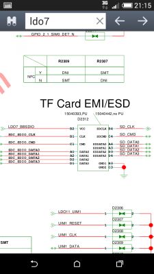

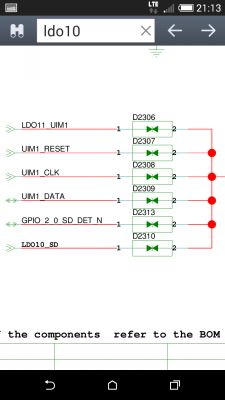

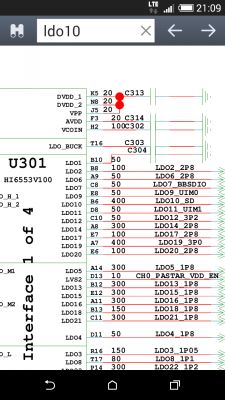

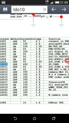

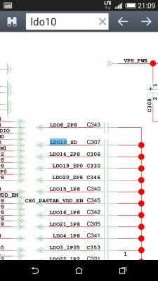

    Hello, I got a phone with the same problem, maybe this time I can solve the problem. After flooding, the phone has been cleaned but still cannot read the SD card. Transitions are, only the ldo10 power supply which goes from U301 is missing. Is the U301 to be replaced?
    Added after 1 [hours] 32 [minutes]:
    Huawei P8 Lite: Identifying Memory Card Layout Post Isopropanol Cleaning Huawei P8 Lite: Identifying Memory Card Layout Post Isopropanol Cleaning Huawei P8 Lite: Identifying Memory Card Layout Post Isopropanol Cleaning Huawei P8 Lite: Identifying Memory Card Layout Post Isopropanol Cleaning
    Added after 6 [minutes]:
    Is ldo7 a filter supply? I desoldered the filterek and only 0.5V instead of 3V on ldo7. Ldo7 also goes from u301. Huawei P8 Lite: Identifying Memory Card Layout Post Isopropanol Cleaning

    Hello. LDO10 appears when the CPU detects a 1.8V GPIO_2_0_SD_DET_N short circuit on TP2318.

    Hello, thank you colleague Plustek for the materials he shared. At TP 2318 without a card I have 1.8V and with a 0V card, i.e. correctly. LDO 10 appears and disappears. Impedance between mass and contact plates about 1000, i.e. something is wrong and according to the algorithm you need to replace D2312?
    #8 17836868
    plustek
    Posts: 1427
    Help: 176
    Rate: 200
    Impedance is given with the meter set to measure the diode, with the meter plus on the mass. The values may vary slightly, with significant discrepancies start from D2312.
