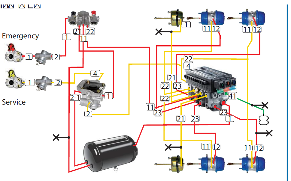

    I have a problem with the SAMRO curtain model S338RJ. Born in 2002. Disc brakes. Axes ror. ABS.
    The problem is that the trailer does not get the right pressure or no air on the brakes. They are all tightened and there is no reaction to the manual or working brake with the tractor attached, and also to the valve unfastened with air.
    The first suspicions are on the unresponsive parking and release valve on the trailer, or on the brakes quick release valves.
    The semi-trailer was not used for a long time before, everything was fine. Recently, the discs, pads, regenerated calipers, one brake cylinder and a brake valve / regulator were replaced.
    Maybe someone had a similar case and will tell you. I will be grateful! :)

    It would be advisable for you to specify what brake system the trailer has. Wabco, Knorr-Bremse, Haldex or a photo of the valve and the number of the park-release valve.
  • #4 16733868
    dimk1
    Posts: 47
    Rate: 28
    Haldex brake system. Park-release valve replaced today. Works but still no response at the brake cylinders.

    My colleague, you have still not specified which park-relief valve you have replaced. In the appendix I give you two types produced by Haldex, one of them shows the installation diagram. Check that you have a properly connected valve.

    What's your ABS valve? Below is the installation diagram for eb + II.

    So it is ABS MODULAR. Below is a diagram of the pneumatic installation. The second is diagnostics manual electrical diagram SERVICE MANUAL ang.

  • #16 16759118
    dimk1
    Posts: 47
    Rate: 28
    Thank you very much for the sent diagram! It turned out that the yellow and red wires were swapped. Everything is already working ;)
