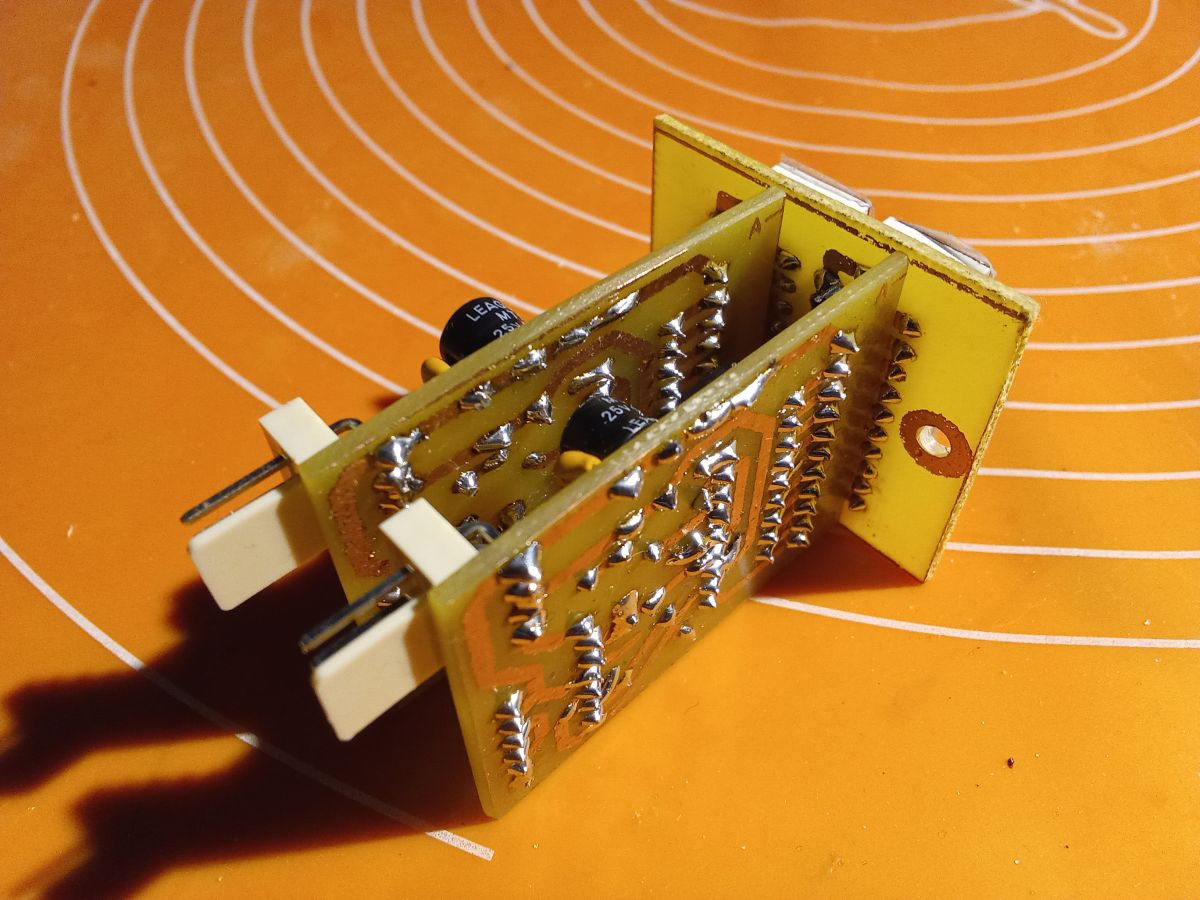

    Let me introduce my mini-drive indicator project, inspired by LED poles I found on AliExpress in three colours - looking "from below": five green, three yellow and two red. They were just begging to be used as an audio output indicator....

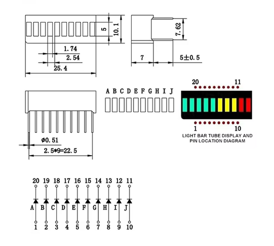

    Technical diagram of an LED bar graph display with pin numbering and dimensions.
    Of course, similar posts can also be obtained in single or dual colour and in any of the available LED light colours.
    It took a bit of "scouring" of AliExpress, because just such a set of colours (and in such quantities of each) - contrary to appearances - is not the most popular. If anything, it is more common to come across offers of similar BAR LED indicators, but instead of the first (lowest) green LED being inserted in (as if otherwise... ;) ) blue. The given set didn't quite suit me for obvious reasons, but I finally got around to it and found one that was more normal.
    There are, of course, similar gauges on offer from Ali.... "by the metre". Hardly any that come in different colours - all of one shade, red, green, blue, etc., right down to the most varied colour sets or different numbers of LEDs. If someone is interested in the offer, but, for example, 10 LEDs is not enough - there are also posts half the size, also in one or two colours. And since (and I have included this in the topic) IT IS ALSO POSSIBLE TO CONNECT LM391* DRIVERS in series and obtain indicators with a greater number of LEDs (and, of course, a greater range of indicated sensitivity levels) - I believe that the field of possibilities is huge.

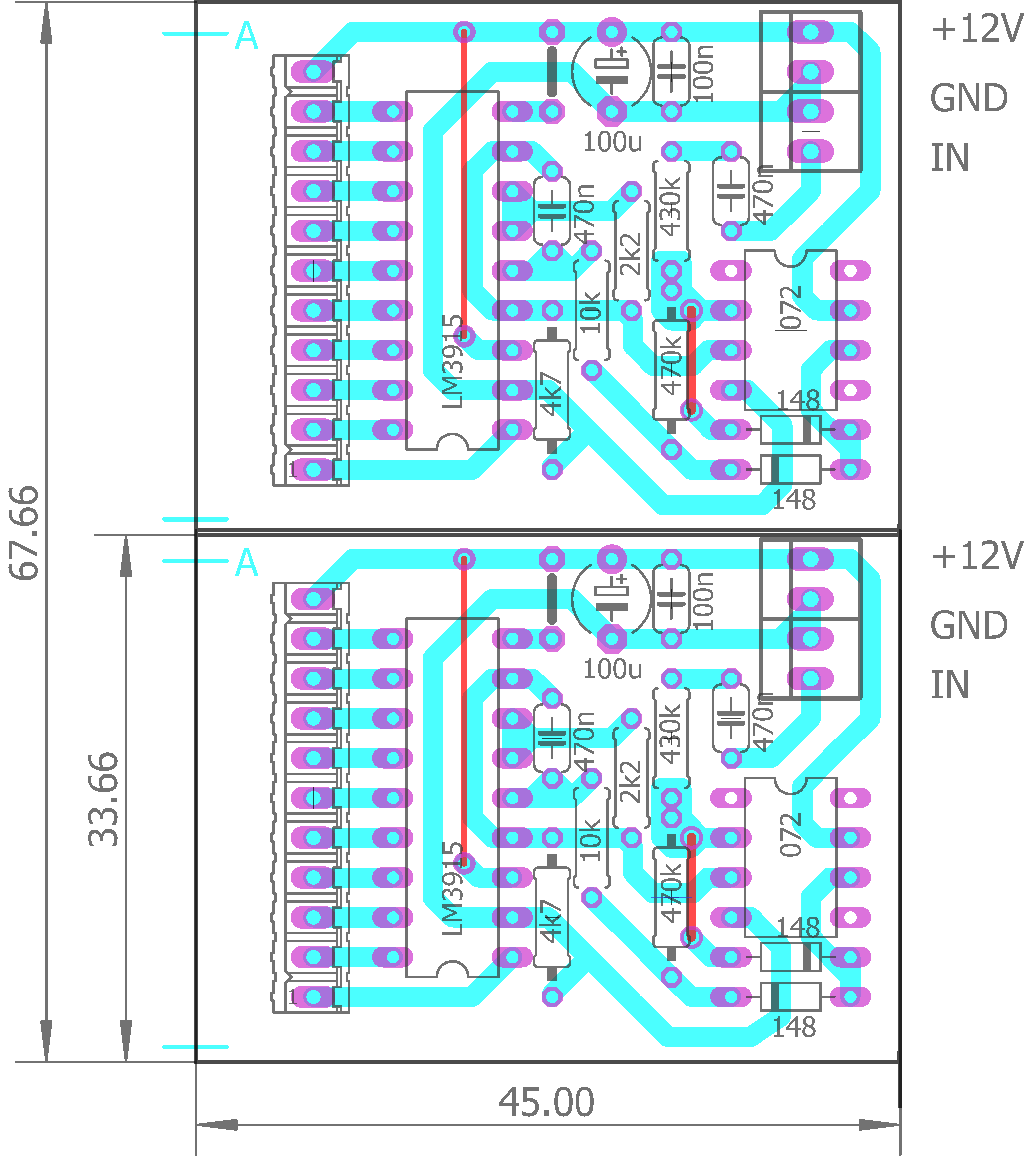

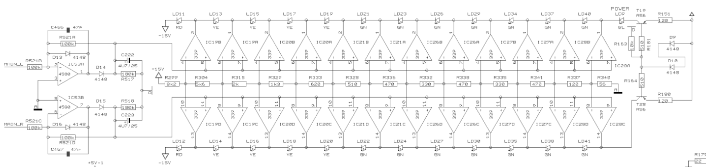

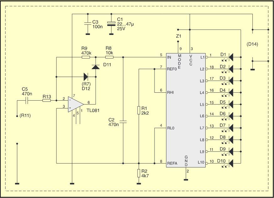

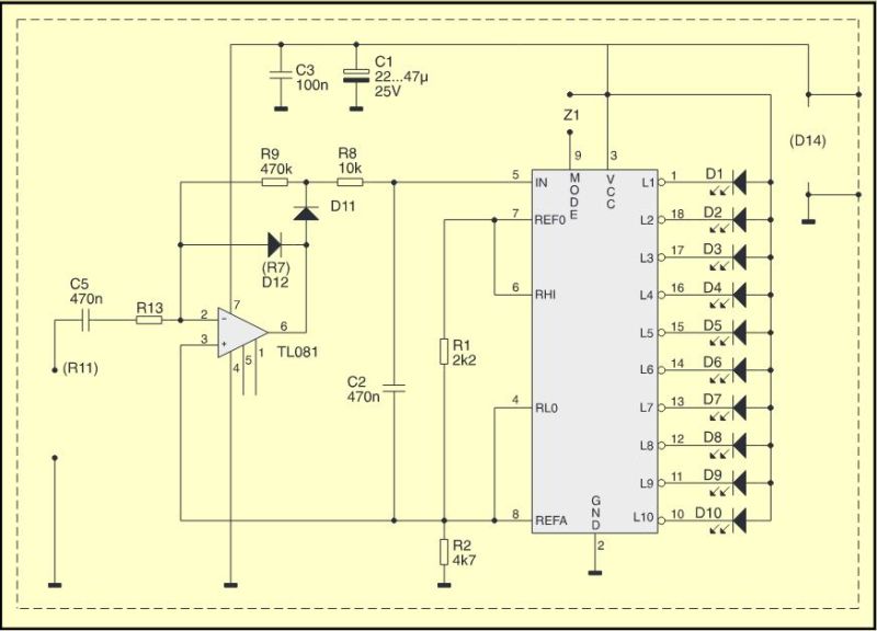

    I based my design on a typical application for an IC specifically designed for such applications, the LM3915. The application note of the chip explains everything. In addition, it contains a rich description of all possible applications, which means that this chip (now only produced in China), even today - many years after its premiere on the market - can still be an interesting proposition. I chose one (tested by myself many times in several earlier devices, but still with single LEDs) found years ago in one of the first issues of "Electronics for All".
    Electronic circuit diagram with LEDs, TL081 operational amplifier, and other components.
    As I wrote - the schematic has been verified by me more than once in such a circuit and has worked great. So all that was left to do was to work out a proper drawing of the paths to it, add the LED posts and.... done.
    Of course, there were a few minor mistakes. Unfortunately, the years have taken their toll, and the board with the LED bars had to be mounted in a rather unusual way.... Anyway, we managed to design the whole thing into a compact module of relatively small dimensions.

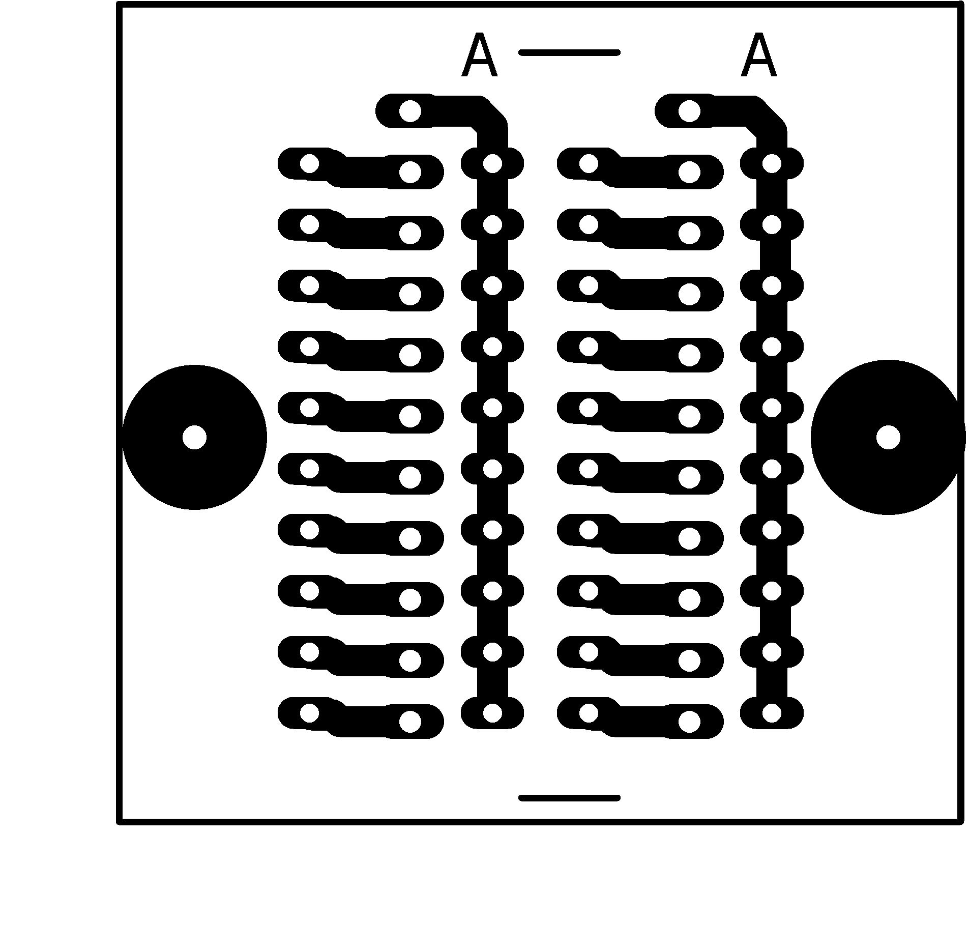

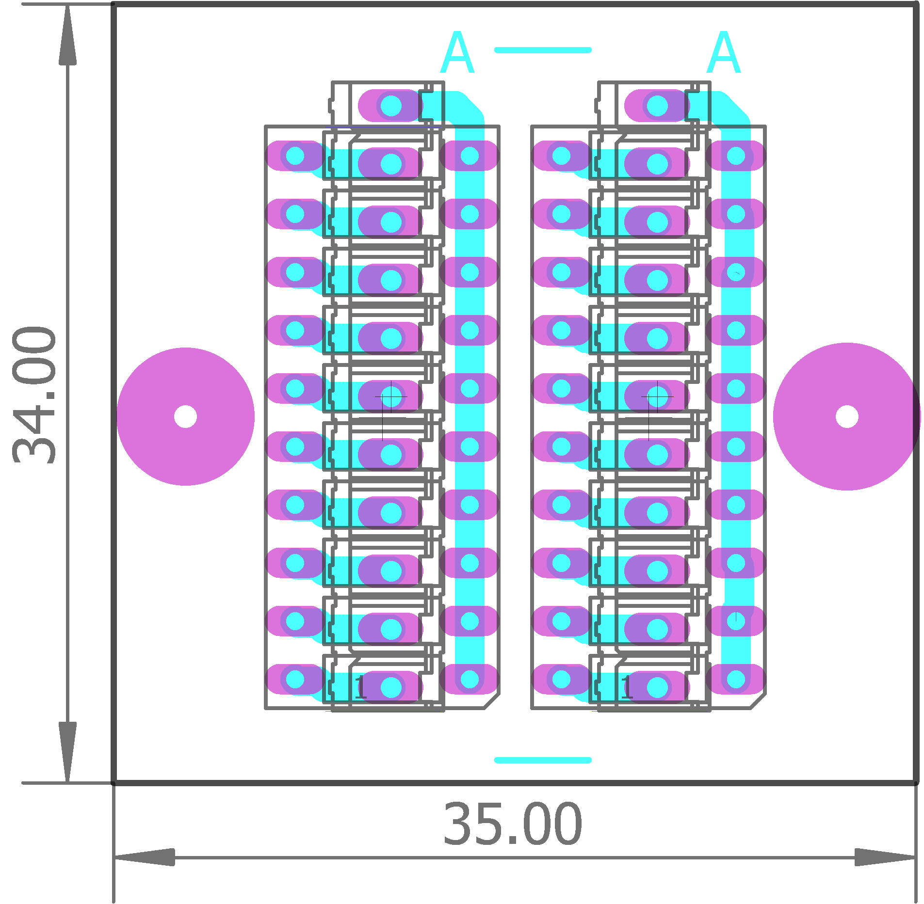

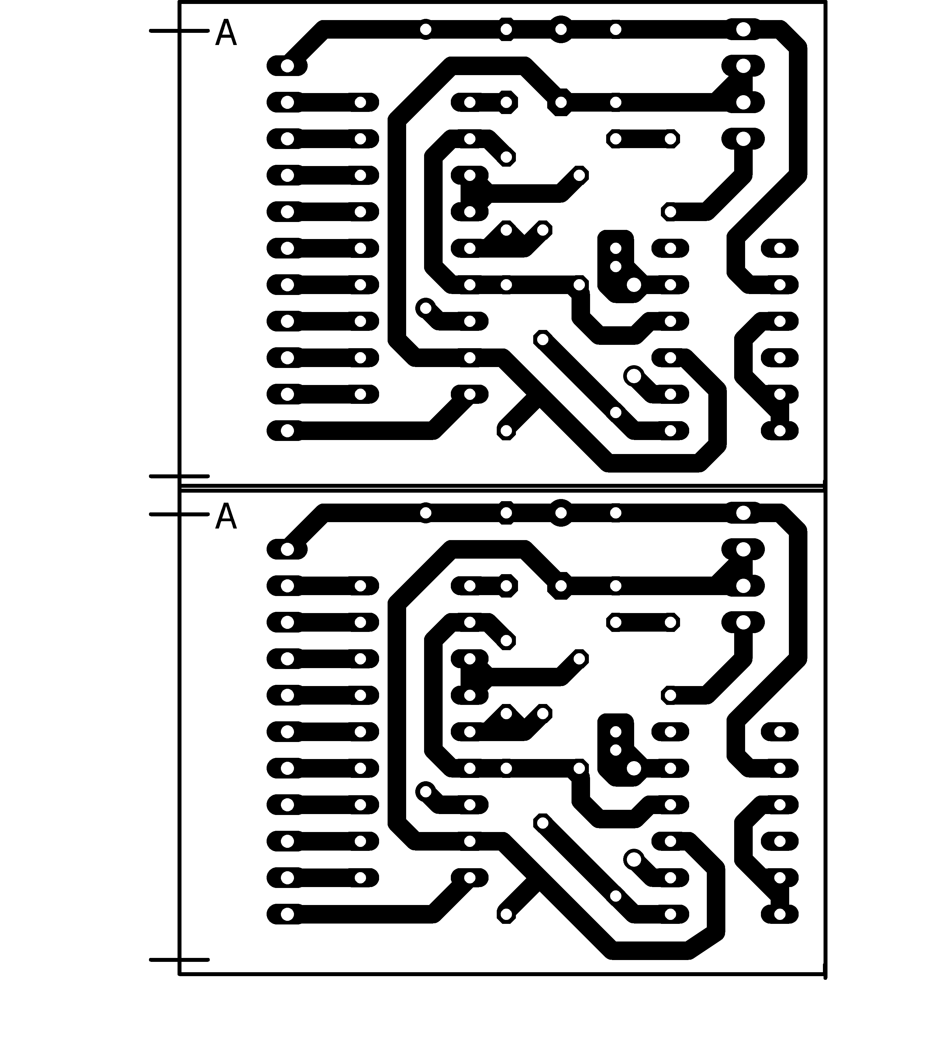

    For those who may be interested - the drawings of the paths are suitable for the production by thermal transfer of the boards enabling the assembly of such a module as in the following pictures. Simply print them in their original size and transfer such a print to the laminate.
    One could talk a lot, but since "one picture is worth more than a thousand words", I will present my work on making the prototype below in the form of a photo report.

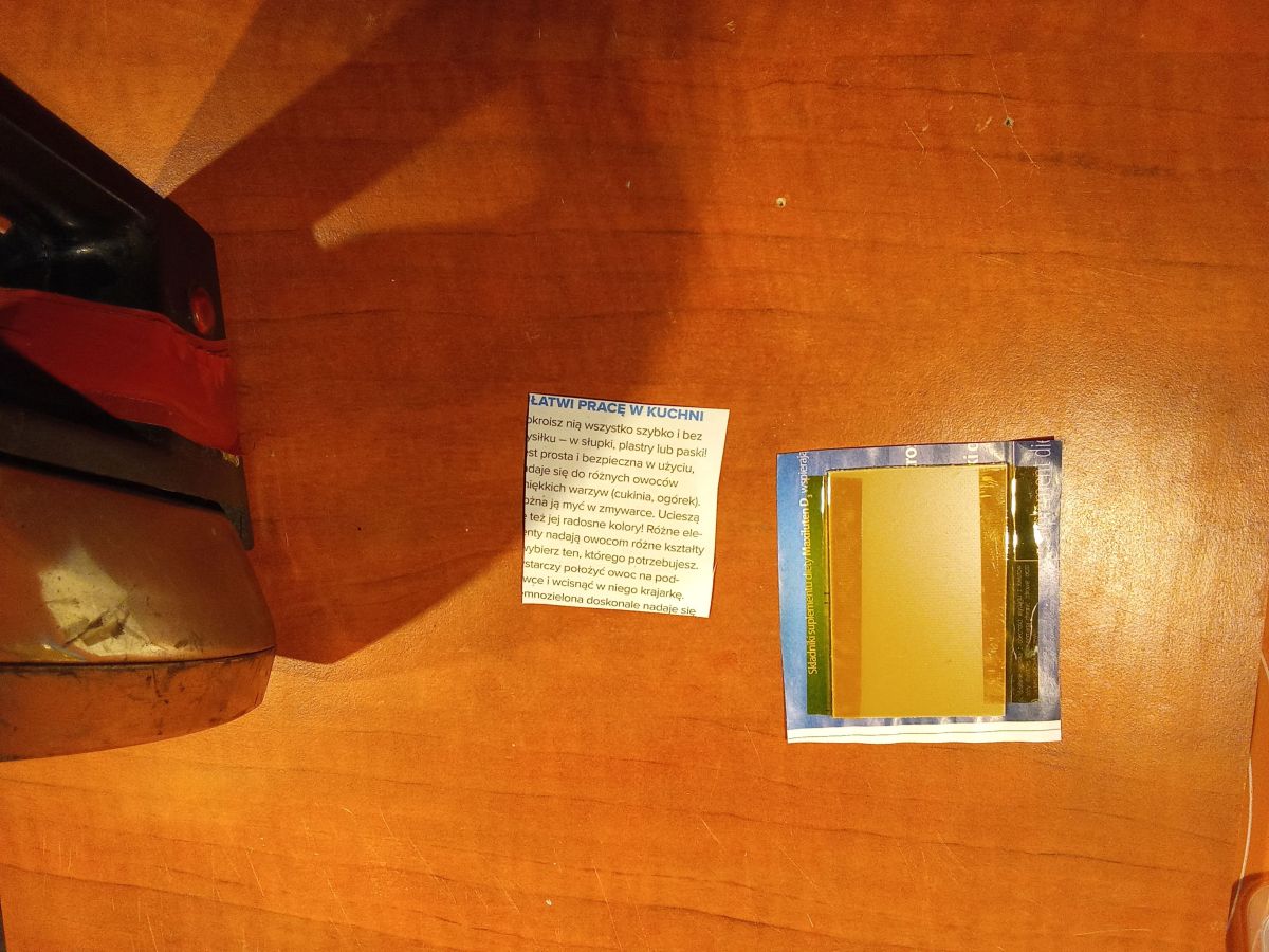

    Applying the laminate cut to size to the print (Kapton adhesive film):
    A paper with text on a wooden table and a metal object.
    After 'ironing' and removing the paper (I use pages from women's monthly magazines - already read, of course, and with my Wife's permission, made available to me for this purpose):
    The image shows a kitchen mat with drawn circles, a jar labeled Ogórki kwaszone, a lid, and two printed circuit boards.

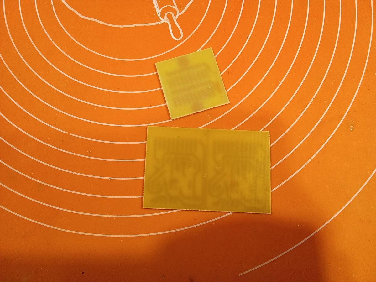

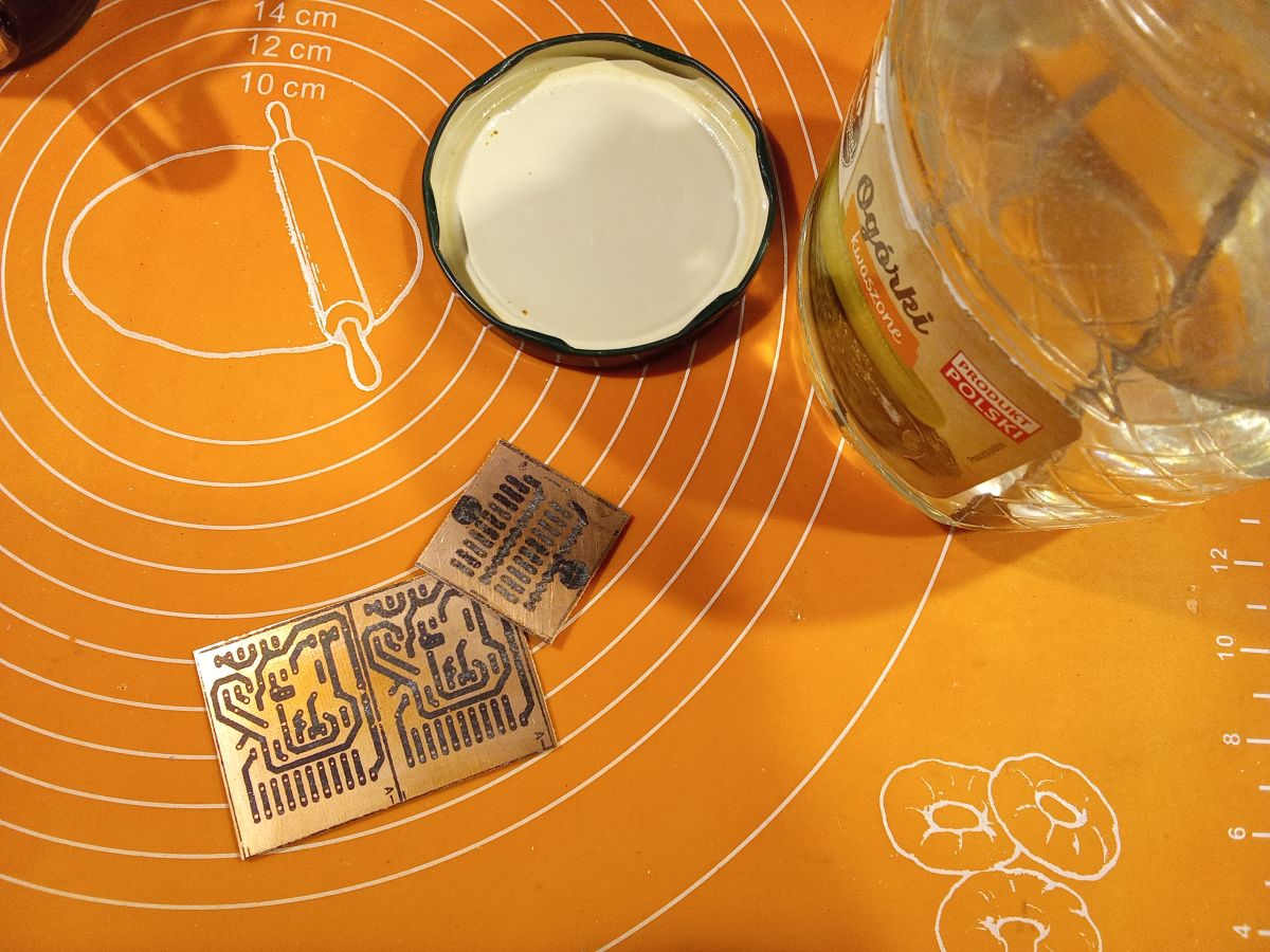

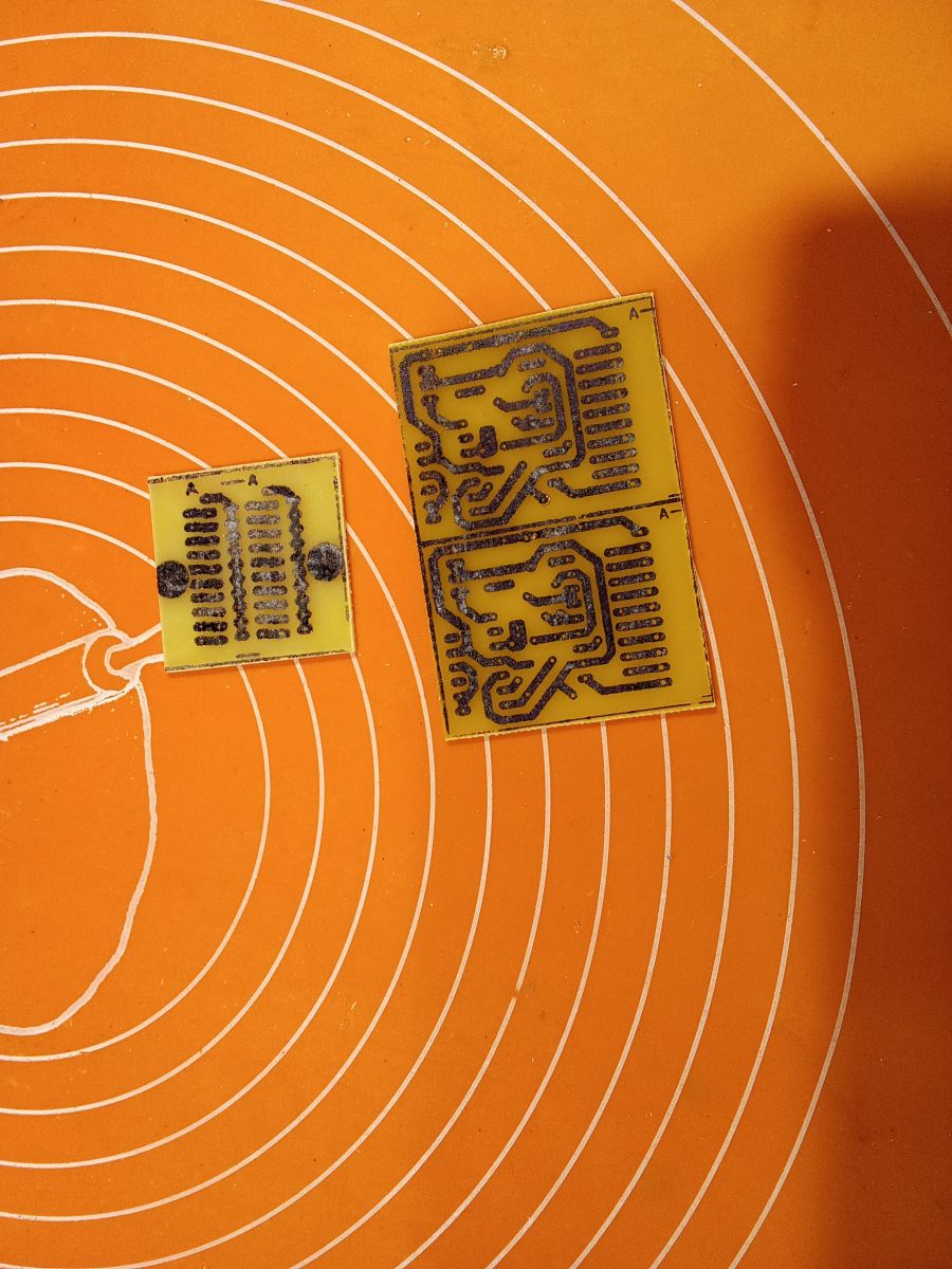

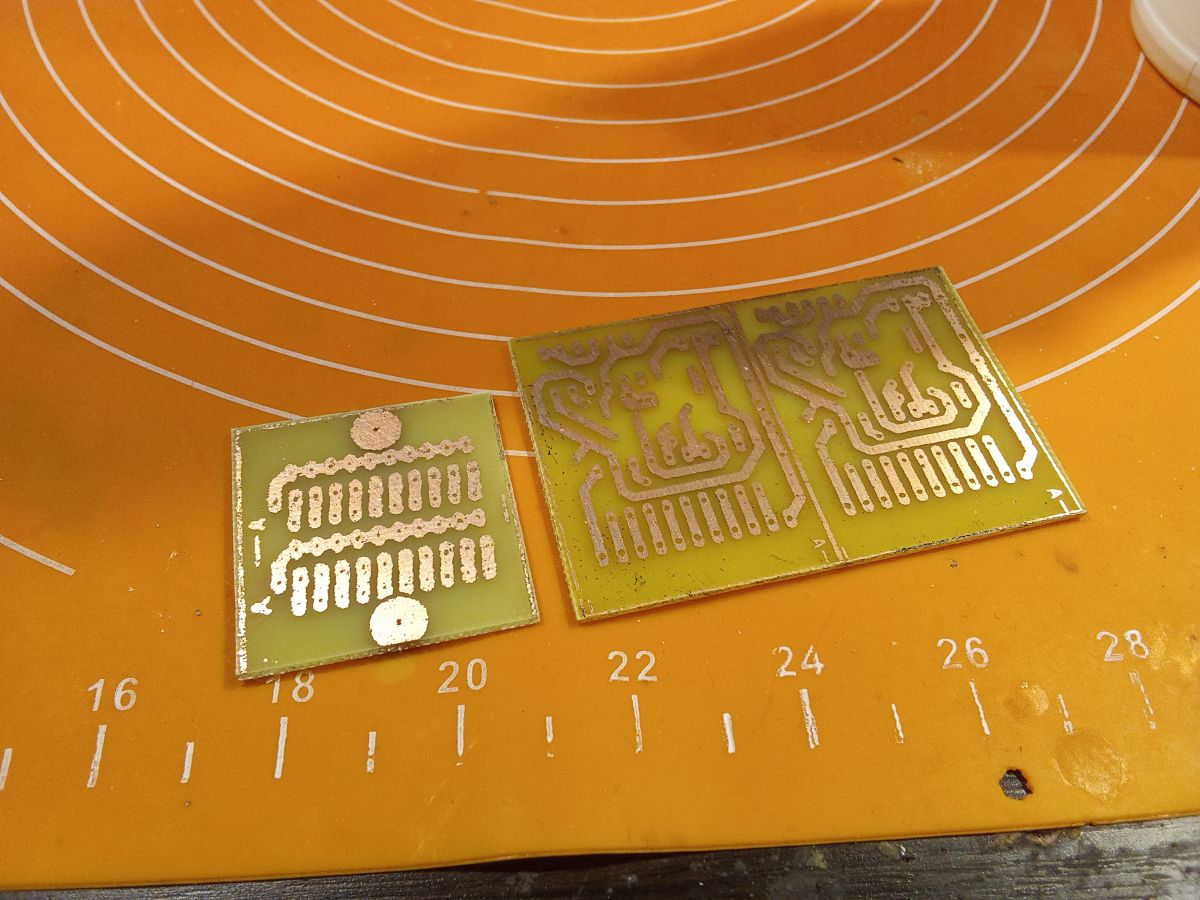

    A thermal transfer made in this way is already suitable for etching (available etch at any electronics shop):
    Two printed circuit boards on an orange background with white circles.
    Two yellow PCB pieces on an orange mat with concentric circles.

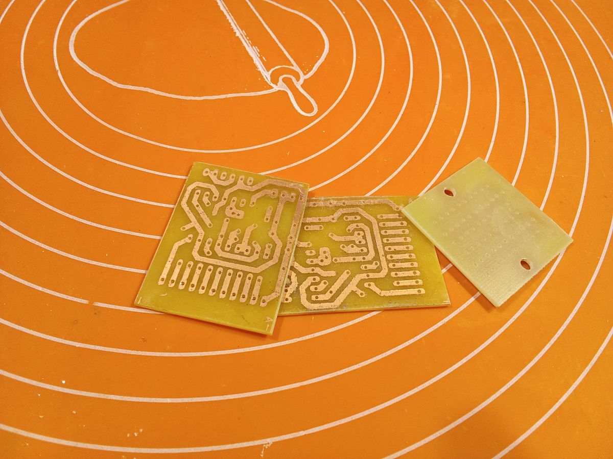

    Once the superfluous copper has been completely removed, the toner needs to be washed off, in my case with f-brand "Dragon" all-purpose solvent. Unfortunately it has one disadvantage - each successive batch has a slightly different composition and sometimes it dissolves the toner completely and without any problem from the plate, and sometimes (different batch) it only "softens" it and it takes a little longer to remove it:
    Items for PCB creation on an orange silicone mat.
    Printed circuit boards before assembly process.

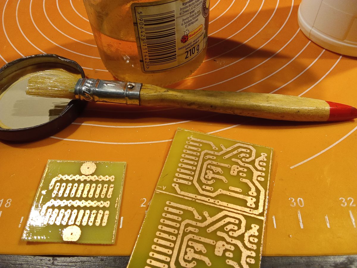

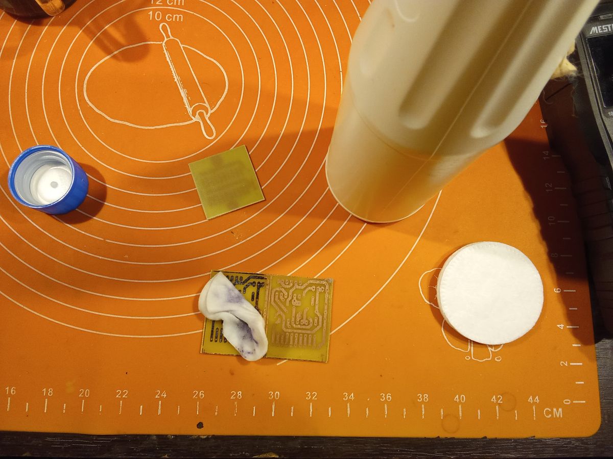

    After removing the toner, it would be a good idea to coat the plates with a rosin solution in IPA. One, this will make it easier to solder the components later, and two, it will protect the tracks from oxidation.
    Printed circuit boards, brush, and jar on an orange mat.
    The rosin coating needs to be COMPLETELY dried before the next step - in my case I put the tiles on a hot electric cooker (induction is not suitable) for about 45 seconds. As soon as you start to see a slight vapour rising from the tile - I turn off the power and leave it until the cooker cools down.
    Thus protected it is ready for drilling and soldering - the rosin coating will effectively protect the copper for decades against airborne contaminants (sulphides, oxides, etc.).

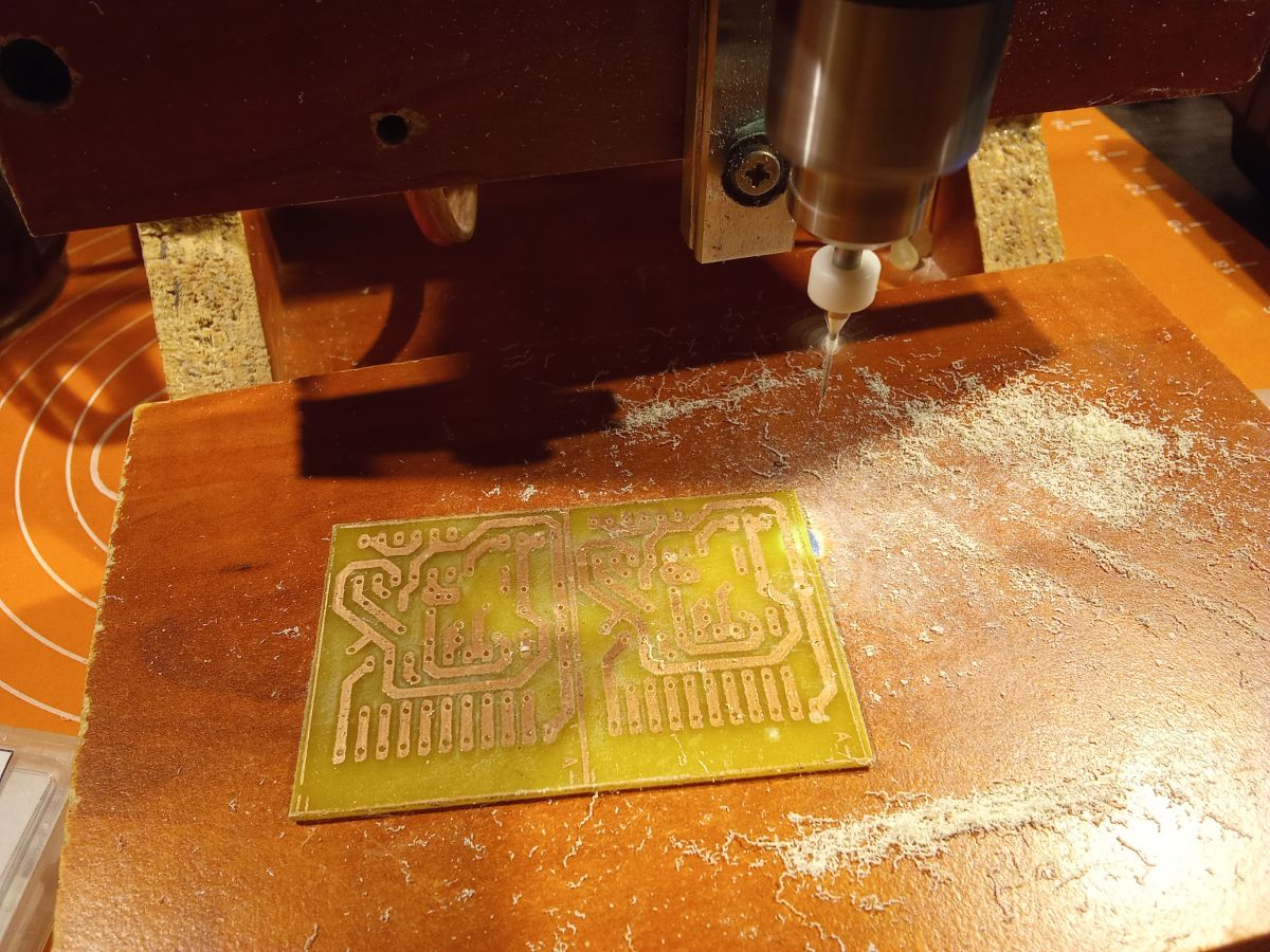

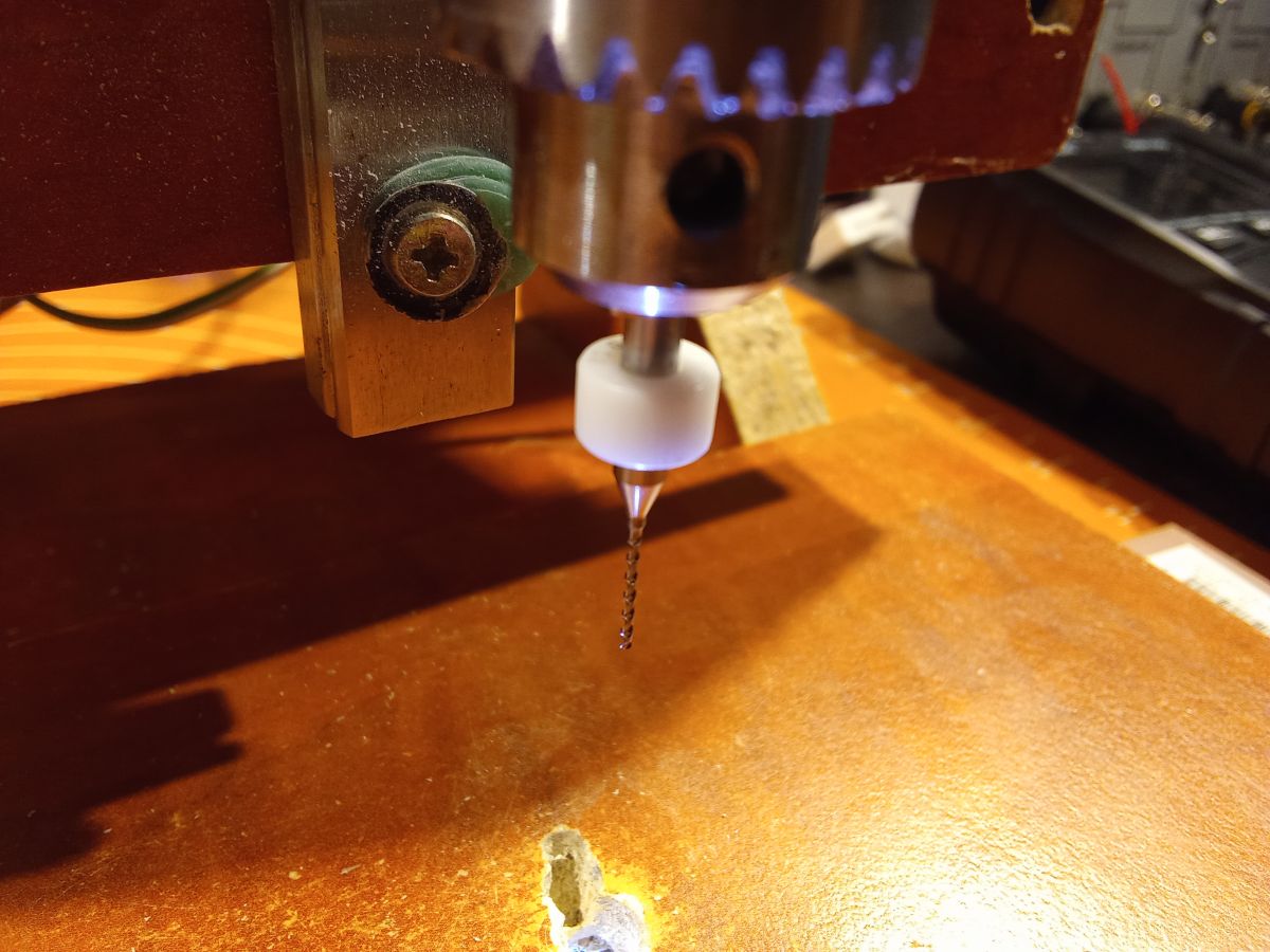

    For a high-speed drill with a precision drill chuck, insert a WIDIA drill bit (I usually use a 0.8mm diameter for most of the through-hole components).
    CNC milling machine with a drill bit above a wooden surface.
    And we drill. If we have the option, it is a good idea to set the speed to max. - A widia drill performs best at at least 10,000 rpm.
    CNC machine milling a pattern on a printed circuit board.
    Holes drilled in this way retain their ideal shape and the pitchfork drills ensure that, thanks to the long life of the pitchfork, the copper around the hole, the 'pad', is not damaged, facilitating correct soldering of components.

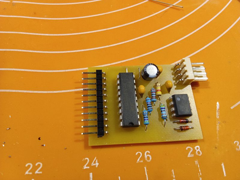

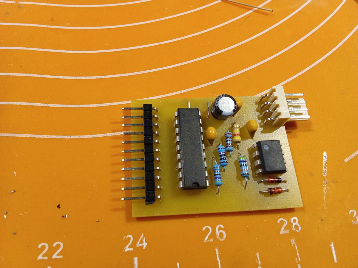

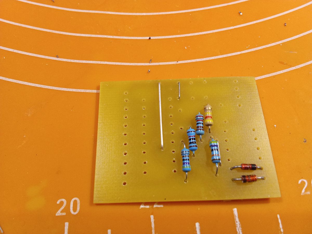

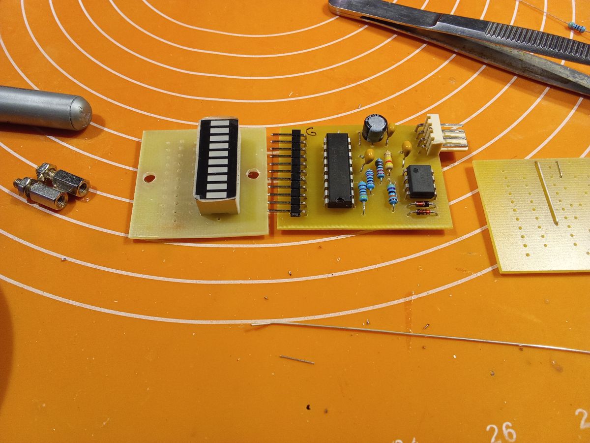

    We have the boards ready to assemble the components. However, before we switch on the soldering iron, it is a good idea to clip a few critical components and check the order in which they should be soldered. In this particular case, this caution applies especially to the board with the LED posts.
    Soldering it with the LM3915 and LM741 (or a similar circuit with a single operational amplifier structure) should always be started by soldering the least stand-off components on the board.
    Prototype board with resistors and diodes on an orange background.
    A printed circuit board with solder points on an orange mat.

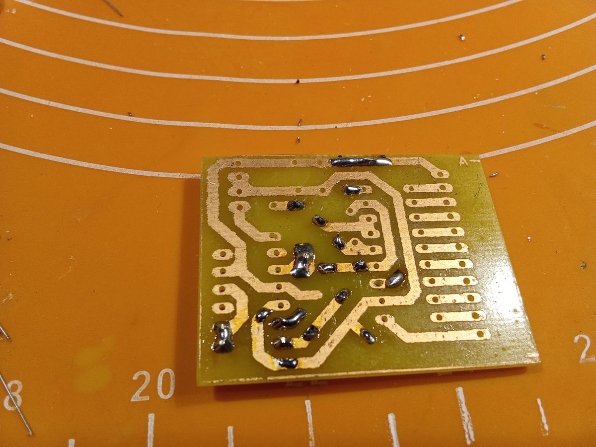

    It is a good idea to supply your soldering iron with a tip that is as precise as possible - with a sharp, thin tip.

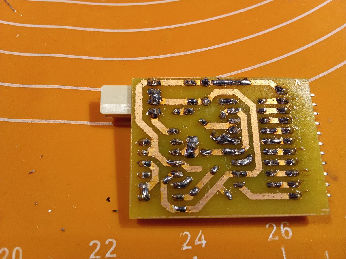

    After soldering the lowest components, it will be the turn of the higher and higher components - this will make the assembly and the soldering itself easier, especially if you do not use a solder holder for the board to be soldered.
    Close-up of electronic components on an orange cutting mat.
    Printed circuit board with electronic components on an orange background with curved white lines and numbers.
    Circuit board showing copper traces and soldering.

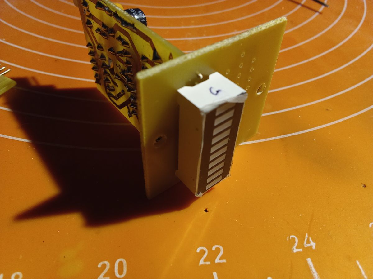

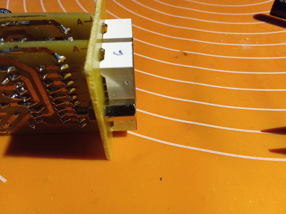

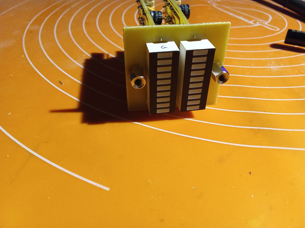

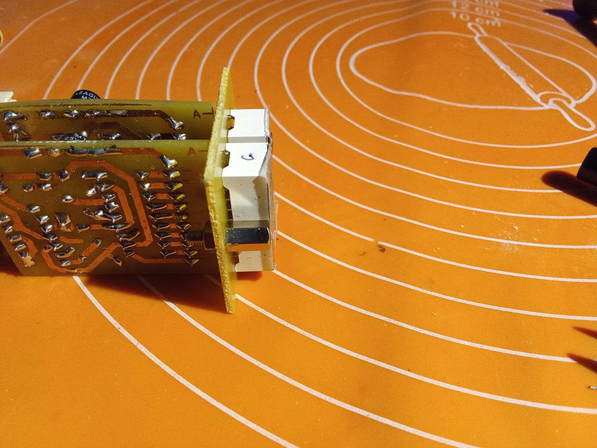

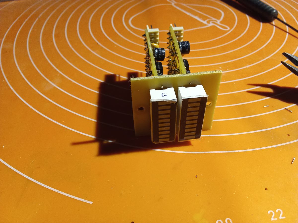

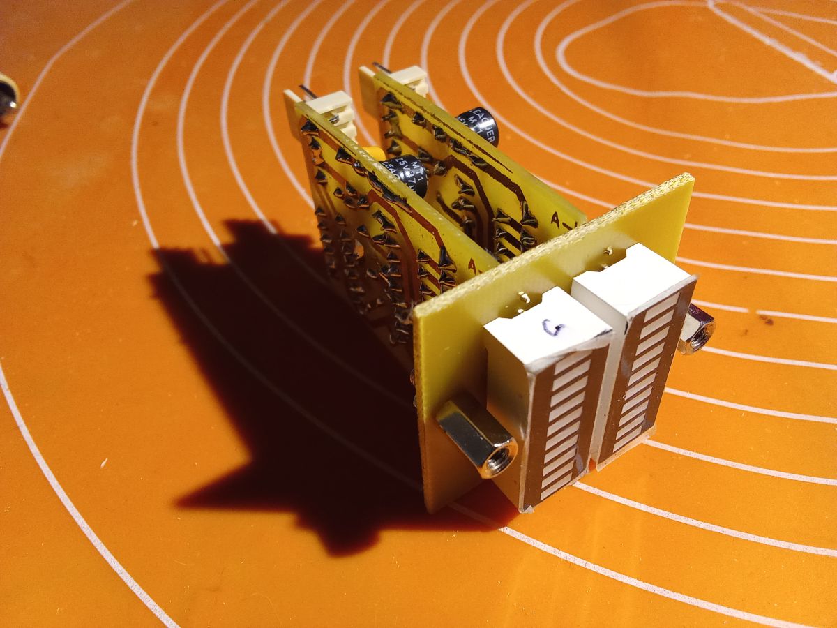

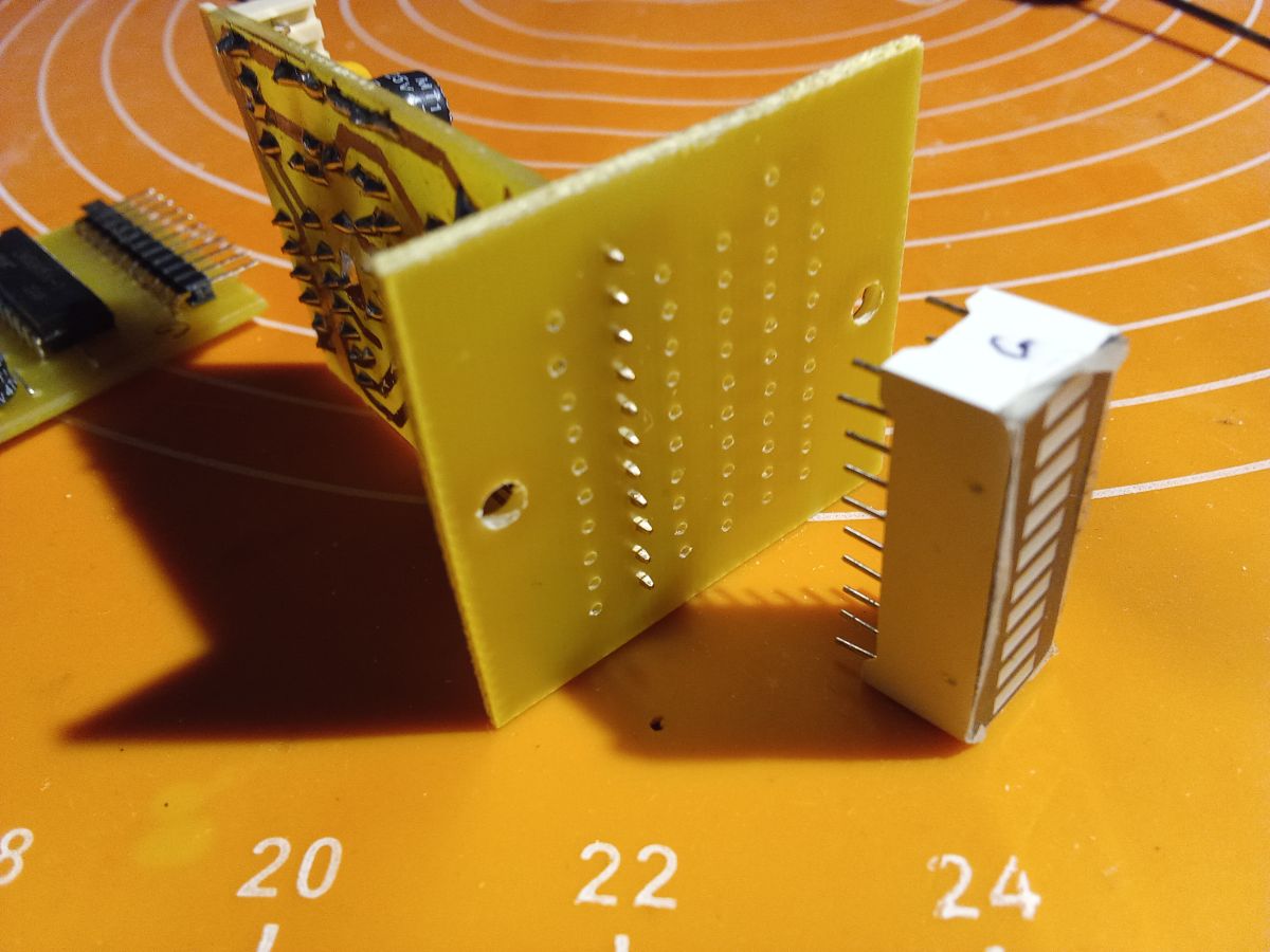

    It's time for some fitting. The LED display board attaches to the controls using angled goldpin strips. Depending on what is available (although the ones in the prototype are the easiest to find) you will sometimes need to shorten the pins going into the display board. The goldpins I've used allow the pins to be left without cutting their length - the protruding ends fit perfectly under the displays.
    Electronic components on an orange mat with markings.
    LED display on a PCB on an orange work mat.

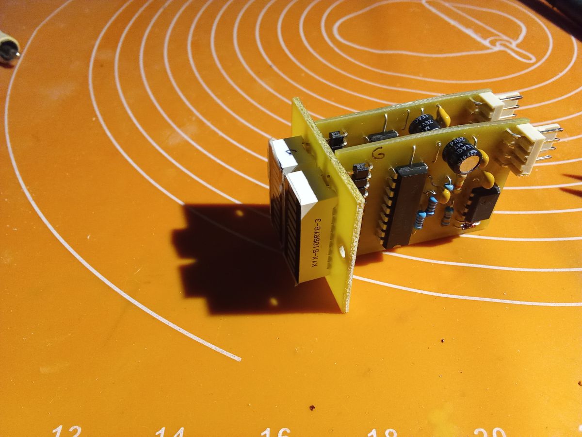

    After soldering, the whole thing looks like the following:

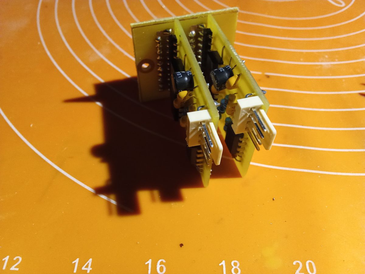

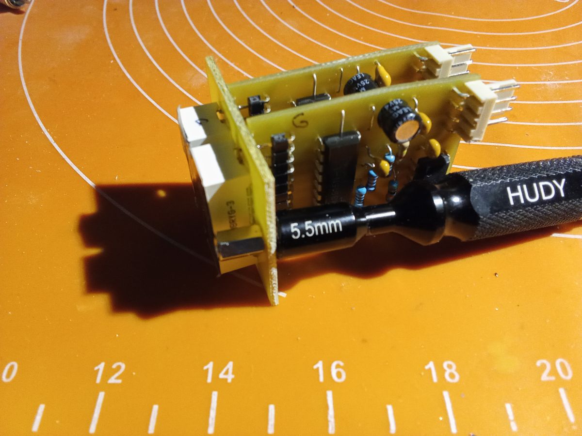

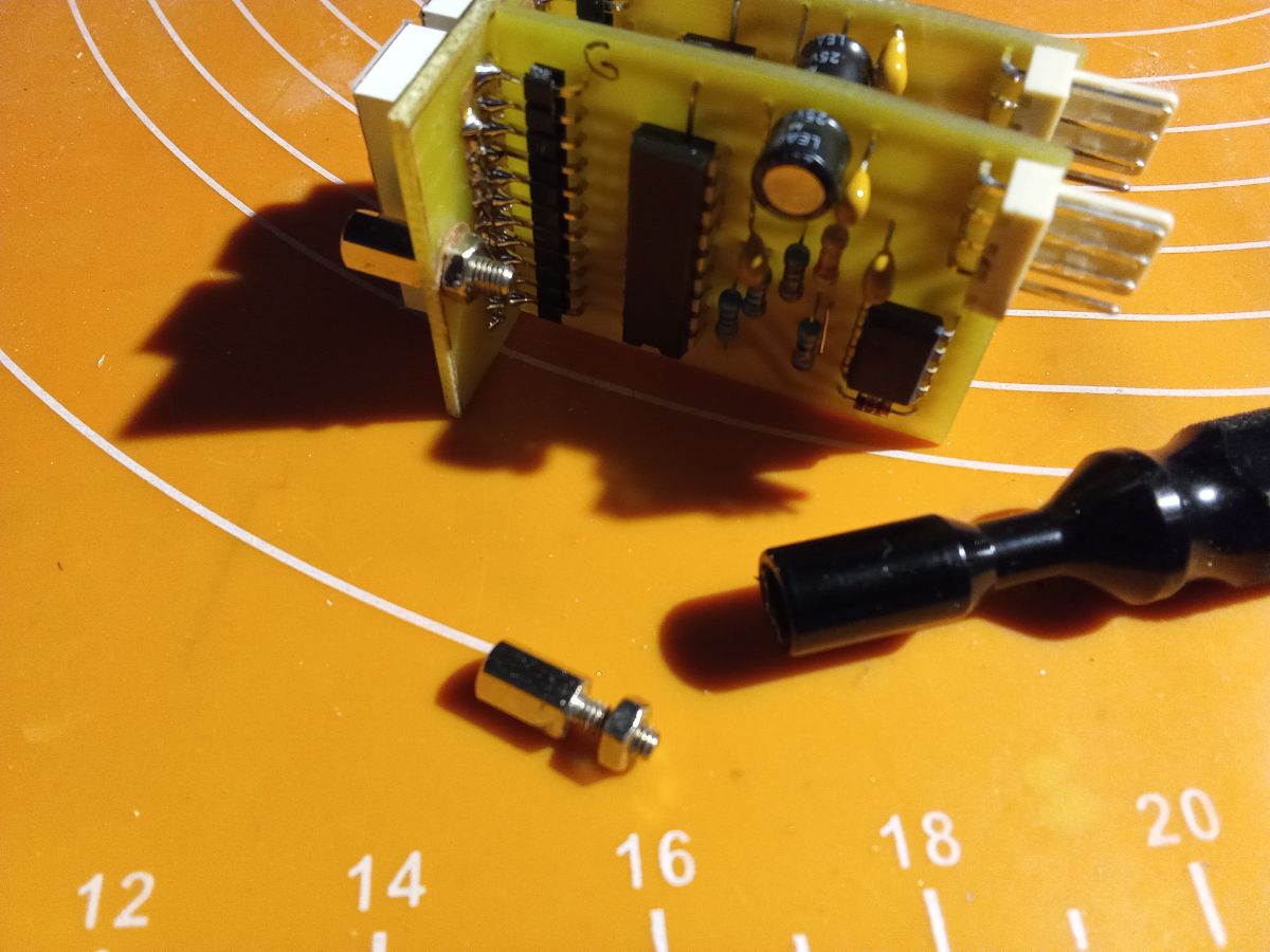

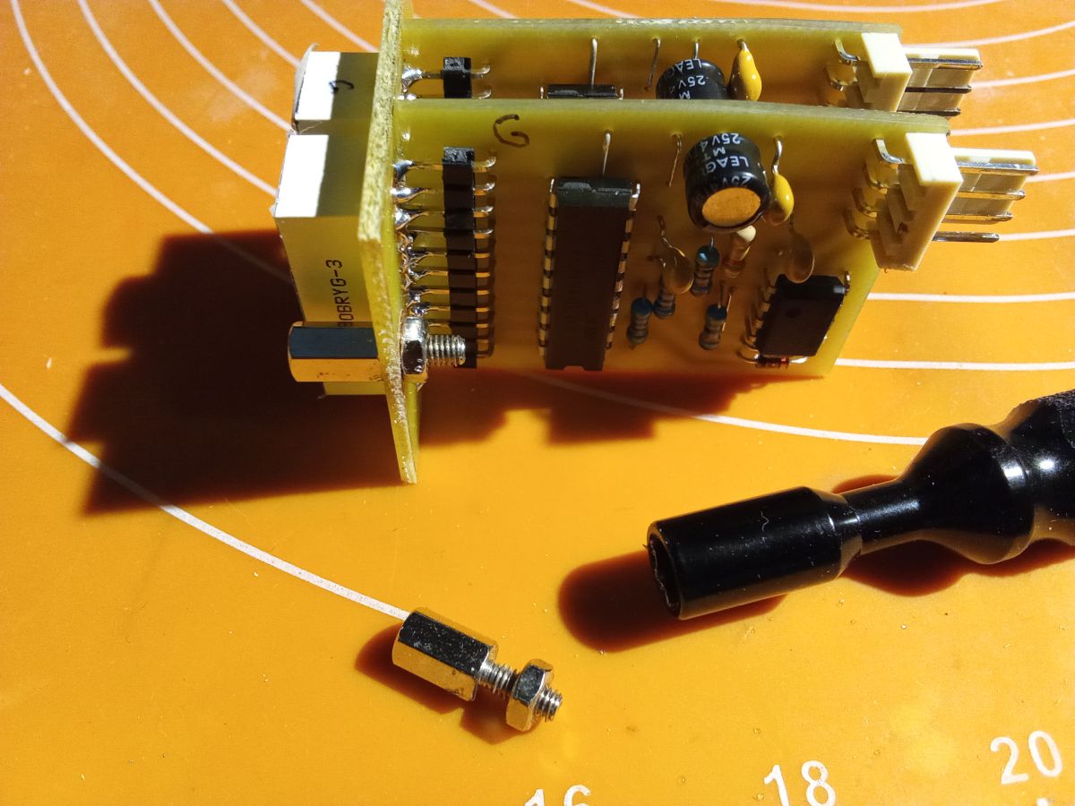

    You can think about mounting the module to the faceplate. My suggestion requires two M3 mounting studs in "girl and boy" design, i.e. with female threads and a threaded pin. For a perfect fit with the faceplate on the inside of the case, 8mm long dowels will fit.
    Printed circuit board with a Hudy tool next to it.
    Circuit board with electronic components on an orange background.
    Electronic circuit board on an orange mat with small components.
    Electronic circuit board with protruding components on an orange surface.
    A printed circuit board placed on an orange mat with white circles.
    Close-up of a printed circuit board with conductive tracks and soldered components, placed on an orange surface with white circles.
    Two segment LED displays on a circuit board on an orange background.

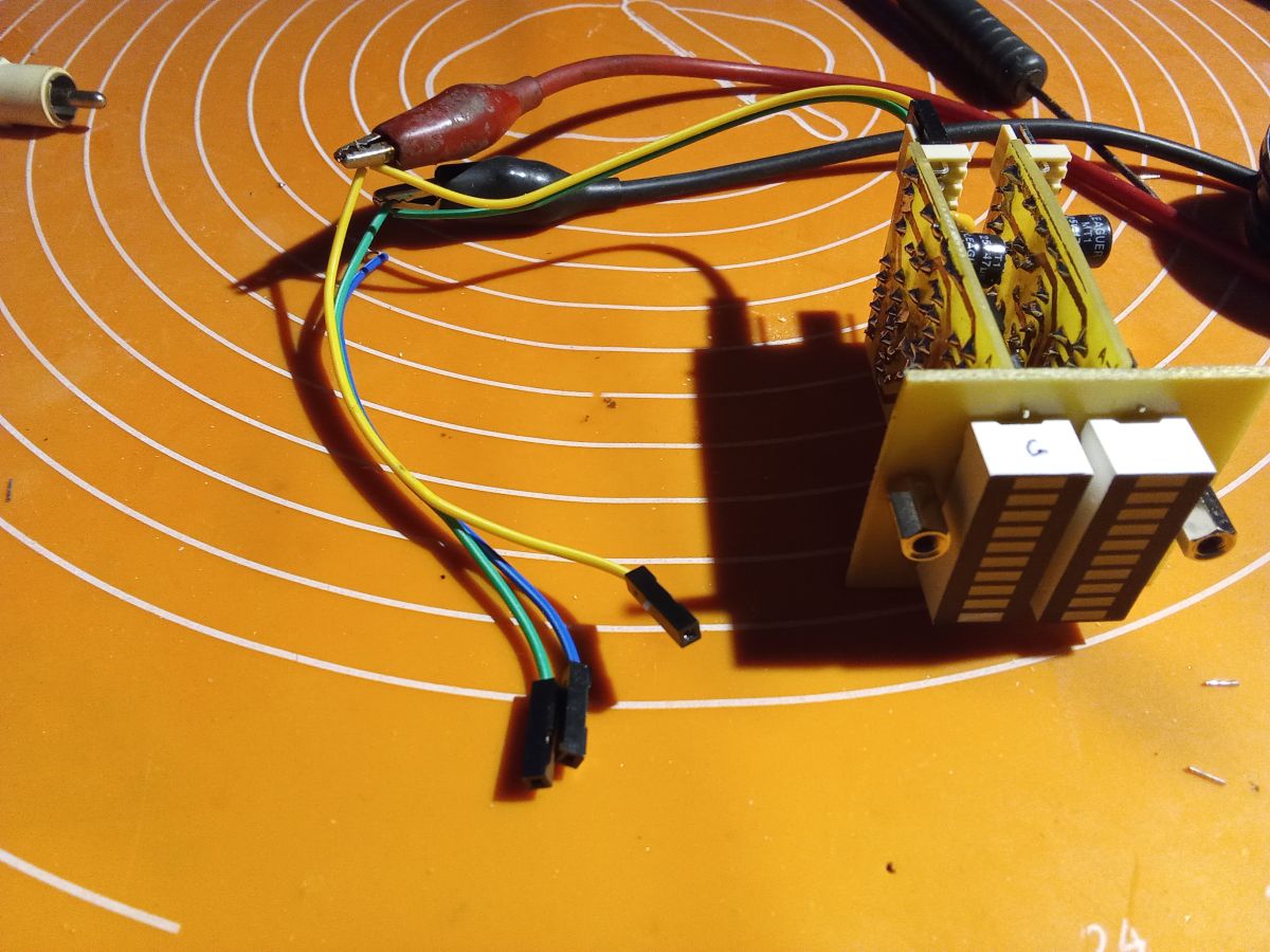

    The size of the stereo indicator module made in this way is, looking at the display panel - 38mm wide, 35mm high, and the depth (from the front of the indicator to the end of the control boards (not including the power and input signal connectors)) is about 55mm. Note!6cbb22087 Since the distance between the driver boards is small (approx.. 12mm), capacitors should be selected as "low" as possible so that there is no possibility of their housings short-circuiting with the pads of the adjacent board.
    The module is powered from 12V (if different, changes must be made to the application components - see the LM3915 chip data sheet for more. For example here: http://www.datasheetcatalog.com/).
    In my case, I chose the 3915 from the LM391* family, as this chip works best as an amplifier drive indicator. If someone wanted to use such an indicator, e.g. for a tape recorder, it would be appropriate to use the 3916, which has a "stretched" section of sensitivity around 0dB. This will allow a more precise setting of the recording sensitivity without the danger of overdriving the signal.
    Now about the sensitivity adjustment of the indicators themselves. In a design like the one in the diagram, the signal sensitivity will be around 0dB (0.775V), and to some extent this value can be varied by selecting resistor R13 (according to the markings in the diagram). However, in a situation where we would like, for example, to connect this indicator to loudspeaker outputs, we cannot do without a voltage divider selected according to the maximum voltage at the amplifier output adjusted to +3dB. In such a case, the indications of the indicator (leaving R13 as in the diagram) will accurately show the amplifier's state of drive, taking into account momentary "peaks" for the loudest moments of the recording.

    A few words about the LM741 application. This circuit acts here as a signal rectifier; it converts the variable music signal into real-time DC voltage fluctuations. In addition, the diode chip (1N4148 or any low-power silicon diode) provides a QUASI-IDEAL rectifier circuit. That is, it includes both halves of the signal - above and below zero - in the output voltage value.

  • B327 etchant concentration affects PCB gouging
    #9 21545716
    efi222
    Level 22  
    Posts: 779
    Help: 12
    Rate: 1219
    398216 Usunięty wrote:
    The pole reaches maximum indication in about 1/10 of the time it takes for all the LEDs to go out
    Interesting information. I've always wondered with my designs what the delay should be when the bar falls and averages (response to rising audio levels).
    The PCB has some gouged paths. Maybe too strong a solution?
    Everyone has their own patent for making PCBs. I do half the concentration recommended for B327, as I had similar effects with a stronger one.
    Very detailed description of the construction a plus.

    PCB has a bit of a stoked pathway. Maybe too strong a solution?
    No, it is the fault of too short a "pressing" time. Normally (worked out by experience) the ironing time with me should be 4 minutes, here by mistake the ironing t6took a minute less.

    Well, my colleague has gone over the edge.... Please take a look at the internal schematic of the LM 391* and consider what the Colleague has written. DS available at the link provided in the article...
    Mastertech wrote:
    There are plenty of ready-made such modules on the LM3915 to buy for pennies.
    Please - compare these circuits first and then punch yourself in the breast and correct these revelations. Yes there are "off-the-shelf" but truncated from the "real" rectifier circuit - in this "microproject" realised on WO.
    Believe me - the difference in performance is huge.

  • LM741 stage is a single-voltage rectifier
    #16 21546021
    Janusz_kk
    Posts: 5867
    Help: 228
    Rate: 1478
    A few words about the LM741 application. This circuit acts here as a signal rectifier; it converts a variable music signal into a real-time DC voltage swing. In addition, the diode chip (1N4148 or any low-power silicon diode) provides a QUASI-IDEAL rectifier circuit. That is, it includes both halves of the signal - above and below zero - in the output voltage value.
    This is not true, this is a single-voltage rectifier, it only rectifies the negative input half-wave, for the positive one the diode d12 is conducting at the input which gives -0.65v at the output relative to the input and the diode d11 is in reverse.
  • #17 21546133
    acctr
    Posts: 4554
    Help: 389
    Rate: 2025
    Janusz_kk wrote:
    for positive, diode d12 is conducting at the input which gives -0.65v at the output relative to the input
    Wrong, the output is then about -0.65v but relative to the REFA.
    you have to take into account that a 10-point indicator for PRO equipment is a bit low...
    I just happen to have something from the Behringer stable to replace switches and here the indicators are 12-point. I don't have the nerve at the moment, but once I've opened it up I'll post pics.
    Screenshot from the SM twin model;
    Schematic diagram of an audio level meter circuit with operational amplifiers and 12-step LED indicators.
    The only major difference is the fully symmetrical +/- 15V supply.

    acctr wrote:
    Wrong, the output is then about -0.65 V but relative to the REFA.
    Not at all, it comes out to the same thing with the accuracy of the unbalance voltage.
    Janusz_kk wrote:
    output relative to input
    because it was about the input of the amplifier and not the circuit which was obvious to me but as you can see not everyone caught that.
  • Clarifies op-amp input terminology and accuracy
    #20 21546499
    acctr
    Posts: 4554
    Help: 389
    Rate: 2025
    Janusz_kk wrote:
    Not at all, it comes out to the same thing with the accuracy of the non-equilibrium voltage.
    Note the use of the word 'about' with the key meaning there.
    This circuit is an amplifier so you still can't write precisely what you want to convey and if you have taken to lecturing then it would be appropriate.
    When describing in detail the operation of a circuit based on an operational amplifier you do not write "input" but "inputs" or "non-inverting input" or "inverting input".
  • #21 21546874
    Janusz_kk
    Posts: 5867
    Help: 228
    Rate: 1478
    acctr wrote:
    This circuit is an amplifier so you still can't write precisely what you want to convey and if you've already taken to lecturing it would be appropriate.
    I have written precisely what you want to convey.
    I wrote precisely
    Janusz_kk wrote:
    that is not true, it is a single-voltage rectifier,
    and not a full-period rectifier as suggested by the author.

    Janusz_kk wrote:
    Janusz_kk wrote:
    this is not true, it is a single-voltage rectifier,
    Since you're quoting my statement I'm surprised you didn't notice the word QUASI ideal rectifier. It didn't say a word about a full-period rectifier:
    takes into account both halves of the signal in the output voltage
    I have written it takes into account and yet there is a difference.
    If you had noticed this you probably wouldn't need to write several unnecessary posts.
