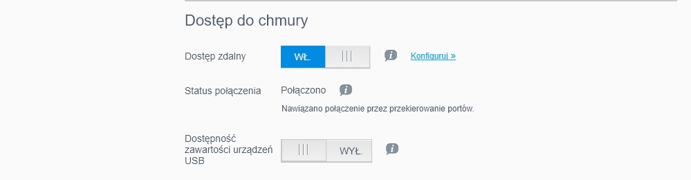

    still in the "cloud access" section I get a prompt:
    "Connected (indirect connection established)
    Port forwarding was unable to establish a connection on port 8082 and port 8443. "
    In the attachment screenshots from the router configuration, because I suspect that the problem is on his side.

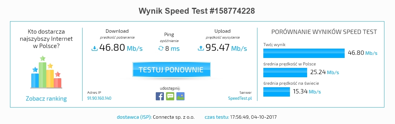

    Internet Connecta (Bielany Wrocławskie).
    in the attachment the speedtest result.
    I have a different address on WAN than I have seen so far, but I have no idea if it is public. I also attach a screenshot of the configuration.

    I got the public IP address and the device configured itself properly :)
    Thank you for your help and good advice :)
