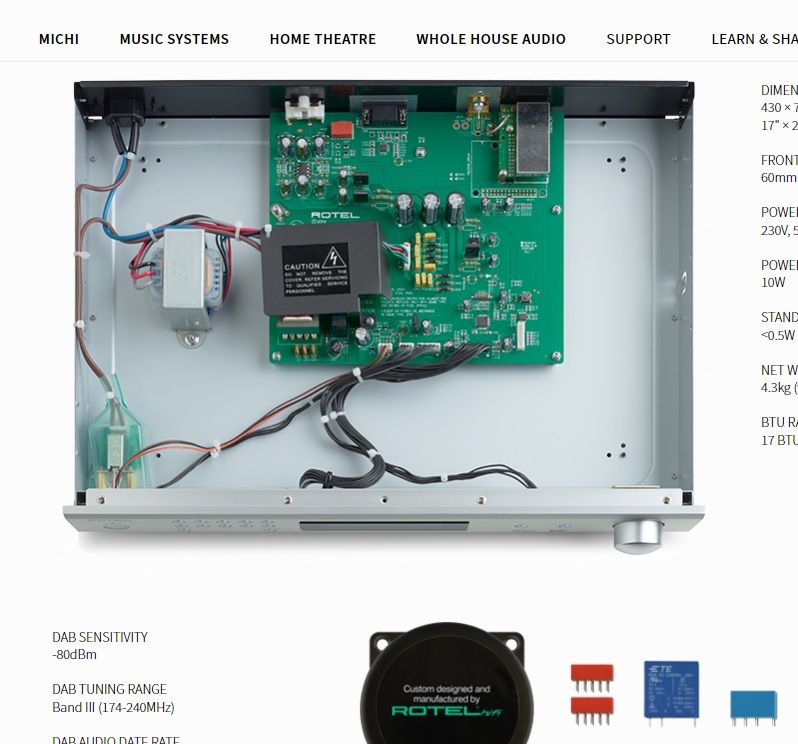

    By the way, what does an FM/DAB tuner look like today?
    Well, let`s take a look at the tuner for about PLN 2,000
    Interior of a Rotel FM/DAB tuner showing electronics and specified technical parameters.
    we also have a specific DAB sensitivity - 80 dBm (which seems closer to the truth)
    But what is this structure? The entire FM and DAB TUNER is this small box with probably 2 ICs in it that do everything.

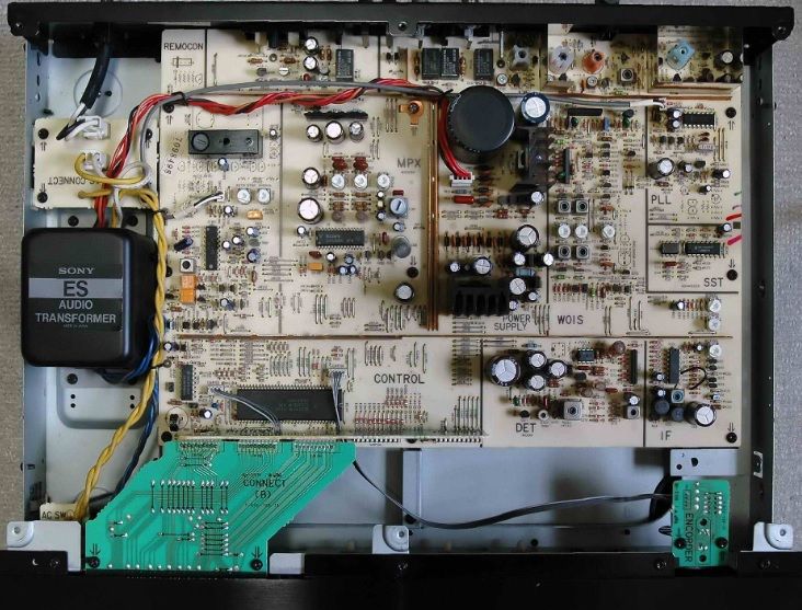

    And, for example, Sony ST-S770 from the best years
    Interior of a Sony ST-S770 tuner with visible electronic components.
    Well, I guess no comment.
    What do you think? Record 100dBm too correct
    I suggest you first read what these letters mean (and whether the "-" sign is important here or not)

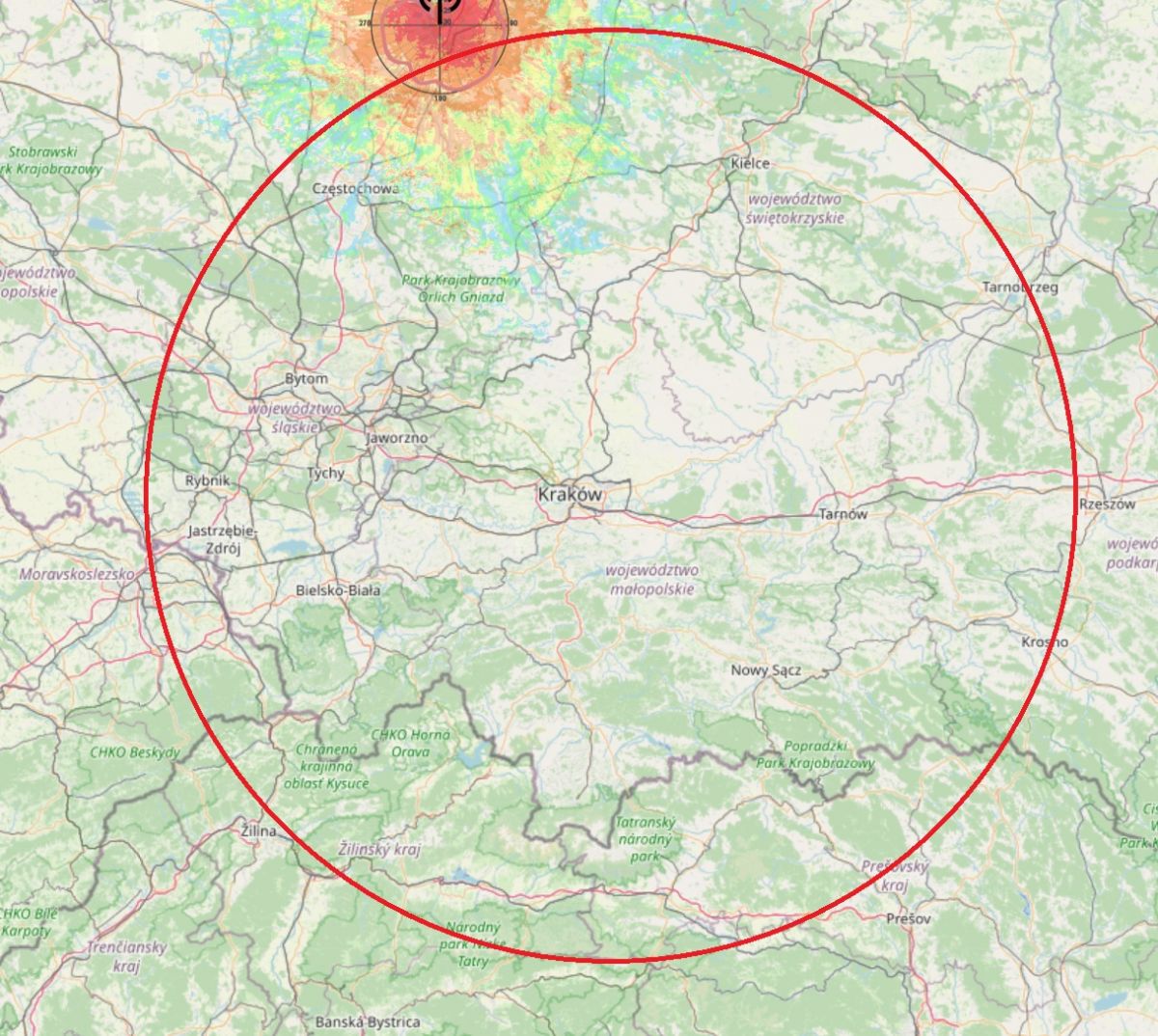

    First tests
    Kraków QTH: KO00AC02
    Reception without problems (other weaker stations) - I missed local or very strong stations.
    MUX Świety Krzyż 215.072 MHz (ERP 10 kW) - Emitel
    MUX Prehyba - Szczawnica 211.648 (ERP 1 kW) - DABCOM
    MUX Tarnów Góra Sw Marcina 206.352 (ERP 0.3 kW) - DABCOM
    I presented more difficult "receptions"
    Here is the approximate range:
    Map showing the reception range of a signal around Krakow, marked with a red line.
    The antenna is X-300 (yes VHF), it is what it is, the feeder is about 35m half-inch :)
    This morning I caught Łódź, but on the border
  • #22 20985186
    sq3evp
    Posts: 6714
    Help: 226
    Rate: 901
    These are very good results in my opinion :)
    X-300 seems to be a 2m/70 cm antenna - maybe it would be worth building something for the DAB range?
  • #23 20985198
    BANANvanDYK
    Posts: 7818
    Help: 1167
    Rate: 2602
    Today, a tropo is passing over this part of Poland, I don`t see anything strange in the reception of these stations.
