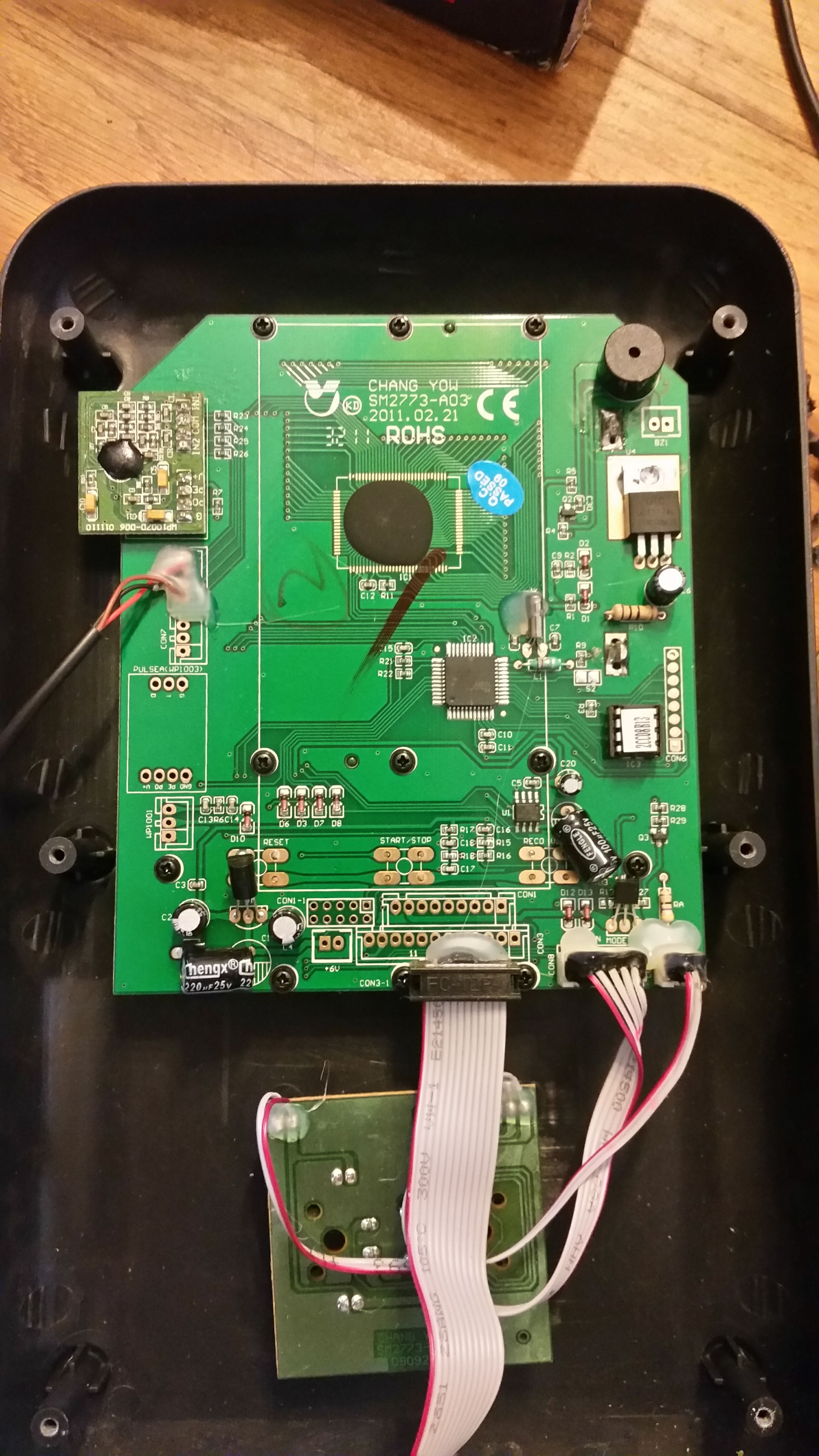

    I have THORN e3000 elliptical cross trainer. Recently regulation has broken down. The elliptical cross trainer has its own computer in which programs can be run. I was checking the engine that pulls the magneto-brake cable and works. I checked the power and control cables from the computer and they are OK. It turned out that the control motor after releasing the cord, after connecting the power supply to the elliptical cross trainer, rotates the tensioner by almost 360 degrees and it seems to me that it should at most 45 degrees. Can anyone help me and give me an idea how to fix it? I attach a photo of the computer Thorn elliptical cross trainer E3000 - The elliptical cross trainer does not wor

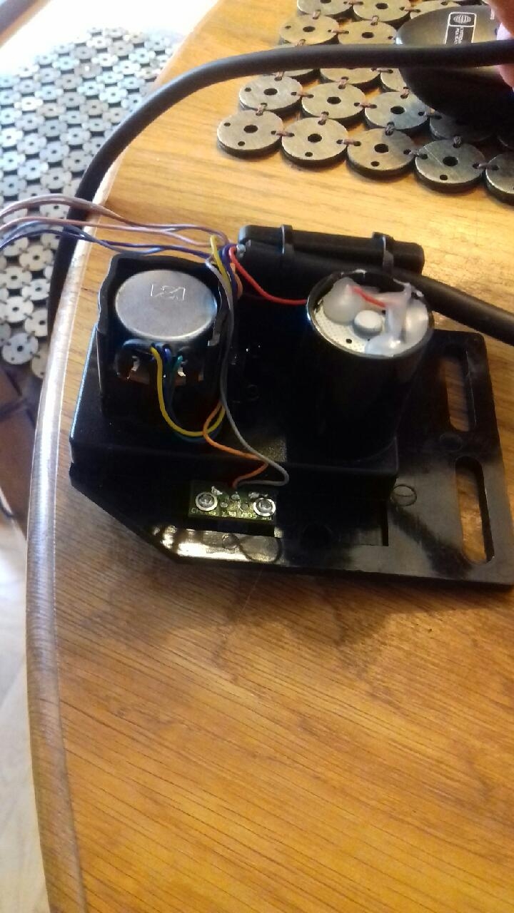

    How many cables go to this motor for load regulation? It probably has a built-in encoder that has failed. It's best if you put a photo of this engine.

    To adjust the load goes all the widest tape visible in the photo above. Of this entire tape, only 3 cables supply power and ground to the computer, and 2 cables provide a signal from the wheel rotation sensor. The controller motor is 2 cables and the rest is an encoder, probably three cables. On Monday I will have access to the device and I will send a photo

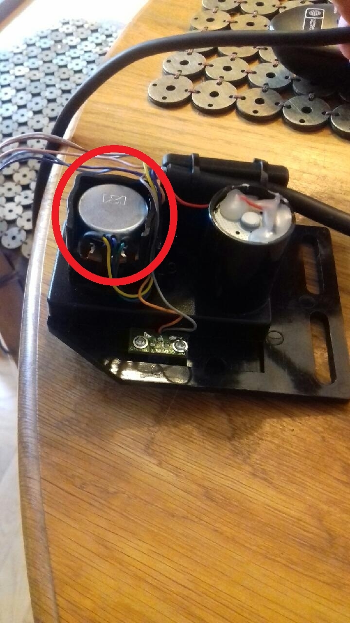

    I need help again, because this econder turned out to be a B5K rotary potentiometer. Any ideas?

    Check the correctness of the potentiometer's indication with a multimeter if the resistance of the plant increases / decreases linearly. Because he is the potential culprit. The whole system works on the principle of servo.

    On the first and second contact the resistance from 0 to 5 kohm is fluid, then from 5 it jumps at 7.6 kohm and so flows to 8.3 kohm and so in a circle that is from 0 to 5 then 7.6 to 8.3

    Should I understand that the potentiometer is without lock rotates around? If so, the indications are ok.

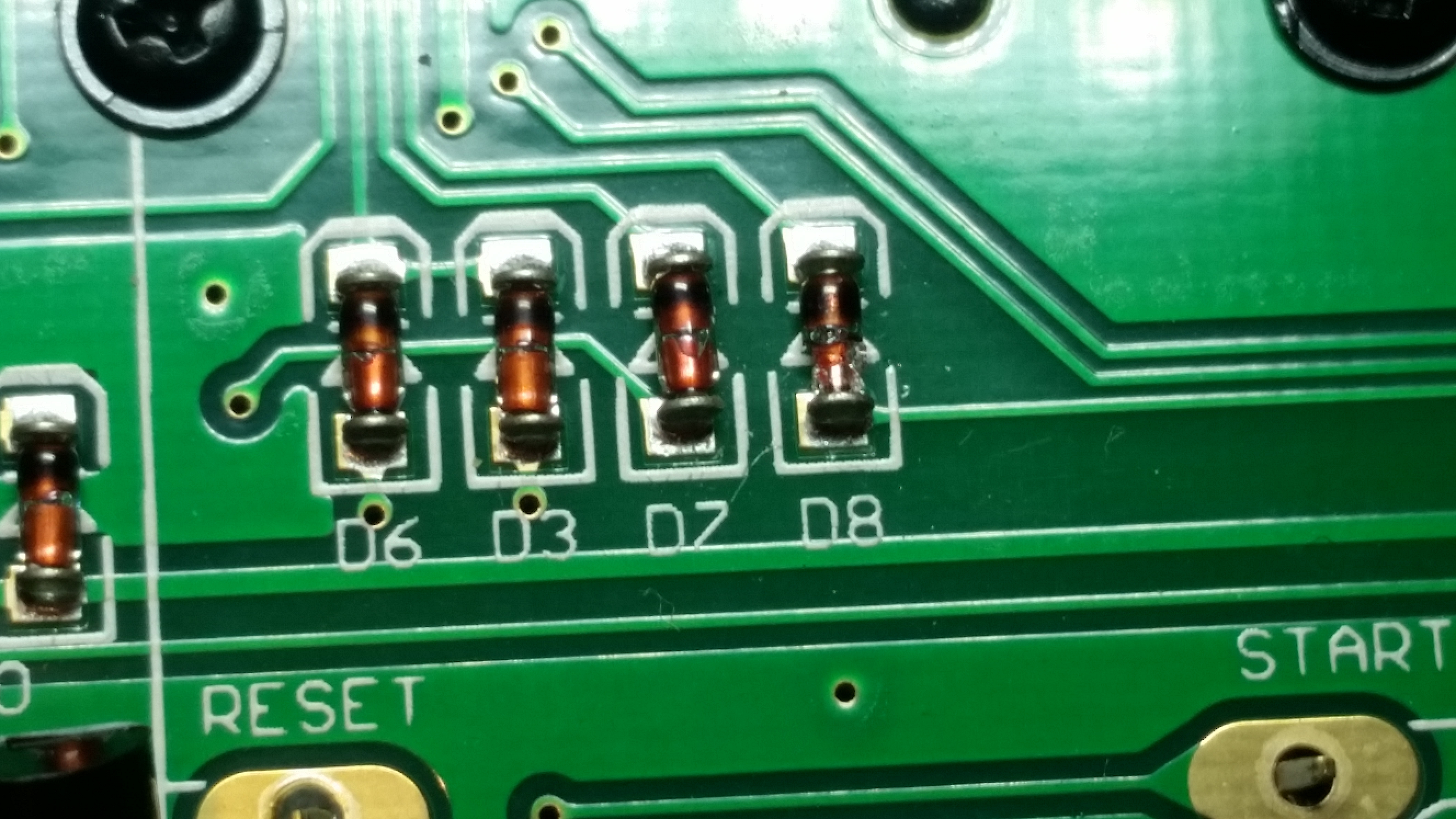

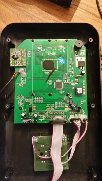

    While checking the computer board, I noticed that the D8 diode is chipped. Multimeter measurements show nothing in both directions. It seems to me that all the LEDs next to D8 were the same. On the others, the multimeter measurement in the diode checking mode gives a result of 560, while in the ohm measurement mode it gives a result of about 1200 k. What diode could I solder in place of the damaged one?

    What a colleague has measured does not say much (it only says that it is a silicon diode - 0.6V voltage drop), please upload an accurate photo of this diode, someone can recognize. If it has any symbols, try to read. It can be a diac, zener diode or other invention.
    Here on page 3 you have the LEDs designation based on the colors of the stripes (mask code).

    No markings visible

    It looks like a regular switching diode LL4148 but let somebody else speak because I am not a specialist in SMD.

    I replaced the diode with a new one and the equipment began to work as it should, i.e. I could freely control the tension wheel using a computer but after a few minutes the problem returned again. I checked the diode and it's ok.

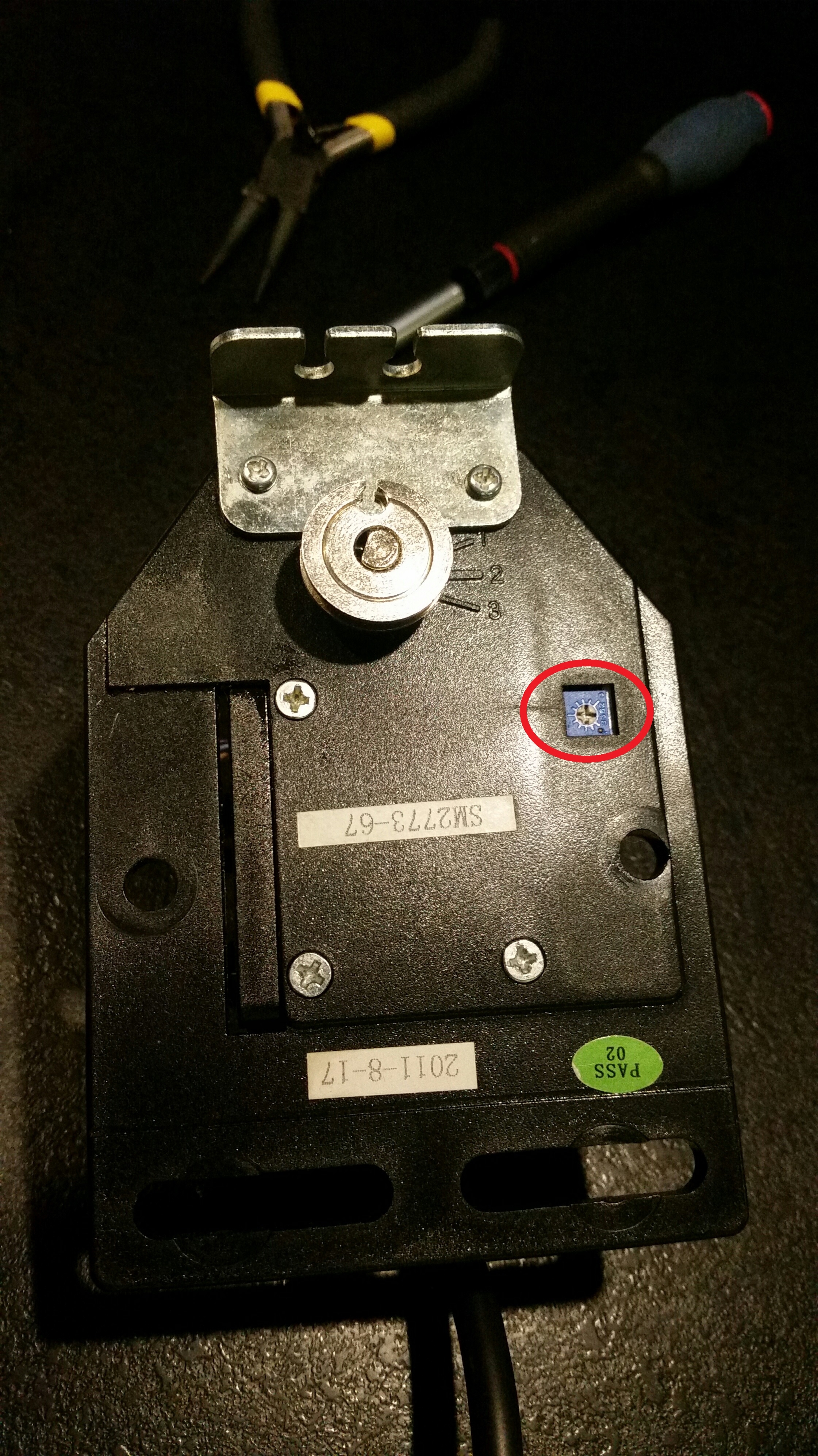

  • #19 16762451
    ekler0z
    Posts: 120
    Rate: 15

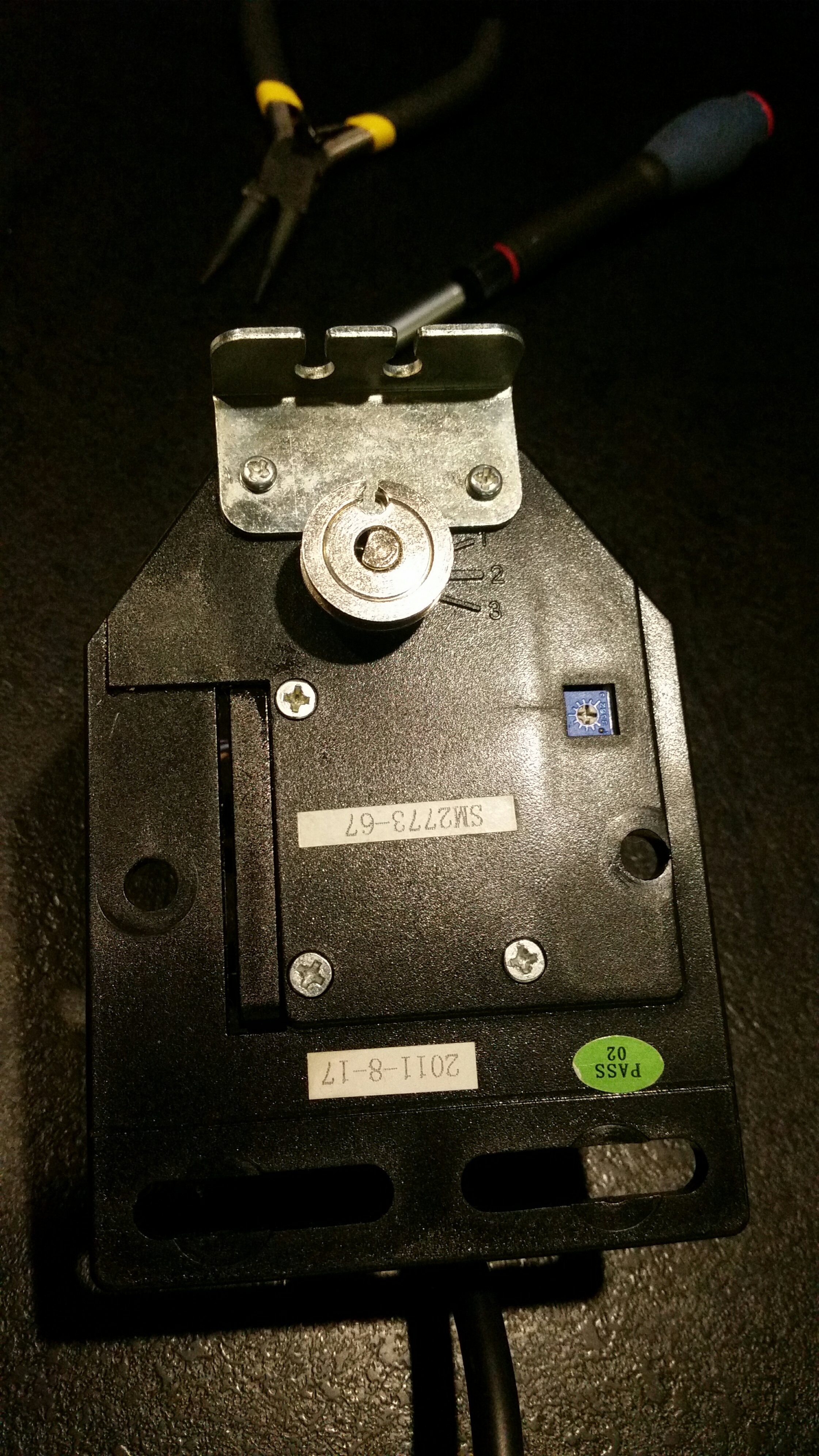

    Another breakthrough in solving my problem. A small potentiometer in the actuator is used for precise adjustment of the cable tension and if I set it to the appropriate value then after connecting the power supply the tension wheel after 360 degrees rotation apparently sets in such a position that it starts to operate normally. Today I will fly to the store for a potentiometer (the big one) because probably like a colleague a few posts above suspected, it is damaged. There is a moment in adjusting the computer knob that the tension wheel begins to go crazy in such a way that e.g. it turns in the wrong direction and if the knob "jump this point" then everything is ok. I suspect that at this point the tensioner wheel normally stopped and after reading incorrect potentiometer values - the computer was stupid.
