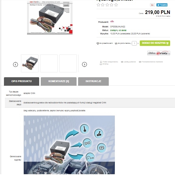

    karwas922
    Hello, I have a similar problem. I'm thinking of buying that Delphi F250FL Radio in Ducato 2014: CAN Communication Error & Traction Control Messages but will this help solve the whole problem ??? Regards
  • #7 16761928
    LWD11
    Posts: 1406
    Help: 223
    Rate: 486
    This is the interface from CAN to analog, here you need the reverse from analog to CAN.
