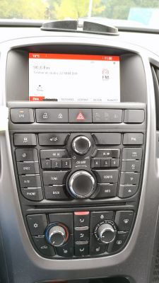

    Hello, I have a radio with Android9, some functions on the display do not work. The seller told me to do a restart but nothing helped, then he told me in the options in the settings, it will probably be in the canbus settings section as "air condition". What is this canbus. Some kind of application, but I don't have any on the radio. Whether to update the android to a newer or just it does not matter. I'm green on these things. Regards

    So a radio dedicated to a specific car model. In the description there is "OBD cooperation option" and now a horse with a row of who will guess whether it is or not :) but you have to look in the radio settings to see what setting options are available and if you can choose something to work with the car. And I understand that you mount it to the Honda as described in the seller description :)

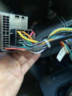

    Gentlemen, I have a problem, I bought a Chinese radio with a built-in can for a caddy 2013. And the thing is that the radio fires for a moment after the key, works for a few seconds and turns off ...
    Anyone had such a case?

    And the situation is such that in the key position "0" the radio works, after turning to "1" and the engine is running, the radio turns off.

    Bassic, you pack a Chinese radio without a Can bus adapter, do you want it to work with can? - It will not work.
    And you checked the radio power supply, how are you connected in relation to the signals from the car beam? -You obviously failed.
    You have the schedule on the radio sticker and the car sockets in Google, just enter the car model and you have it.
    You didn't even bother to read the links above where and how the radio power works - that's where I described how to connect the power supply.
    Until you knock this lesson, you won't do it.
    The radio and without the CAN-BUS adapter will work if you connect the power correctly.
    There is an option that sometimes you need to reprogram the controller in the car, but when you have the can properly connected and communicated with the Can-bus adapter.
    And you don't have a Can-bus adapter and you're looking for a hole in the whole - I can't see it in the photo.
    Read these links what I posted, and there he writes how to properly connect.

    Please enter the brand of this Chinese radio, what has a built-in can-bus adapter, I am very curious? Having a can control in the radio is not a radio with a can-bus adapter . Missed something?
    Added after 7 [minutes]:
    If you have a non-Chinese radio, what are you doing here with this topic? This topic applies to the can-bus adapter (for what, etc., what is behind it)?
    Since you have a radio that works (it's certainly not Chinese, but on Android), you have a problem with the power supply or the geteway driver. (I bet on both).
    Added after 11 [minutes]:
    The photos show that you have no power after the ignition (on one of the wires) I'm sure I'm wrong? I wrote what you need to do, and you don't want to read. (radio without connected can control should work properly connected) The VW Group is always the same. Can can cause such a symptom after connecting can because it is definitely a badly programmed driver . I wrote it to you clearly.
    I am curious about this "Chinese" radio, what is this model?
    Added after 4 [minutes]:
    Disconnect the Can cables and the radio will come to life if you have connected them correctly, you will be left with the car's getway programming (correct).

    Problem solved,
    The car was not equipped with the original radio and the gateway did not have it programmed, it was enough to code the radio.

    This is exactly the radio:
    Title: Canbus in Android9 Radio: Functions Not Working, Air Condition Settings & Updates
    Gateway had no encrypted radio and probably disconnected after a few seconds.
    You suggest your case with a radio that needed a can-bus module.
    China is moving with the times and now the module is already built into the radio.

    I will step on the topic.
    My car is an Opel Astra J sedan with factory LPG. The radio installed in it is a CD600:
    without navigation and rear view camera. You can say that it is the top of the middle shelf. Through this radio, I can control many vehicle settings, incl. the settings of the air conditioning, central locking, door locks or the settings of the lights that are on (or not) after removing the key from the ignition switch. (Full list of possible vehicle settings on the linked video (sorry for the trembling hand): https://www61.zippyshare.com/v/XVb3z1Es/file.html)
    I am going to replace this radio with a Chinese "Tesla" dedicated to this car model:
    https://pl.aliexpress.com/item/33059664247.html but, on the basis of observations and chats with the owners of this "miracle", I am afraid that the vehicle settings functions that I currently have may not be available from the level of this Tesla. I can not get detailed information from the owners, because everyone I talked / chatted with had lower radio models, and thus also poorer in functions.
    And now I come to the point: are these settings / functions "sewn in" in the radio software, or is the radio just a relay (like a keyboard or a mouse) between me and the car's central computer?
    I am asking for two reasons; first - a Chinese seller says: " All the setting can be the same like before, because it is controlled by the canbus. If you can set is on your old radio, you can set the same on sinosmart car player new screen . " ( All settings can be same as before because they are canbus controlled. If you can set it on the old radio, you can set the same on the sinosmart car player to the new screen .) and secondly; when I wanted to install a reversing camera, it turned out that I had to send the radio somewhere near Bydgoszcz (I am for Silesia) in order to reprogram it, because only there is a specialist there, who will take it relatively cheaply.
    The conclusion from here - maybe wrong - that it all sits in the radio software and if so, the canbus will not help in anything here.
    I will be grateful for making me aware and explaining what, how and why ...

    One principle is that the replacement radio does not necessarily have all the functions programmed for this car model.
    Can-bus is a device that translates radio signals to the Can bus of the car and vice versa - this kind of signal translator.
    It is always dictated by the price.
    A good replacement has everything 100% in it and each cable is suitable for connection including can-bus DAB + etc.
    You buy simple ones, check them, send them back to shit without unnecessary discussion. Everything is supposed to be the same and work.
    Before buying, check visually if they fit the same. After purchase, the radio is not taken for such money - because the camera does not work - it is supposed to work. "With this camera, it was enough to set it in the factory hidden menu - knowing the code from the seller or in the manual".
    A friend bought a replacement for a Mercedes for PLN 1,200 - good that he sent it back. He bought the second one for 1800 PLN, everything had and works.
    The cables themselves can ruin you if the wrong version will be sent.
