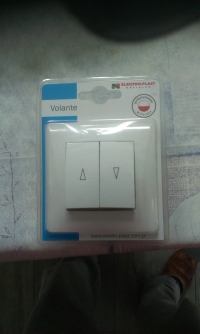

    I need to connect external roller blinds to external roller blinds. I tested them on one Geze switch and it's ok, i.e. they work, but the problem is that I'm a layman when it comes to electrics. In the Geze switch I had everything marked with symbols. "L", "N" and grounding and there are two free directions, ie opening and closing of the roller shutter. And everything was clear to me :) However, I only had one such switch, so I bought another one to have all the same.
    Below photos of the switch

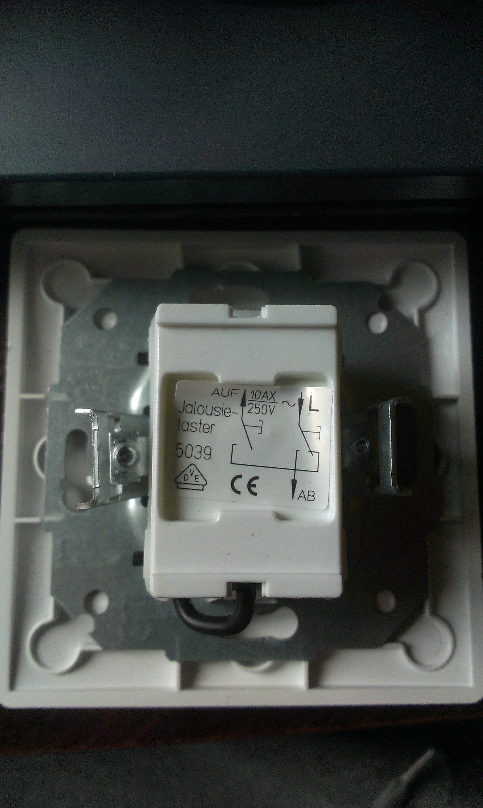

    Now the diagram on the switch:
    Connecting External Roller Blinds to Elektro-Plast Switch: Comparing with Geze Switch

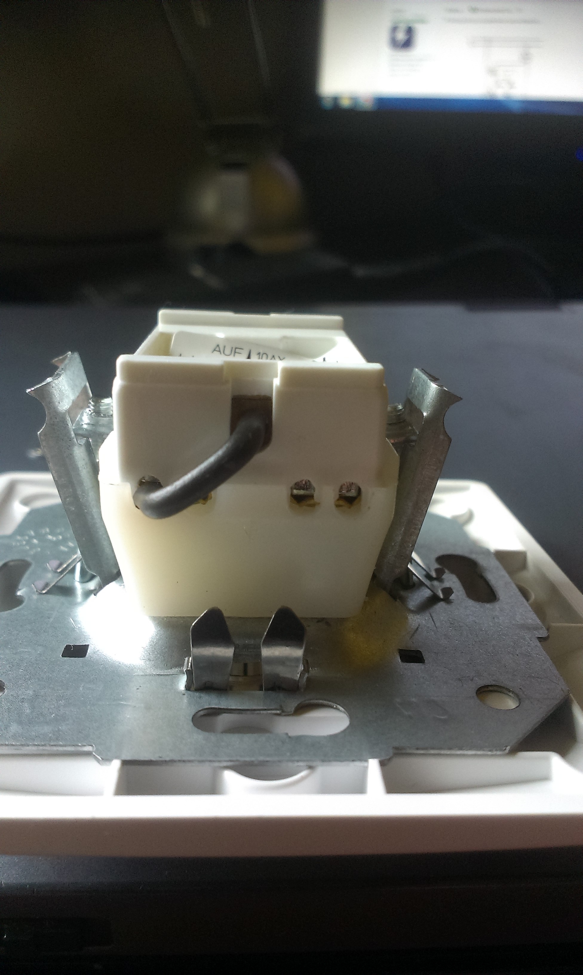

    and photos of cable connections from above (those on the left are empty, we won't connect anything there)

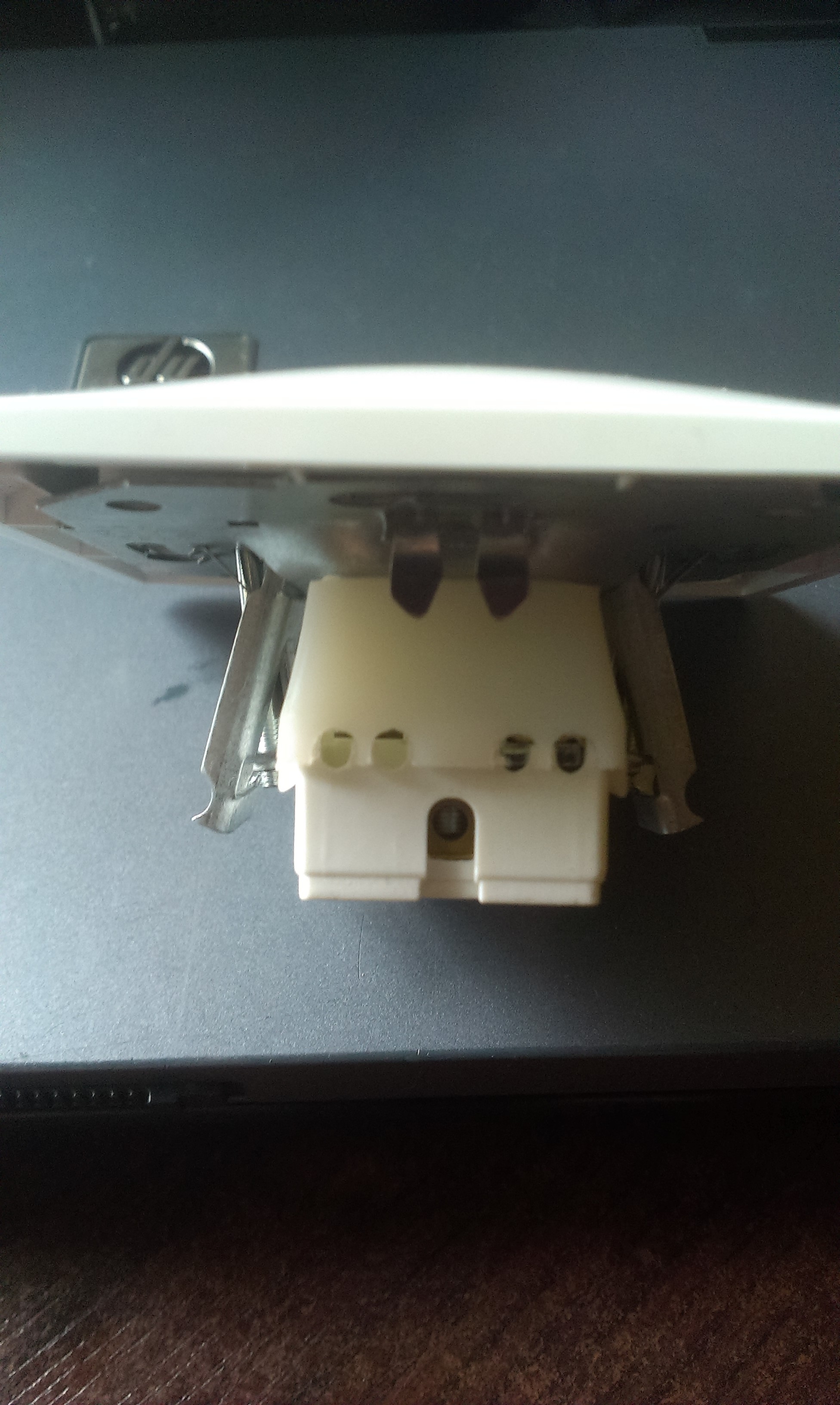

    and from below:

    Blue and yellow-green from the roller shutters, you connect the connection block, apart from the switch, with the appropriate wires from the power supply. You plug the phase into L, and the directional one in AUF and AB. If the operation is inconsistent with the markings of the switch flap - the black and brown wires must be swapped.
