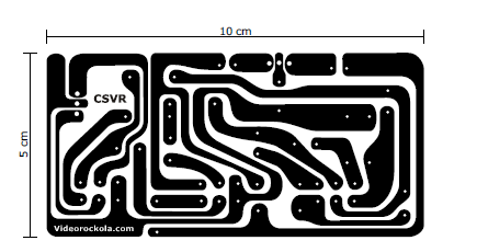

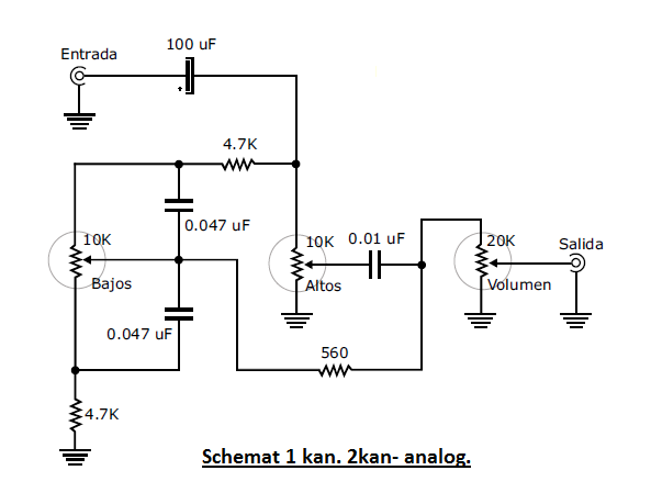

    I am looking for a simple design (diagram, board design, assembly instructions, list of elements) for making a simple passive stereo sound and volume control. I would most like to do something like this system called BTE-478, but nowhere can I find a design for such a system. Thank you in advance for your answer.

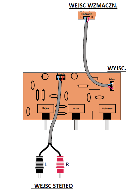

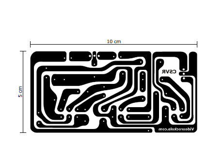

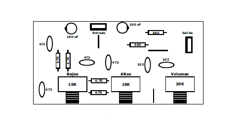

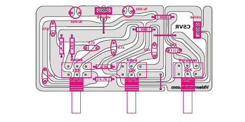

    Simple Passive Stereo Sound & Volume Control: BTE-478 Design, Diagram, Instructions, Elements Simple Passive Stereo Sound & Volume Control: BTE-478 Design, Diagram, Instructions, Elements Simple Passive Stereo Sound & Volume Control: BTE-478 Design, Diagram, Instructions, Elements Simple Passive Stereo Sound & Volume Control: BTE-478 Design, Diagram, Instructions, Elements Simple Passive Stereo Sound & Volume Control: BTE-478 Design, Diagram, Instructions, Elements Simple Passive Stereo Sound & Volume Control: BTE-478 Design, Diagram, Instructions, Elements

    Thank you very much, that's exactly what I meant.
